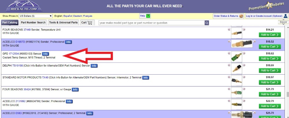

I'm wondering if that's a gauge sender. I found this item on RockAuto that seems to match your description:
I'm not saying you want to put a GPD sensor in your car. :silly: But that might get you pointed in the right direction.
The wiring diagrams are a little vague. The engine diagram only shows one ECT, and the instrumentation diagram shows a temp sender with only one wire.
As a fun test, you could measure voltage on both wires KOEO. Then, use a test light to short them together. If your coolant temp gauge now starts swinging hot, you know you're on the right track.

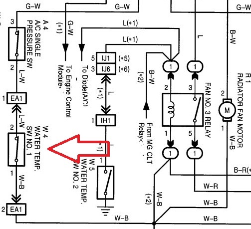

Dug around the wiring diagrams and found this:
Do the wire colors match? Blue/white and white/black.
Searching for a cooling fan switch takes you here on RockAuto:
www.rockauto.com/en/catalog/toyota,2000,...ator+fan+switch,4312

6 years 9 months ago - 6 years 9 months ago #36658
by popoften
Replied by popoften on topic 2000 Toyota Solara 3.0 Sensor question
Thanks guys. I ordered both the GPD from rock auto as well as a beck arnely from amazon. The GPD had threads that were too small despite what the description said. But the Beck Arnley from Amazon is perfect. Thanks all for your help!
