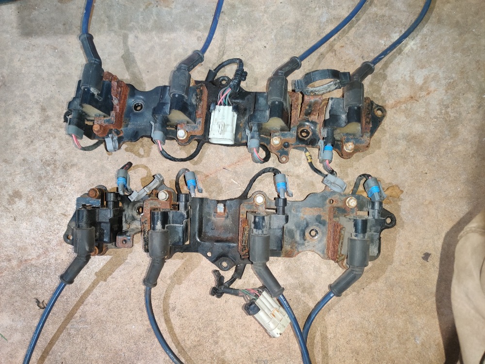

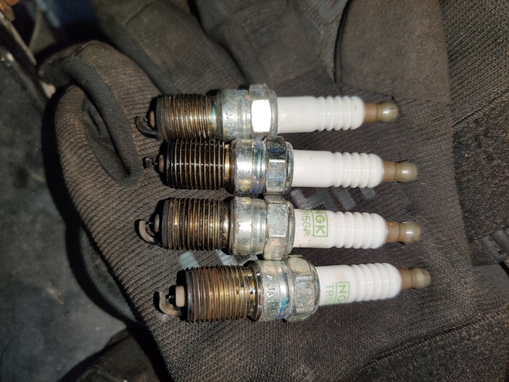

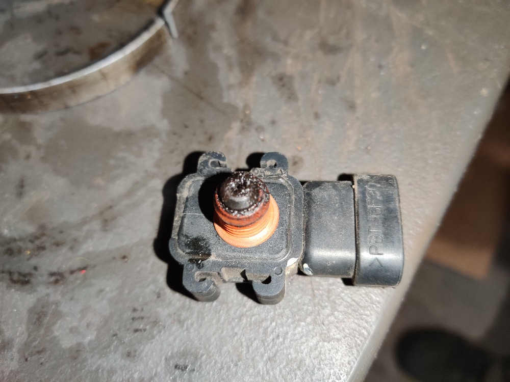

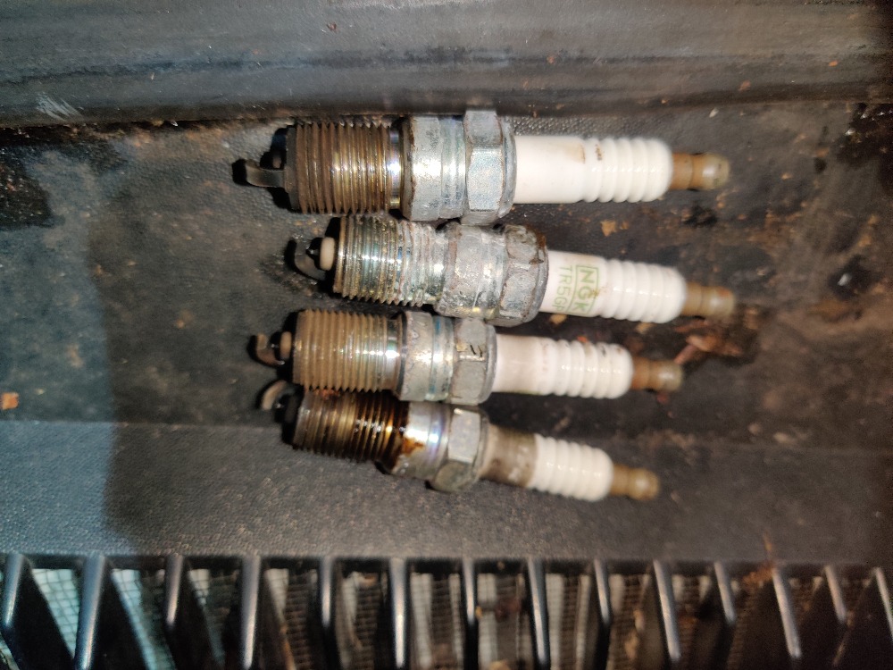

I have pictures of coil packs and Map.
Will be changing both because used parts are very available for next to nothing for me.
New plugs too. anybody have recommendation for what plugs in the 6.0

- Dothedew92
- Posts: 16
6 years 9 months ago #36261
by Dothedew92
Replied by Dothedew92 on topic PCV with no valve/ball? Gmc 6.0 2002 HIGH LTFT
Plugs, coils, Map.
