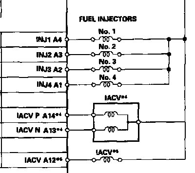

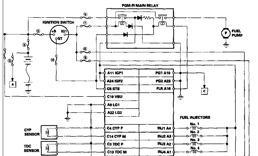

6 years 11 months ago - 6 years 11 months ago #35302 by Paul P.
Replied by Paul P. on topic 1997 honda Civic 1.6 (MT) Code P01509/P0505
Here's some wire diagrams for you, your power for the IAC also feeds the 4 Injectors.

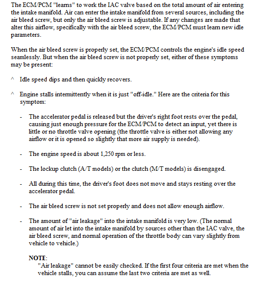

Scan Data shows the IAC counts from 0-45. This tells me that the PCM is Good and the IAC is moving in and out. What is not good is the 0 count value. According to Specification at idle,warm engine the IAC count should be 1 or 7., This can be adjusted by accessing the air bleed screw on the throttle body.
So from what I can gather the PCM set the P01509 because it didn't see a IAC value of 1 or 7 at idle.
But these IAC codes can also be caused from air leaks Vacuum leaks as well, and you end up chasing your tail.
Paul

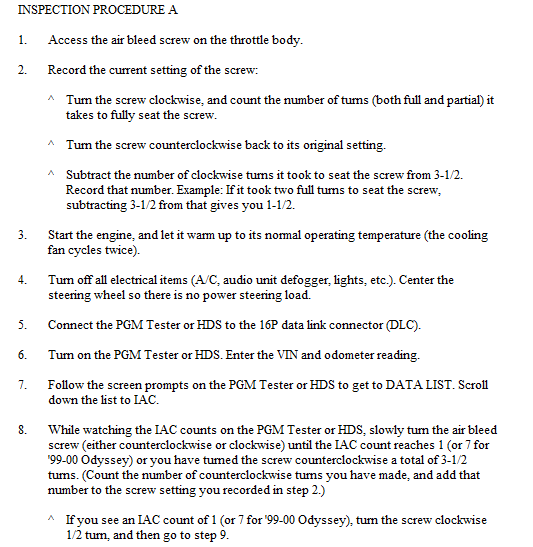

6 years 11 months ago - 6 years 11 months ago #35308 by Mechanic 350
Replied by Mechanic 350 on topic 1997 honda Civic 1.6 (MT) Code P01509/P0505

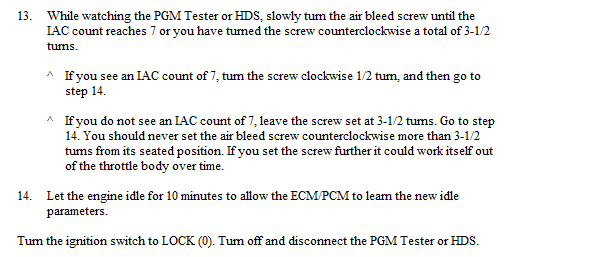

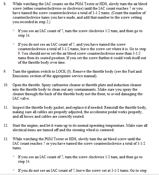

I am turning the screw trying to set it at 1, but it goes to 0 while engine is warmed up and at idle. it doesn't move until i press the throttle. i have moved this idle bleed screw before, but it never get any problems. yep, scan data still showing 0 volts. do i have a pcm or driver problem Weycraze?
Last edit: 6 years 11 months ago by Mechanic 350.
  • Mechanic 350
  • Mechanic 350's Avatar Topic Author

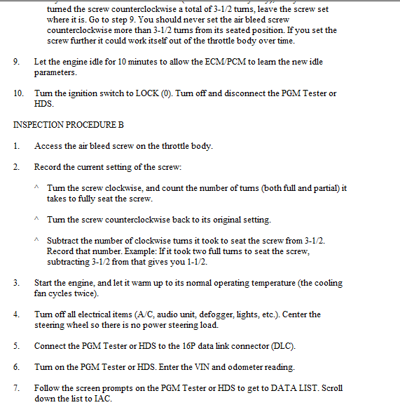

6 years 11 months ago - 6 years 11 months ago #35311 by Mechanic 350
By the way, i forgot to mention that when i turned the bleed screw clockwise, closing the valve all the way, the count remained at 0. there was no change until i hit the gas pedal. Also, when initial startup, the count goes way above 45. i've seen it to over 67 and then it gradually goes down as it warms up.

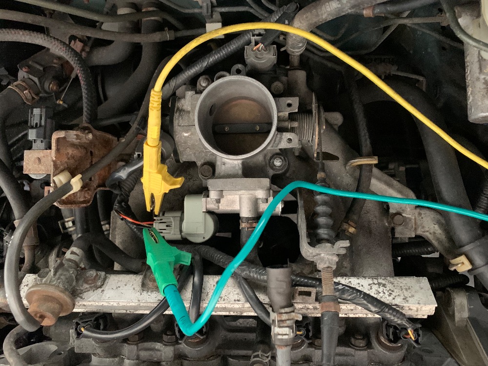

BYPASS TEST
Test light to ground
touching control wire (black/blue)
at the IAC VALVE
RESULTS=
Engine rpm increases with little bit of surging if you hold the jumper too long.
IAC COUNTS
at time of this test, 35 with no change in rpm. So when i touched the control wire
there was no change in counts.

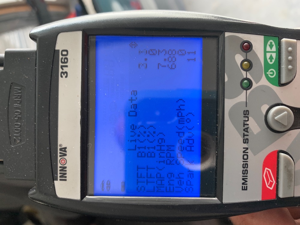

NOTE: Don't have ST/LF fuel trim on my old modes. Had to do it with another
scanner.
2nd bypass test= iac counts are at 0. touching wire counts went up to 22.
FUEL TRIM NUMBERS AT IDLE=
short term= 3.1
Long term = 0
RPM = 688
  • Mechanic 350

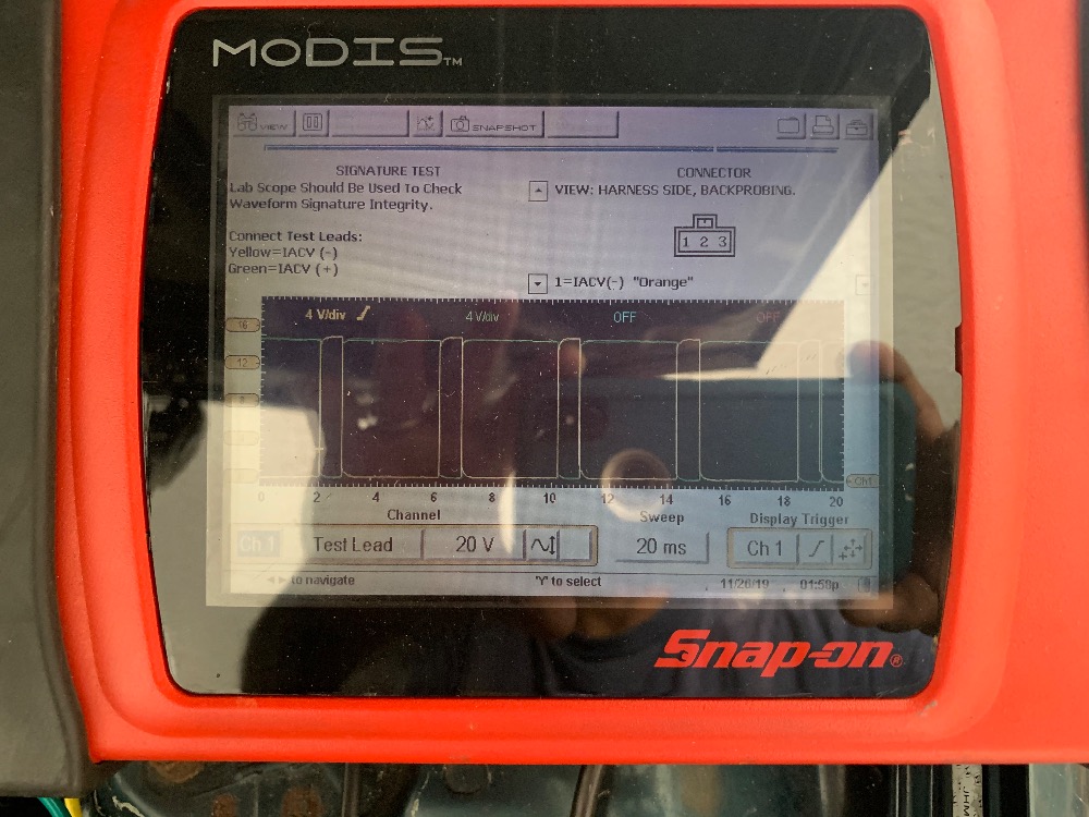

6 years 11 months ago #35346 by Mechanic 350
I performed a signature test according to the scope. Tell me what you think?
6 years 11 months ago #35349 by Paul P.

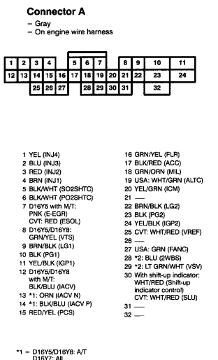

Ok, I should have been more clear,
There are 2 control wires correct? (they are the ORG and BLK/BLU)
The YEL/BLK is the B+.
One control wire will open the IAC, and one will close it.
"0" counts on scan data is a fully 'Closed' blocked off idle air.
"255" counts on scan data is a fully 'Open" idle air.
Some vehicles only show 0-50 on scan data, but you did have a 67 count, so I'll ASSUME (LOL) yours should show you 0-255!
So, you have previously stated you have seen the Counts rise and fall on scan data. ( PCM & Drivers Good)
The purpose of the by-pass test while plugged in is to move the valve fully open and fully closed by repeatedly tapping the control wire(S). And seeing the count reflect accordingly in scan data.
The highest you verified so far was a count of 67. IF, you can't repeatedly 'tap' the respective control wire to achieve more than this, it is very likely that the rotary valve is Sticking when it is trying to open. Try smartly tapping the valve itself while activating the control wire that opens the valve to see if you can get the counts higher than 67.
Cold Engine Start you should have high revs.
Snap throttle with warm engine should cause the counts to go high. ( valve fully open)
On a warm engine, every start should have a idle flare up, a quick high to normal idle, this indicated movement both directions of the valve.
If you prove your valve is 'Good', the next check is the TPS sensor minimum voltage level.
If TPS min voltage is too high, the PCM will 0 count the IAC at idle.
You may also have to disconnect the battery in between key cycles to 'reset' the PCM so it can 'Learn' new positions
Your fuel trims are low at idle, so I wouldn't suspect air leaks.
This is not at all technical by any means, but this is kinda looking like a stuck valve that won't fully open.
Never stop Learning.

2nd bypass test:
Black/blue control wire, idle increases when applying ground. Counts do not change.
Orange Control Wire:
idle decreases when ground is applied to it. no change in counts. At the time that
i performed this test, the scan data counts were at 42, slowly decreasing over time. Both control wires are responding. PCM is good. No leaks according the fuel trims.
But the counts on both wires are not moving when i apply a ground to both of them. One goes up and the other goes down.
i saw a count of 122 when the car was first started this morning. iac count now decreasing to 27.

From all your posts I would have to conclude you have a functioning IAC valve, both control drivers are operational (PCM is Good). However, the counts remain O at idle, and the hesitation from idle.
Have you cleaned the Throttle Body unit fully and the IAC port fully?
It's also very possible that your throttle plate is open too much at idle ( when it is at rest) this will also cause a low IAC count because the engine already has more air so it is closing the IAC. Also causes a little elevated RPM.
1. See if you can physically close the throttle plate a bit more, or physically start restricting the airflow to see if the PCM will respond with a positive count which indicates it is opening the valve for more air.
2. A voltage drop test on the power feed to the IAC is also in order.
Your TPS voltages seem relevant. One is the 5v reference, 0v is the reference ground, 0.5v is the reference signal. It's a 3 wire pot. Usually, 0.5-.9v is normal for the signal wire at idle.

Weycraze, I performed the following test:
circuit intergrity/control wire test:
KOEO
connector unplugged
transistor off (circuit off)
test light to B+
I touched both control wires and the test light both times. One brighter than the other. The black/blue control wire has 12+ volts. And the orange wire has 2.55v. why did my test light light when it wasn't suppose to?

Weycraze, also why am I seeing 2.56v on the orange control wire when I'm suppose to see 12 volts? Where is the voltage drop coming from? I went to the pcm unplugged it, and the volts shot up to system voltage. I'm totally lost dude.

I thoughly clean the throttle body. spotless. I also adjusted the rpm that I moved in the past and could never get it back to where it was, but I got it as close as I can. the rpm now is 680 to 720 rpm with no a/c on.
