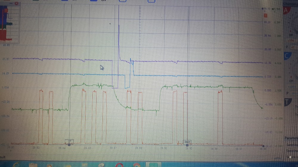

I attach wave form of cam and crank
Number one cylinder injector and coil
Chrysler 2008 5.7 130mil
It is not clear
Should ckp to bee sequre or it ok
It is not clear

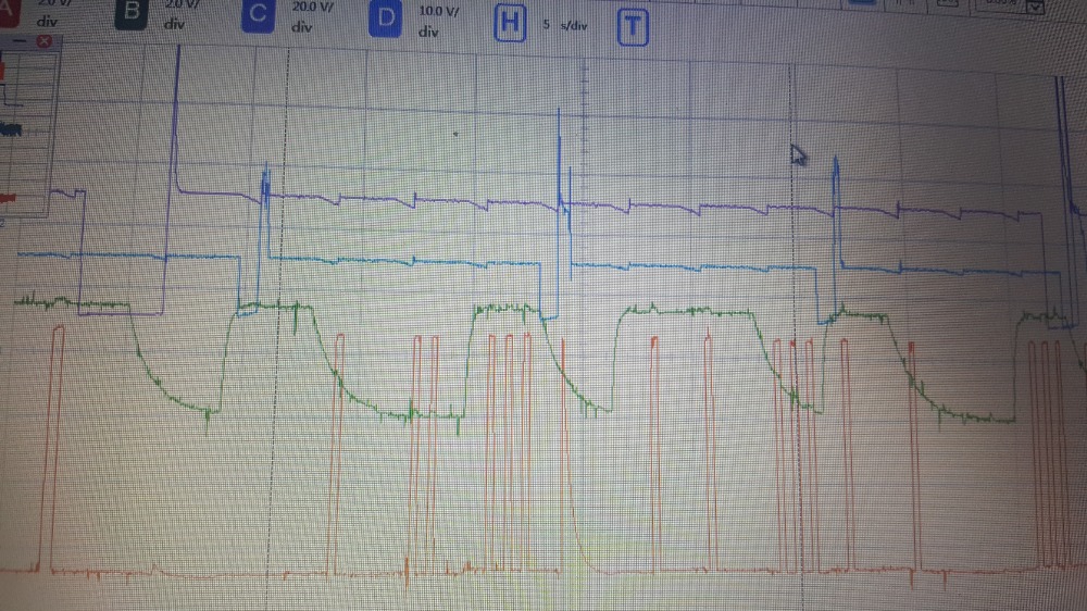

Any symptoms with the car running? If the green is the crank sensor that’s definitely not right. Maybe you weren’t making good contact back probing or piercing the wires. If you were I’d check the 5 volt ref and ground to it.

If those are your symptoms and you sure you got good scope connections at the crank sensor I’d say you are onto something with a waveform that’s looks that bad.

correct me if I'm wrong... the green is the cam and the orange is the crank. Green cam wave should be square. Orange crank should have four signals, picture indicates a misfire...

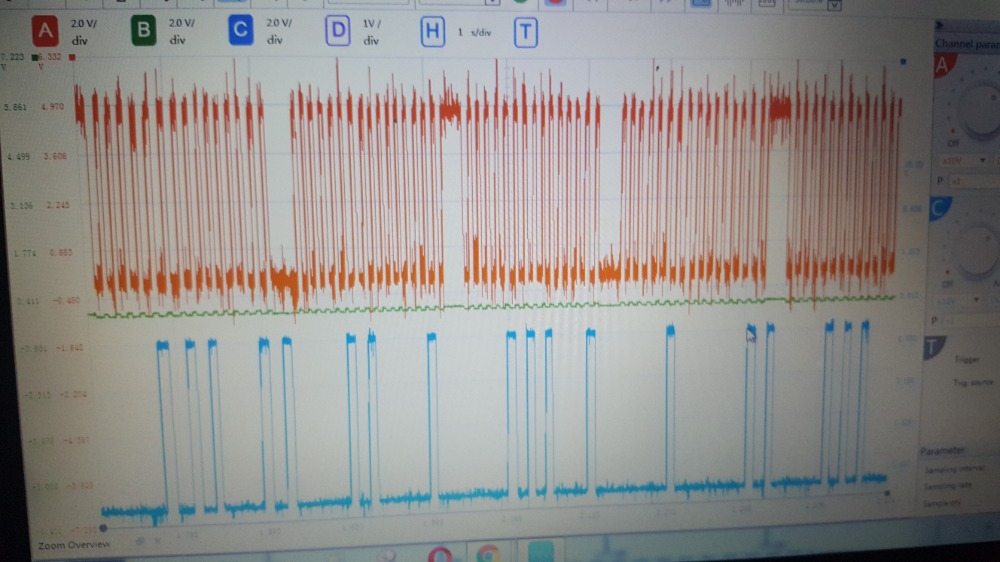

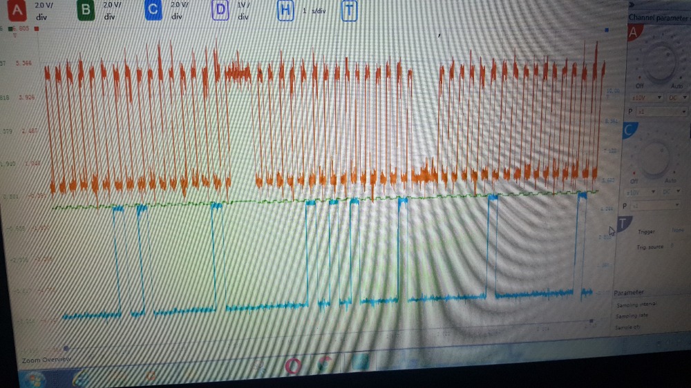

Attach new scan of cam and ckp
When car idle fine and not mis fire

should have steady groups of four... this is a misfire... trims probably show a lean condition... check the air gap in the crank sensor. Sensor maybe came loose and is moving or has moved.

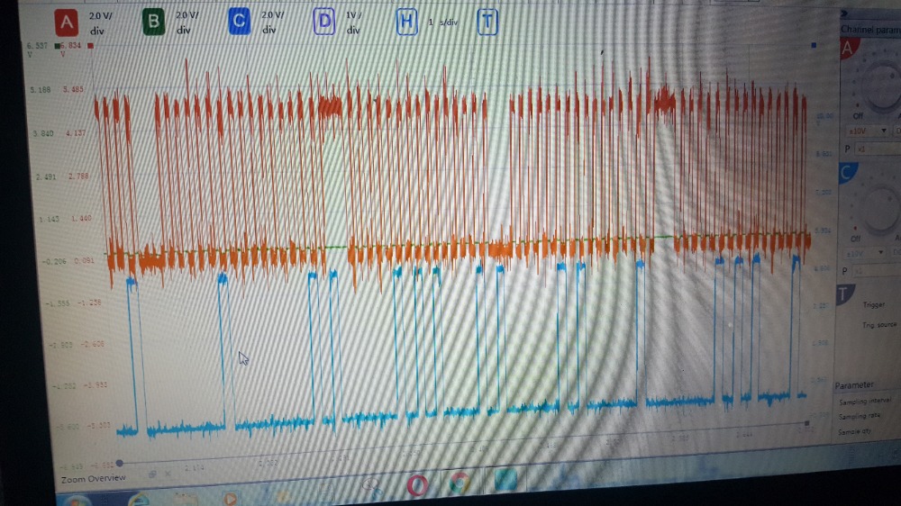

The blue is cam and orange is ckp

set scope to 10v and 100 milli sec for time... lets seen data again
