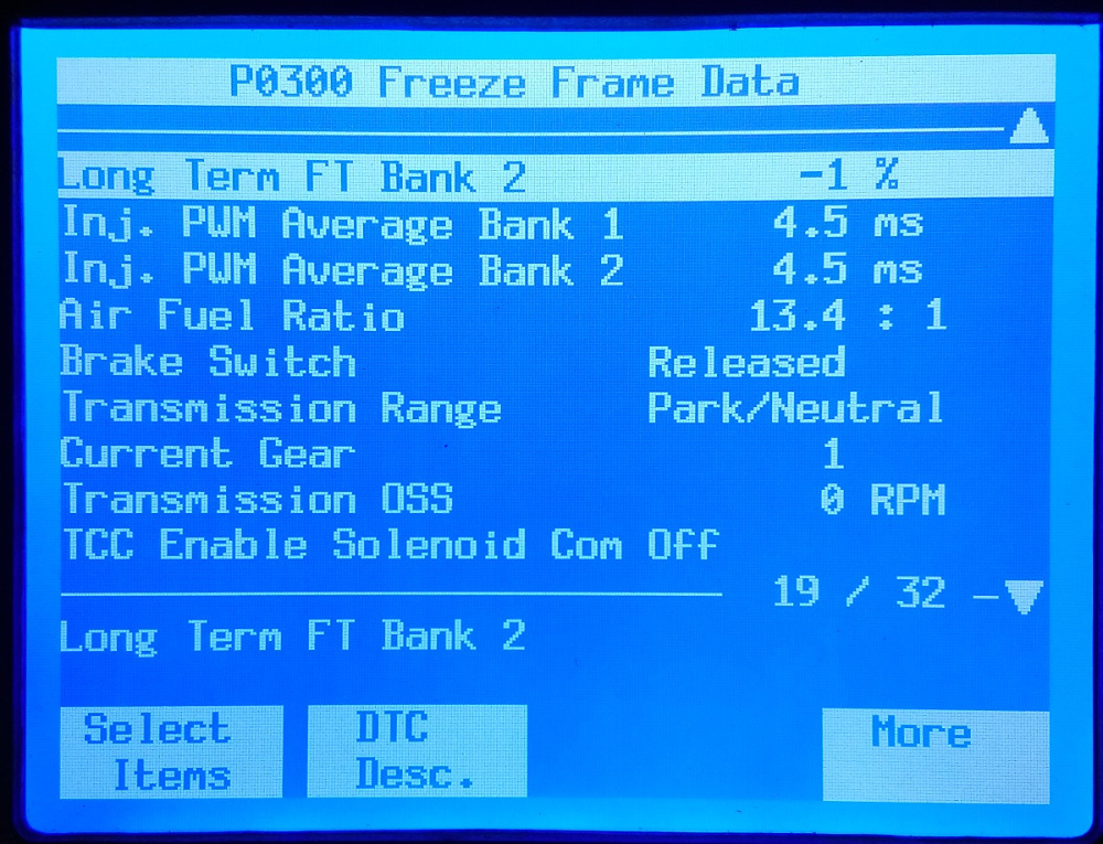

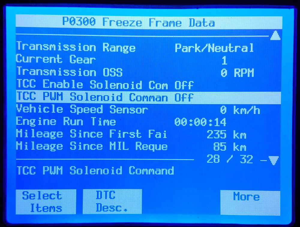

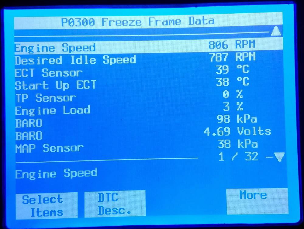

Hi all,
I've recently changed power steering fluid on my 2001 Tahoe and since then, I get cylinders 2 & 6 misfiring (right bank), and only those two. Firstly I thought I may have tampered the ground wiring from the battery, but I re-checked the closest ground location and cables and all seem fine. Ground wire is tightened good to the (-) terminal. The strange thing is that the misfires slowly disappear once during warm up and don't show at all on the warm engine in any driving condition - that should elimitate electrical issue (grounding)
This is what I've done so far:
  • Fuel Injector Balance test - all injectors were pulsing and showed identical pressure drop
  • Checked the spark using grounded spark tester on #2, #4, #6 - all showed good and consistent spark
  • Swapped coil from #2 to #5 (the easiest to reach) - no change (2 & 6 still misfiring)
  • Swapped wire and plug from #2 to #5 - no change (2 & 6 still misfiring)
  • Checked both bank O2 sensors using live plot - each one starts pulsing normally shortly after start
  • Tested the right side of the intake for vaccuum leaks using water spray - no effect
  • Checked vaccuum hoses
  • CKP variation relearn
  • Cylinder Powe Balance test - hard to read from Tech2, but the RPM-drop numbers seemed very similar
I didn't check for blocked exhaust, but that's very unlikely to have happened as the problem appeared all of sudden. The engine really misfires as it shakes a little on a cold start.
Here are freeze frame data for a typical P0300 occurence. Sometimes the CEL is even flashing, but other times it just lights up. Probably depends on the engine temperature.
I hope I didn't miss anything in the write up but will be thankful for any hint!

7 years 1 week ago #34302 by Tutti57
Replied by Tutti57 on topic One bank misfiring on 2001 Tahoe 5.3 LM7
What are your short and long term fuel trims on bank 1 and 2?

7 years 1 week ago #34317 by VegasJAK
Replied by VegasJAK on topic One bank misfiring on 2001 Tahoe 5.3 LM7
your engine is in open loop... did not see engine temp. provide LTFT for both banks with engine at operating temp and in closed loop. bank specific codes will not be a vacuum leak.

7 years 1 week ago #34339 by JohnnyCZ
Replied by JohnnyCZ on topic One bank misfiring on 2001 Tahoe 5.3 LM7
Tutti57 wrote: What are your short and long term fuel trims on bank 1 and 2?
When in closed loop, they're pretty good - STFT is always around 0% (when idling), LTFT is -1% for bank 1, -2% for bank 2. I may take some live plot of those if desired.

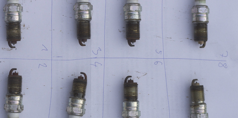

7 years 28 minutes ago - 7 years 27 minutes ago #34573 by JohnnyCZ
Here are the spark plugs, not the best pics but I tried my best :-)
Keeep in mind that they're burning LPG (propane), so reddish coloration is normal. From what I can tell, they all look almost identical, except #7 and #8 looking way different, maybe too lean. I know this was common in o'le Chevy SBCs, but with sequential fuel injection in an LS Vortec, it looks a bit strange or at least interesting.
