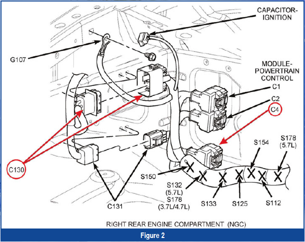

I am studying this , and reading for days now, because I got this error code and put me in limp mode. To replace the TIPM, or TCM imo would fix the problem, but i want to do this procedure posted below.. My question is Anyone knows ( because that procedure made for a 4L chrysler) if is the same for my vehicle? I already pulled out the Relay to check it, and the fuses, so the next step to measure if TCM getting the right voltages or not from the TIPM.

Diagnosing Code P0882
Let’s look at the basic checks to determine the cause of this code (figure 1). We’ll be using wiring and computer information for a 2007 Dodge Dakota 4.7L with the 545RFE automatic transmission. While these checks are going to be virtually identical across the different models and engine sizes, always refer to the appropriate wiring schematic for the vehicle you’re working on.
To begin checking:
Step 1 — Clear the code and take vehicle for a road test to see if code returns. If code returns, proceed to step 2. If code doesn’t return during the road test, proceed to step 5.
Step 2 — With the vehicle in park and the key off, disconnect the C4 connector from the PCM (figure 2).
Step 3 — Connect a jumper lead with a 10-amp fuse from the battery positive cable to terminal 18 (Yellow/ Dk Blue wire) in the C4 connector (figure 3). Applying system voltage to terminal 18 should close and energize the transmission control relay.
Step 4 — Check for voltage at terminals 19, 28, 38 (Yellow/Orange wire) of the PCM C4 (Black/Green) connector and terminal 10 (Yellow/ Orange wire) of the transmission harness connector (figure 4). Each should have system voltage from the battery through the relay inside the TIPM.
When checking the voltage at the PCM and transmission, have a helper wiggle the wiring harness in several locations and make sure there’s no voltage loss at any of the terminals (figure 4, page 12). The measured voltage at each terminal must be exactly system voltage.

If voltage isn’t the same, check these terminals (figure 5):
• Terminal 10 of the C1 connector at the TIPM
• Terminal 9 of the C10 connector at the TIPM
• Terminals 20 and 16 at the C130 junction connector
• Ground wires at terminal 12, 13, and 14 of the C4 connector at the PCM
The ground wires must have less than 0.05 volts. If the ground voltage is greater than 0.05 volts, repair the ground or splice and run a new wire from the PCM to a good chassis ground.
If the voltage checks are all correct and the code still sets, it’s likely caused by a PCM failure.
