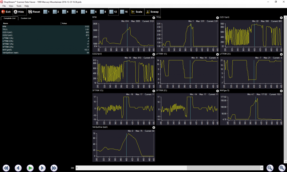

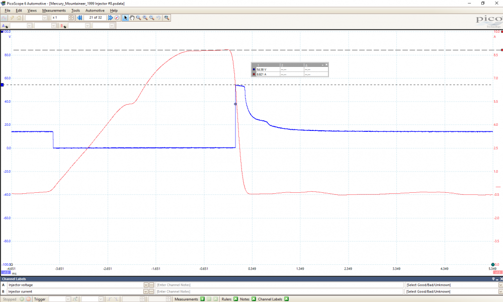

Sorry for late reply. Been busy. Here is the snapshot of test drive concerning WOT and O2. i took voltage and current injector waveforms done at the ECM since they were below the intake. All eight injectors averaged between 8 - 8.9 amps and the waveforms look exactly like this snapshot posted.
There was a small vacuum leak that I found when spraying water. I can hear it get sucked in. It was located at the hose at the back of the intake along bank 2 side. Put a clamp on it but LTFT B1 26 and B2 30 only went down 19 & 25 and on some days 15 & 19.
Did a cold intake smoke test in the morning and no smoke was showing. Next is to check the PCV system. Even though I don't have a misfire I'm going to check for internal leaks. I'll update as soon as I have the results.

9 years 9 months ago #4751 by Tyler
Replied by Tyler on topic Oil cap causing lean conditions?
No intake leak, then :( And your WOT run confirms that the fuel system can provide enough at high load to keep the engine rich.
