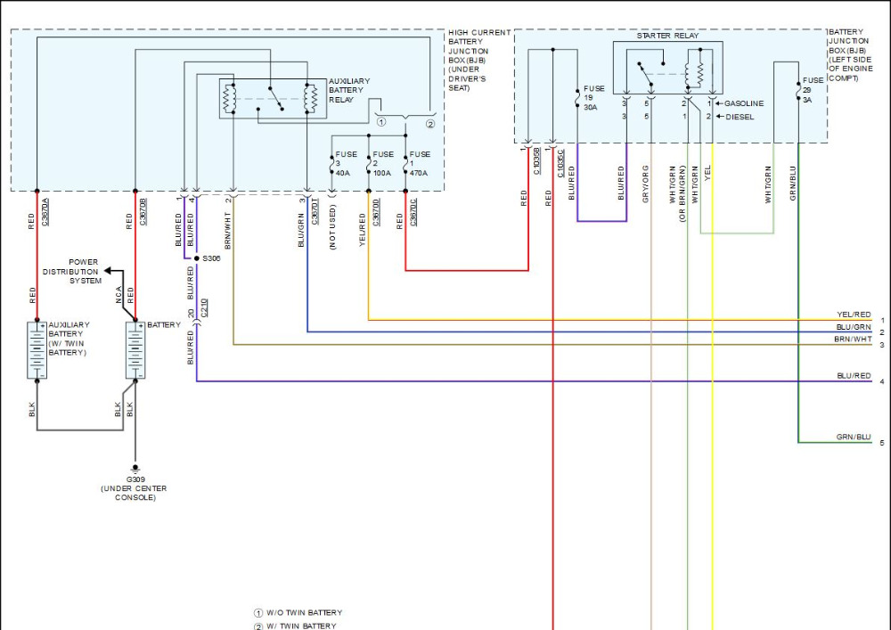

7 years 4 months ago #30117 by Tyler
Replied by Tyler on topic FORD TRANSIT 2015 T-250 - No Crank/ Start

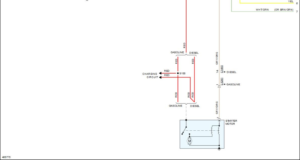

Is this a bus conversion van? Depending on the company, they'll sometimes wire the door switches into the starter circuit. So the driver can't take off with the doors open. ;) :lol:
If that circuit was damaged during the hit, that'd explain the code and the lack of cranking. I'd start with voltage checks at the starter relay, specifically at pin #1 and 2 for the control side. KOEO and KOEC. Missing power or ground will enable you to pick a direction to go, AND allow bypass testing to verify starter function.

  • cheryl hartkorn
  • cheryl hartkorn's Avatar
7 years 4 months ago #30123 by cheryl hartkorn
Replied by cheryl hartkorn on topic FORD TRANSIT 2015 T-250 - No Crank/ Start
also try jumping the relay to see if the load side and starter engine block/body groounds are good. im assuming they would be. and the issue is on the control side.

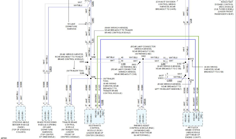

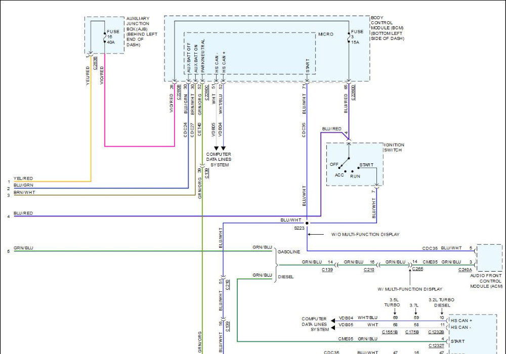

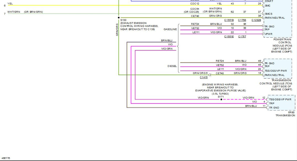

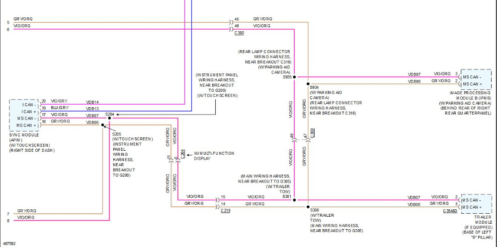

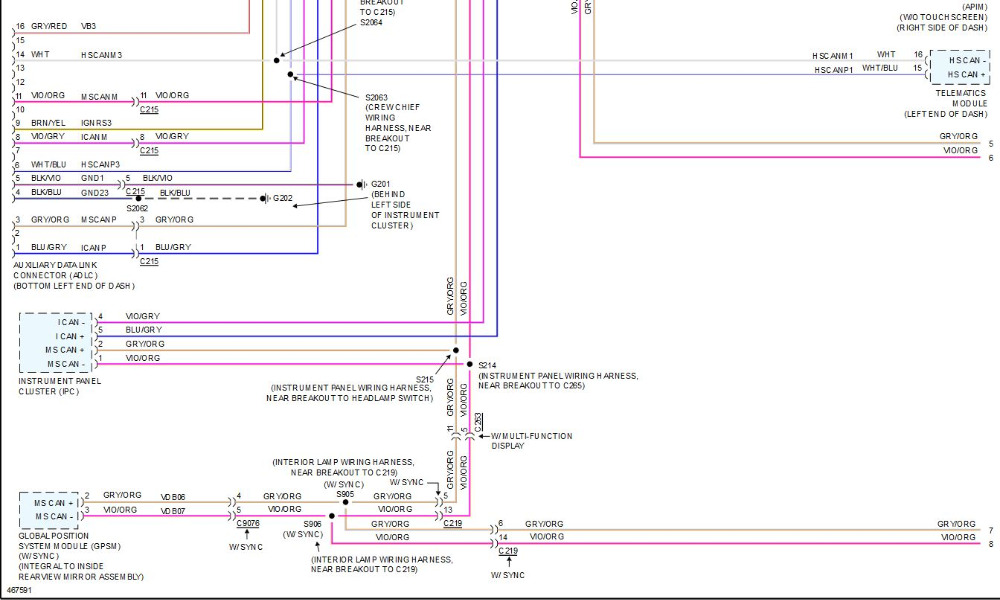

I also thank the poster of the diagram above, it means much to me for this check up and will take the time to cross check the starter relay as said by one poster and will update the thread.

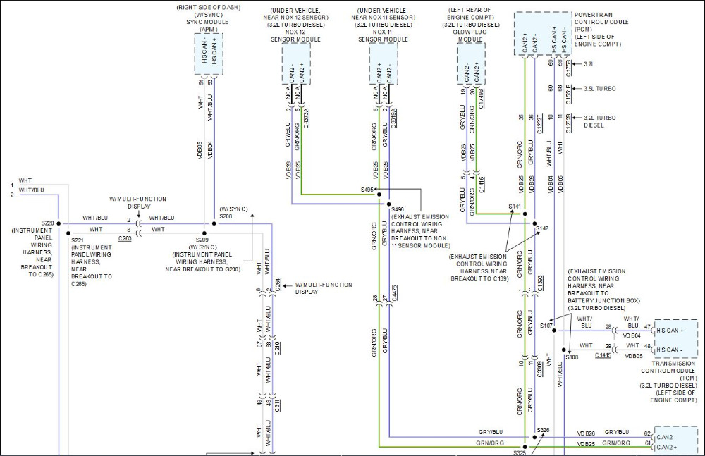

I also need the CAN wiring diagram info. Because I am suspecting May be some CAN might have been damaged during the hit at the back tail door, below,
Once more time thanks for the various input, kudos to all that has put in much to make this a little easier in checking...

7 years 4 months ago #30136 by Chad

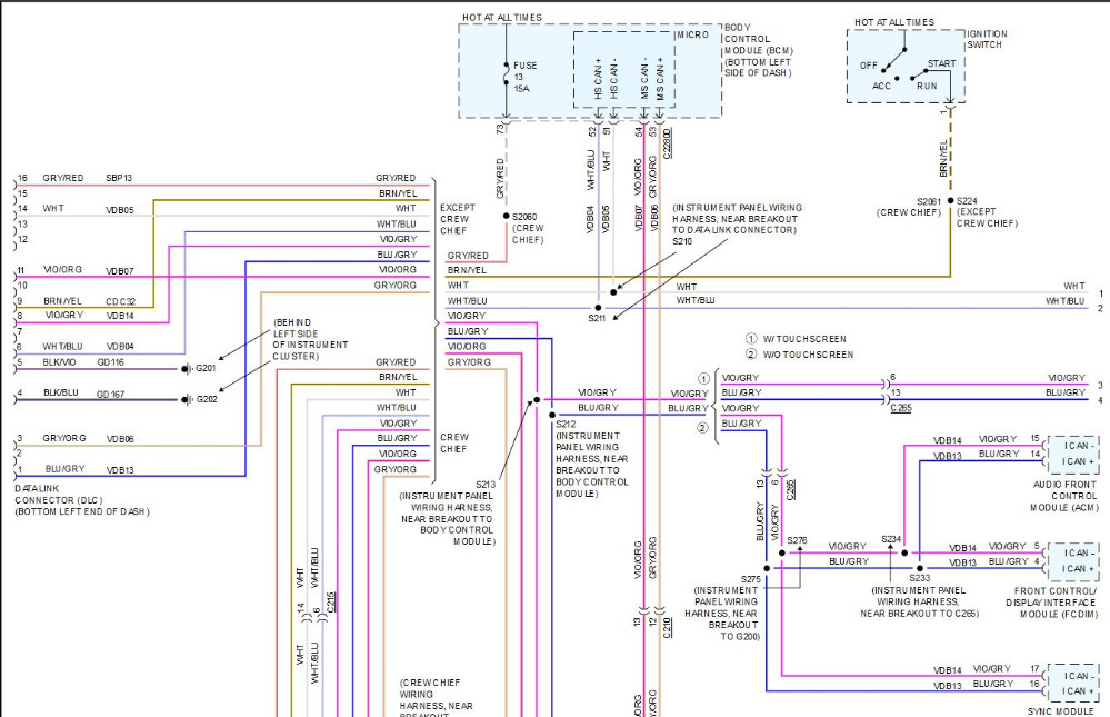

7 years 4 months ago #30152 by Tyler
forumoto wrote: So if you said could be door switch, can you through more light into how that door switch work here and any diagram will also explain.
Not specifically, unfortunately. :( How the coach builder wires their circuits into the Ford harness is up to them. Getting wiring information is often a uphill battle. I CAN tell you that most of the starter inhibit systems I've seen also come with some kind of status board on the dash. As in, a set of labeled LED's that correspond to the various doors, to let the driver know why the engine won't start.
Not all conversions inhibit starting, either. :silly: So I'd suggest keeping it simple with the relay testing first. Power to the control side comes from the Audio Front Control Module, ground comes from the BCM.
