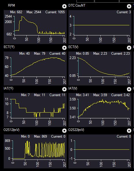

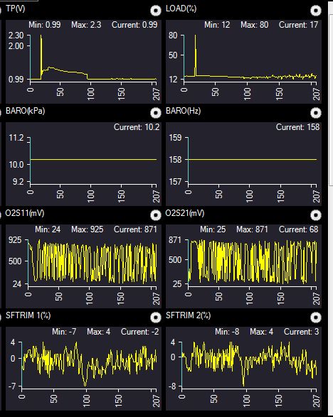

1997 Mazda B4000 4x4 4.0 engine. I have only once code and it is the dtfe. I have already replaced this and the mil light went out and has not been back on. I may be looking at old codes. I am using a Snap on Modis with 9.4 software. and........... I am a rookie diy guy.
Why would the trims be so high on both? 02 sensors are on zero.
THE CATALYTIC CONVERTER HAS BEEN REPLACED WITH A STRAIGHT PIPE AND A BUNG WELDED TO PUT THE 02 SENSOR BACK WHERE IT WAS

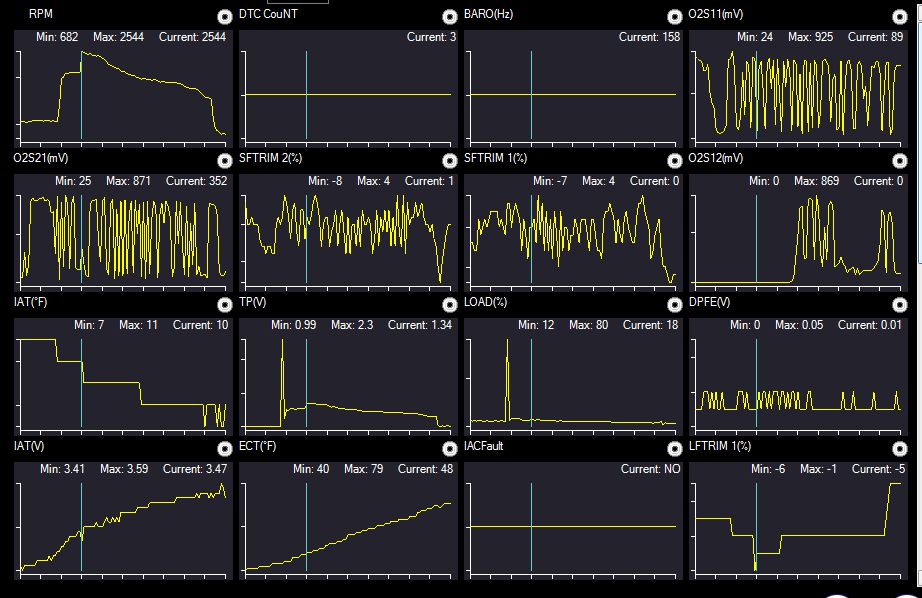

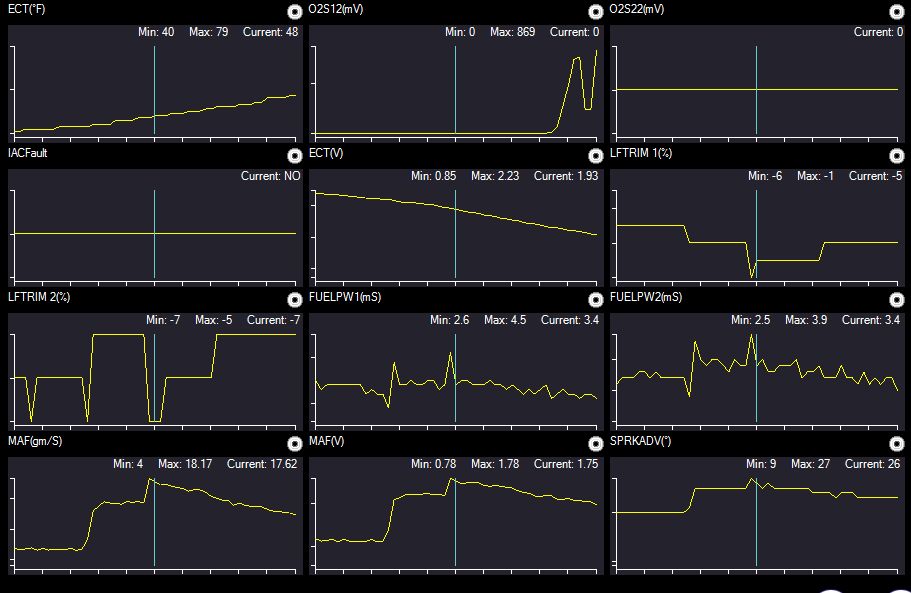

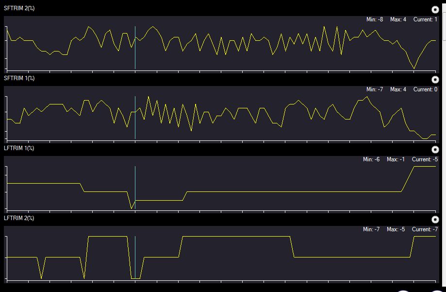

I was having trouble reading my truck on the two scanners that I have. I went into global and watched the data and it showed proper trims. so that is progress.
that information is helpful! I had put a low thermostat in it and like a dummy thought that was a good idea. I will put the higher one it like is supposed to be. then see what that shows. I am going to try to attach some files on this to see if you can view them in shopstream connect.

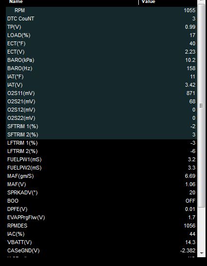

A few catch my eye. Between the MILFault and the DTC CouNT PID, your truck is pretty convinced there's some kind of problem. :silly: One of those codes is likely a P1000.
There'll also be at least one P04XX code for the DPFE sensor. Stuck at 0V. I see you replaced it, but this PID still isn't happy.
The last thing of note is the CASeGND PID. I've observed this PID across hundreds of Fords, and I've never seen it actually read something. :blink: Every one I've seen reads -.017V or close to it.
Don't panic or anything, 'cause I've also never seen any diagnostics or training information refer to this PID. I'm just genuinely excited to have an example of that PID actually working! :woohoo:
