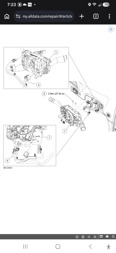

So i have a 2013 ford edge v6 that keeps throwing steering angle sensor codes once in a blue moon turning off my trac control and stabili trac it goes away on its own after a while but for the life of me i cannot find a wiring diagram for this sensor nor can i find one for the steering column control module am i missing something here? I appriciate any insight thank you
there are these codes inside the PCM P193C 00-6C.  ABS C1B00 64-68 Steering column control module U2101 00-0A

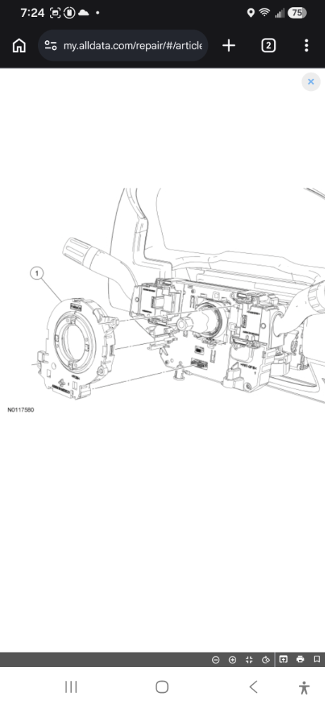

I would advise purchasing service information for this vehicle, you can have a few days access direct from Ford for under $50, or All Data DIY, there are lots of providers. Service info is not optional.
The steering angle sensor is integral to the spiral wound cable and the SCCM is integral to the switch pack.
Either part is a pretty high failure component.
