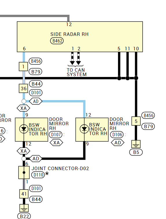

I feel like I've lost braincells trying to wrap my head around this.
2021 Nissan Rogue SL 4WD (*With automatic drive positioner)
RH BSI indicator (in the mirror) inop.
DTC: U1B46:15
I've attached of the DTC diag procedure from alldata along with a screenshot of the wiring diagram.
Procedure #3 : I must be missing something because the wire in question is isolated with D106 and B462 disconnected. there literally no way it can have continuity to ground.
this is from alldata but Im purchasing nissan techinfo tomorrow to see if alldata missed something.
I have pinpointed the cause of the DTC, i removed the mirror assy and plugged it in so i can manipulate it . Turned on ignition and the rh bsm indicator stays on but is lightly flickering.I wiggle tested the wile harness and even the wires inside he mirror going to the led contacts with no change. . however when i simply turn over or shake the entire assy. the light turns off and bsm works. I'm gonna see if we have the old one to verify the assembly is bad.

I can see the confusion here. For 107 pin 12 is ground and for 106 pin 9 is ground. This is where Scanner Danner says "use the trouble tree as a guide".
Forget the instructions and just think about what they have you testing. First, is any wire stuck at power? No? Keep looking.
Next, does the ground circuit have continuity to ground? Yes? Keep looking.
You can take it a step further and load test the ground circuit with a test light connected to power. If you have an LED handy, you can determine the polarity and jump it into the circuit and see if the code clears.
