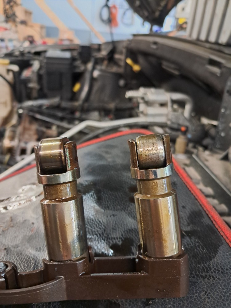

I'm sure we've all been down this path with this engine platform and can make an educated guess as to where this going. Surprisingly, relative compression and in cylinder testing didn't reveal much, but with the odd numbered bank valve cover removed, it's obvious the #3 intake valve is not actuating.

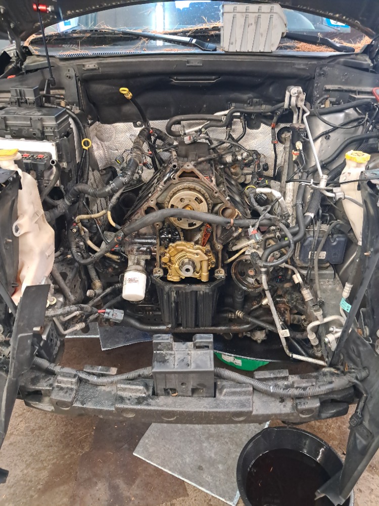

The customer elected to go ahead with engine repairs and we ordered from the dealer OEM lifters, head gaskets, head bolts and a camshaft.
Like most of you I'm sure, I am no stranger to this job. However, when I started the engine it ran VERY poorly! Clanging, misfiring , loading up the cat. It was bad...

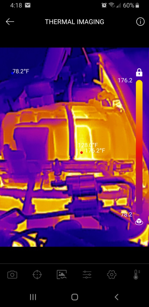

I noticed the intake runner for cylinder #5 was too hot to touch.

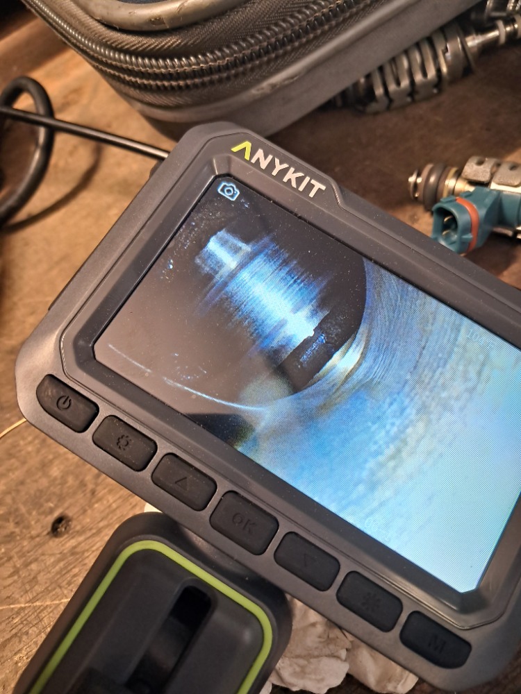

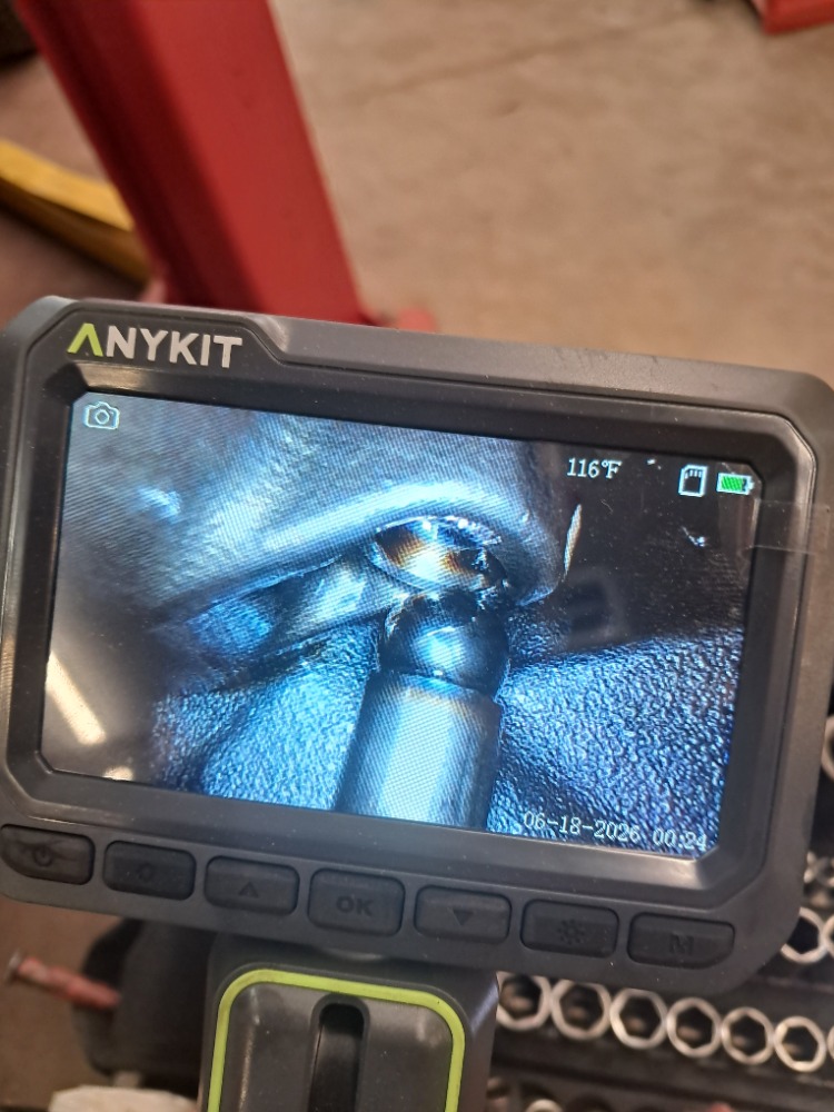

First thing this morning I pulled a spark plug on #5 and put my boroscope in the cylinder. As luck would have it, the piston was at the bottom of the power stroke. No marks on the piston. Flipped the camera up to inspect the valves, fully seated.
Then I began to inspect the rocker arms and found where I had gone wrong. The intake pushrod was not seated in the rocker arm cup, so the edge of the rocker was actuating the pushrod, adding to the stroke and duration of the intake valve, creating overlap which allowed exhaust and combustion gasses to enter the intake manifold.
This not only caused a single cylinder misfire, but the speed density system saw the decreased vacuum as load and over fueled the engine.
Thankfully I was able to loosen the rocker train, reseat the push rod and re torque the rocker train. The engine then ran perfectly, much to my relief!
