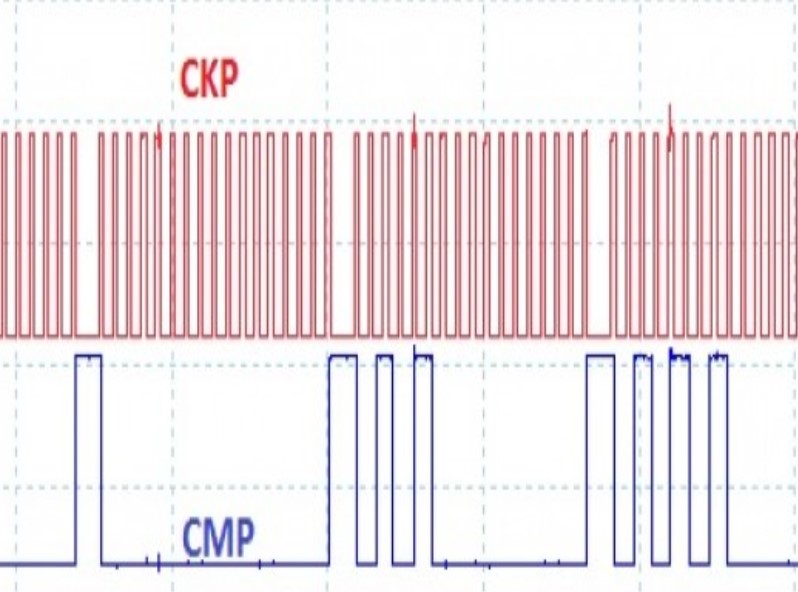

Interestingly I just realized that my CKP waveform has 17 peaks when all the waveforms on the forum for the same make model vehicle have 16. Can anyone shed light on this?
Regards
Francis

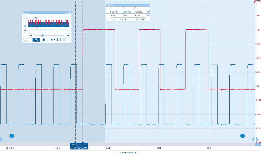

Nissan_Almera_2001_Gas_20260602-0002_PA3246.psdata
Hi Chad, Here's the CKP/CMP waveform.
Regards
Francis
4 months 2 weeks ago #93010 by Chad
Replied by Chad on topic 2001 Nissan Almera P0335
I believe the difference is the engine size. You, probably, have the 1.5L. Here, is a link to a 1.5L KG:
rotkee.com/en/wavebase/good-timing-ckp-c...Yjh8ZI8D7CN8AWmlspbC
I believe the 1.8L has 16 teeth.
4 months 2 weeks ago - 4 months 2 weeks ago #93011 by Chad
It looks, to me, like the wide finger of the Cam should straddle the Sync-notch of the crank.
Your Cam is 4° retarded.
The wheel of the Crank is 36-2 teeth. Each tooth of the crank signal is 10°
I don't know how tight Nissan specifications are but, I have never seen 4° cause an instant code.
Does this vehicle have a Cam/Crank relearn routine in the PCM?
Last edit: 4 months 2 weeks ago by Chad.
