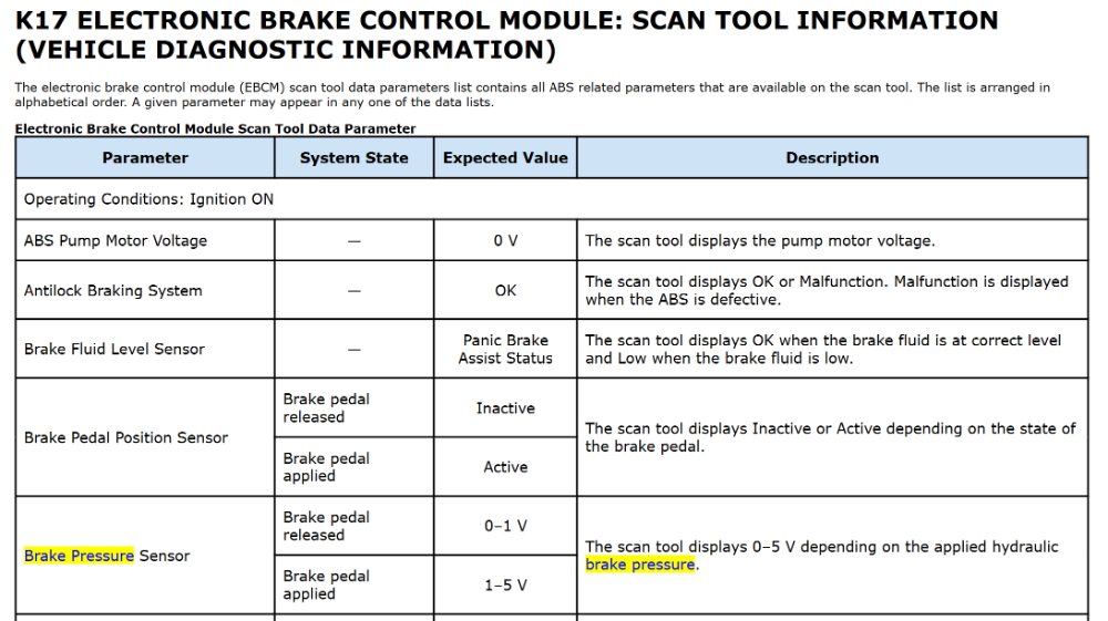

Sorry for taking so long to reply. So there's no data on the scan tool for brake system pressure and i don't have any gauges to hook up to the caliper to check it manually but im guessing that's my best bet. I guess ill have to get some.
No offense meant, but you're certain there's no brake pressure sensor PID in the EBCM? Service info says there is, but that wouldn't be the first time SI lied.
Anyway, you don't necessarily need that PID, it's just more convenient.

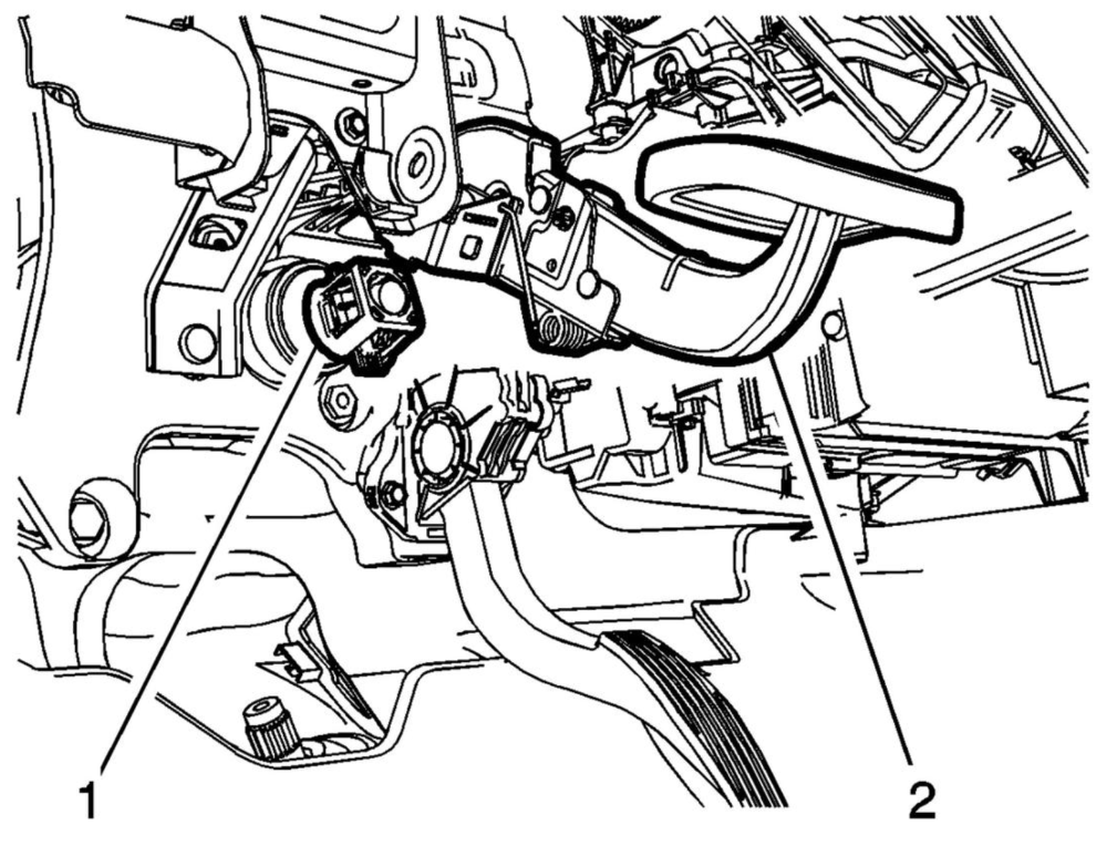

Digging around in SI, I found this step in the brake booster removal procedure:
lemon-manuals.la/Chevrolet/2020/Trax%20L...Removal%20Procedure/
"Compress the tabs on the top and bottom of the brake booster pushrod retainer (1) and lift the brake pedal (2) rearward to disconnect the brake pedal from the power brake booster pushrod."
In other words, the brake pedal doesn't have a physical stop, it's determined by the brake booster. Something to keep in mind.

None taken my friend. I meant there’s no actual system pressure pid that displays system pressure in psi. My thoughts were even if the pedals released it may have residual system pressure even if it’s not displaying voltage. I did reference that in the original post saying I’m showing .49v with pedal released and it does go up with pedal application and back down to .49 when released. Spec from SI is 0-1 normal release and 1-5 when applied.
So I had time to do some testing. I back probed the pedal apply wire and am getting 1.19v with brake released. More when applied And when I pull up on pedal or drops to 1v or slightly below. When Hsa is engaged it holds the brakes at the 1.19v and releases when pedal is pulled up to get it down to 1v. releases right when it hits 1v.
