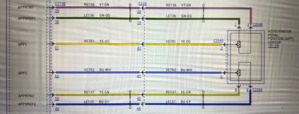

6 months 2 weeks ago - 6 months 2 weeks ago #92844 by Mgh
Hello everyone,Scratching my head here as I am trying to figure out an Accelerator Pedal Sensor issue on a 2017 Ford Transit 3.7L.
DTC P2122. Actual problem: reading battery voltage at one of the 2 sensors' ref wires.
Sensor 2:
APPVREF2 -> 5v when the car is running.
APPRTN2 -> tests fine when measured with the positive lead connected to power.
APP2 -> Signal reading changes when pushing the pedal
Sensor 1:
APPVREF1 -> 12v or ~14 when the car is running.
APPRTN1 -> tests fine
APP1 -> No signal when pushing the pedal
DTC is related to Sensor 1.
The above readings are consistent whether the connector at the pedal is plugged/unplugged.
I inspected the wires, everything looks clean, no corrosion from end to end. There is an intermediate connector, which I unplugged and inspected, looks good.I swapped 5v ref wires, the DTC went to Sensor 2, and the signal was working as I pressed on the pedal in sensor 1.There was a PCM lying around that I swapped, same battery voltage at the ref.
If disconnect the PCM, the battery voltage and 5v ref disappear. Same when I disconnect the connector, which I think supplies grounds and powers.Looks like I have short to power, and to me, everything is pointing to the PCM; but what are the chances of the other PCM having the same issue?
 Any help would be appreciated, thank you!

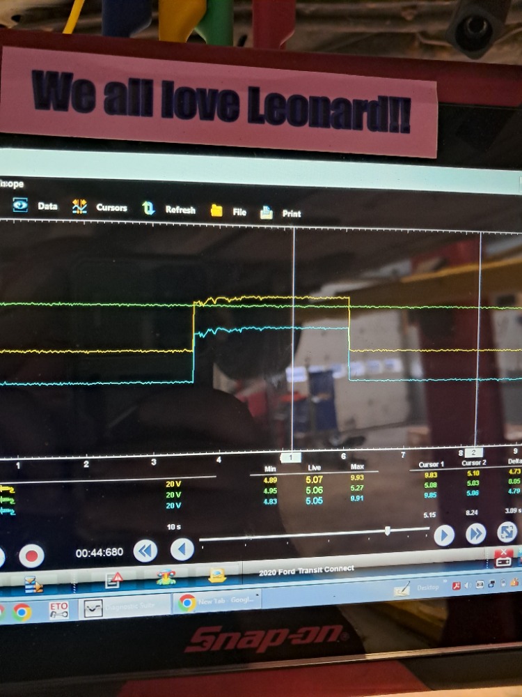

With my scope attached as follows:
Ch1 yellow app1 5v ref
Ch2 green battery current sensor 5v ref
Ch3 fuel tank pressure 5v ref
Manipulating the area where the harness is rubbed through, app1 5v ref goes to 9v and the 5v ref circuit code resets.

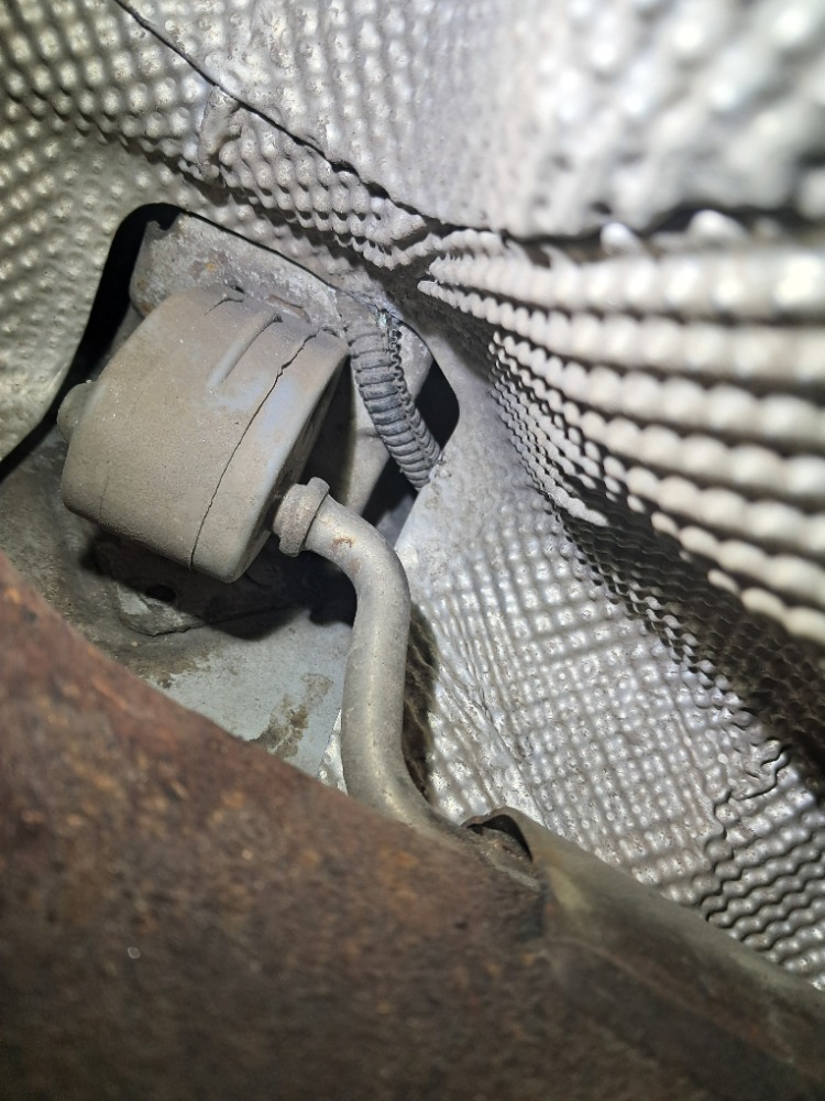

6 months 1 week ago #92858 by Noah
Maybe you can pull the fuse for the bent valve and see if the 5v ref returns to normal? Then you'll know if you need to got to that end of the van

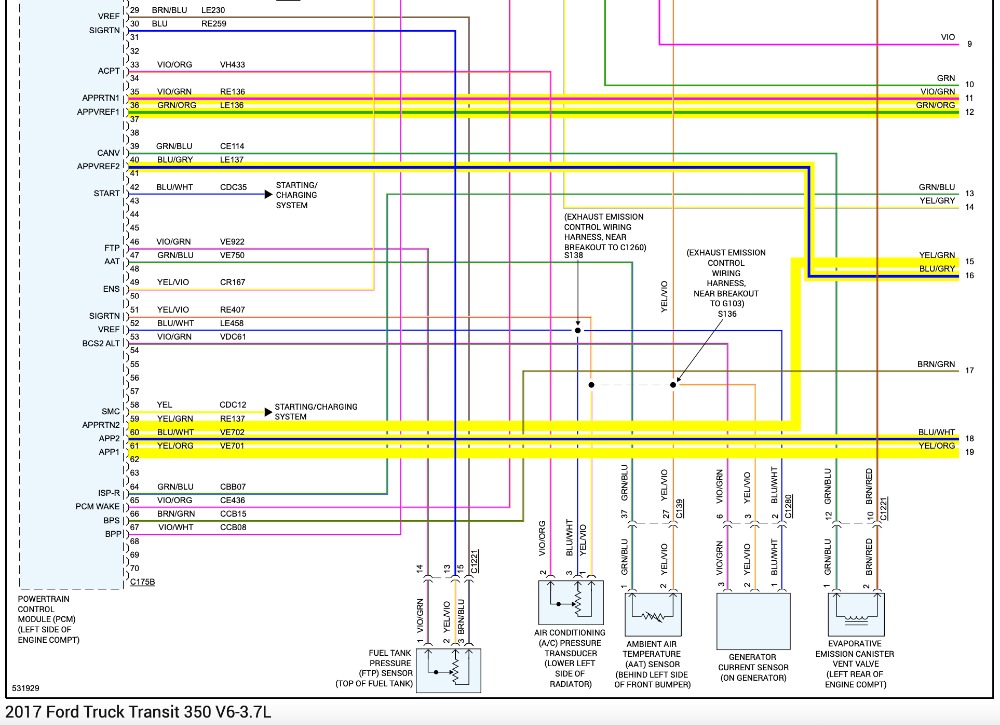

Went back and did some more digging and found the exact same issue on the A/C Pressure sensor. Same DTC description of low current, which started to make sense as that "battery voltage" is just phantom voltage. Test light is very dim.
According to the diagram, the vref is shared with the A/C pressure, Fuel Tank pressure sensor and the Alternator Current sensor. FTP has 5v, but not the A/C. The APP has a dedicated refv as you know, so kinda strange how they exhibit the same behavior while they're on different circuits.

6 months 1 week ago - 6 months 1 week ago #92861 by Noah
Sorry to jinx you lol. Thank for sharing the info and good find!
I disconnected all sensors I could find, including the vent valve, no success.
That's a good place to start, but if the short is in the harness, then disconnecting individual components will not remove the short. That's why I suggested removing the fuse for the vent valve. That won't remove the short, but it will remove the power from the fuse block all the way to the vent valve and, because it's low side driven, back to the PCM. If the voltage on app ref 1 changes, then you can isolate the short down to that section of harness.
Again, if it a short in the harness, like the example I showed, the ref circuit may just barely be touching power. I wouldn't expect the Transit I saw to light a test light either unless the wires were severely damaged and melted together.

6 months 5 days ago - 6 months 5 days ago #92882 by Mgh
Thank you for the info!
I removed the EVAP fuse, still getting battery voltage at the vref of both the APP1 and the A/C Pressure sensor.
I continued to remove all fuses and relays in the engine compartment, and unplugged the Alternator Current sensor, but to no avail.
I agree that we don’t really know how the PCM regulates voltage, because the A/C pressure sensor shares the same vref as the the Alternator current sensor, which works fine. There has to be some back feed from another sensor, but I think I should’ve gotten 5v when I removed all fuses and relays. I’d imagine voltage could probably leak internally, but I am 100% sure the PCM is functional, because I installed it in a different van and worked fine.
What I find interesting about this issue is that even when the ignition is off, APP1 and A/C sensor vref measure battery voltage. I know this could be fed through a constant B+, but again, as I mentioned before, there is almost no current, as the the test light is very dim; so I still doubt there is short to positive; otherwise, test light would be bright. I am leaning towards a back feed from some sensor or some splice.
See attached part of the diagram, ignore highlighted lines. There is a note about that vref: (EXHAUST EMISSION CONTROL WIRING HARNESS, NEAR BREAKOUT TO C1260) S138
I will check there and post back.
