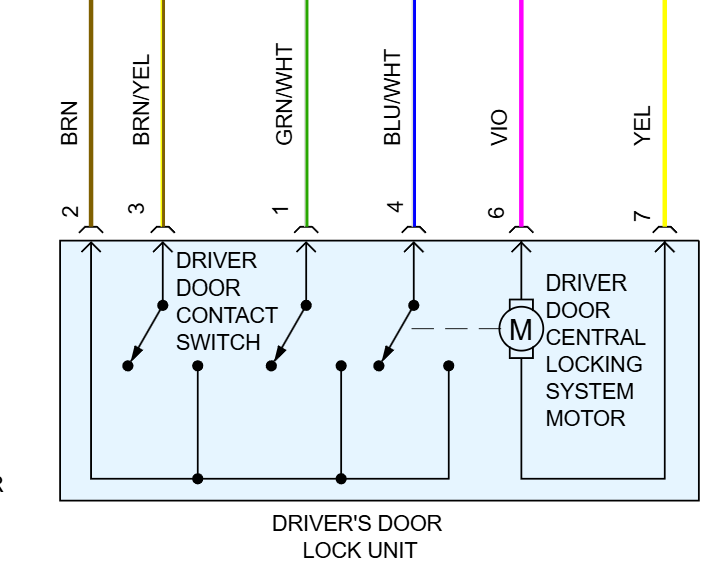

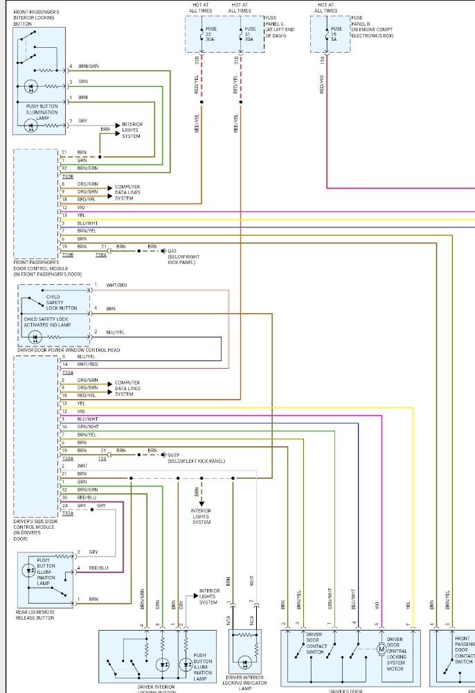

With the panel removed, find pin #12 violet and #13 yellow. Those go to the door lock motor. Hit the lock button while probing each wire with your test light connected to B-. Then probe each wire connected to B+. One wire should light on B-, the other on B+. You're checking for power and ground coming out of the DDM. If they're there, it's actuator time. If one or both is missing, stop and tell us so we can go down another path.

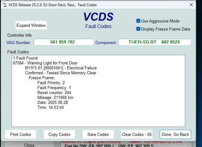

6 months 3 weeks ago #92835 by Kwazii

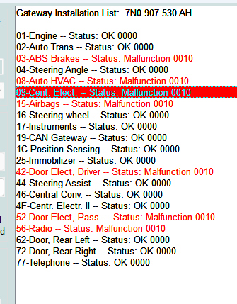

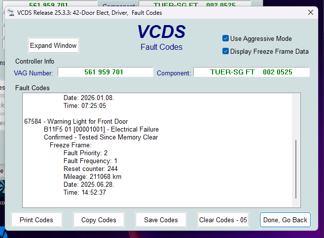

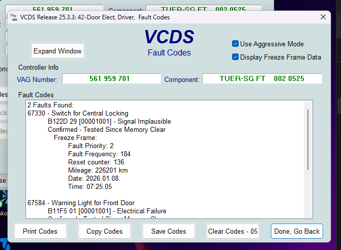

I did an auto scan and found a central locking error. The passenger door also had the same warning light error but I'm not sure if that's related. I also tried clicking on 09-Cent. Elec. but it wouldn't work. It tried connecting a few times then just went back to the gateway list.
6 months 3 weeks ago #92836 by Tyler
Perfect! 67330/B122D is the one you want to follow. I'd ignore 67548 for now.
Because of how VW does its service information, there's no specific code set criteria for 67330. But on a guess, I'd say the Drivers Door Module isn't seeing the door lock motor switch (pin #4) change state when it commands the door lock motor off and on.
If pulling the door panel is NBD, then I'd do the pinpoint testing at the door lock motor connector with your test light. Or you could get a current clamp around one of the door lock motor wires, if you have one.
