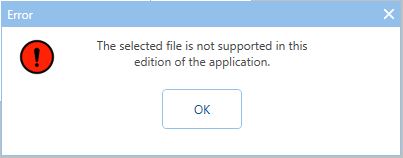

7 months 3 weeks ago #92738 by Chad
I've downloaded your .psdata files, but I am not able to open them.
What version of Pico software are you using?
  • lmg866
  • lmg866's Avatar Topic Author
7 months 3 weeks ago #92741 by lmg866
Pico 7 T&M.

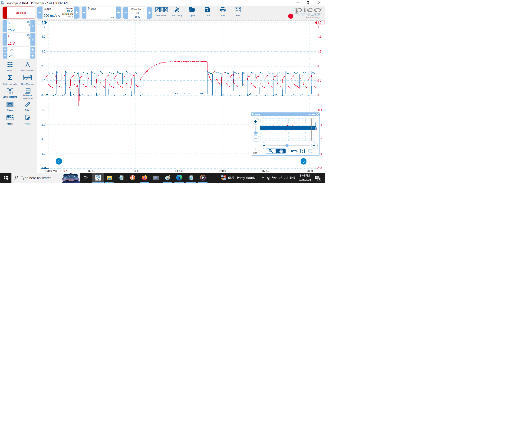

7 months 3 weeks ago - 7 months 2 weeks ago #92744 by Chad
let me know what you are interested in and I will try to post something representative.
The voltage waveform on the control wire should show battery voltage when the solenoid is not energized. When the PCM provides a ground and energizes the solenoid, voltage on the control wire should be pulled very close to 0 volts. When the PCM releases the ground and de-energizes the solenoid, the voltage one the control wire should spike to well over 30-40 volts, then return to battery voltage.
It would be good to see the current ramp, along with this voltage.
Last edit: 7 months 2 weeks ago by Chad.
  • lmg866
7 months 2 weeks ago #92747 by lmg866
I wonder if you are not able to open my waveforms because they were taken with the "Test and Measurement" software as opposed the "Automotive" software?
Hopefully you can see some of what you are looking for in the following. This is engine running, Red = current on LR Control, blue = voltage on LR control. The spike visible is the PCM cutting power to the TCM input wires and setting P0750.
