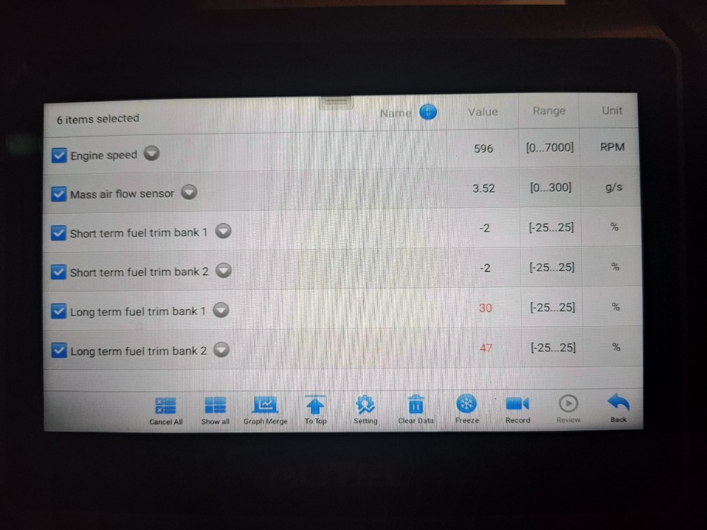

8 months 2 weeks ago #92594 by Ryan360
Hi Chad,
Thanks for taking a look at this.
The MAF measures 3.52g/s
Total FT @2500RPM in Park B1=28    B2=45
Fuel pressure fluctuates between 519 and 664psi at idle and about 560psi at 2000rpm
Ryan

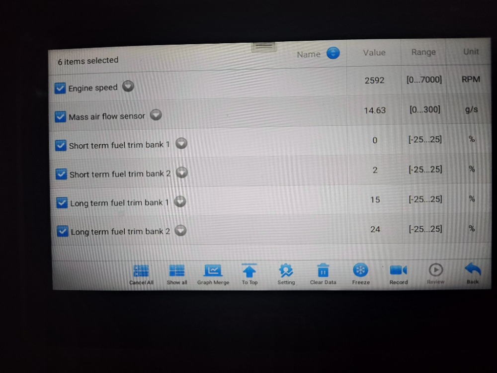

8 months 2 weeks ago #92599 by Ryan360
I just noticed I gave idle FT and stated they were at 2500RPM
The correct totals @2500rpm are B1=15 B2=26

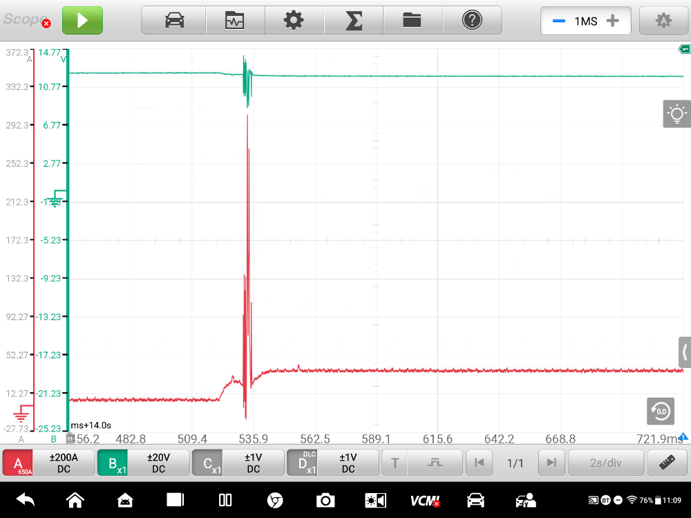

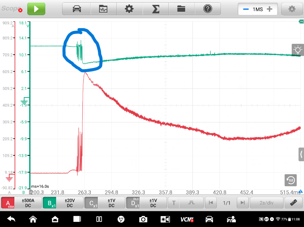

Random No-Crank. It will typically start cranking after a few tries but has taken a lot of tries on occasion. No loss of gear selection indicator (seems to be common on these vehicles)
If you're confident in the battery and connections, then I'd strongly suspect a failing starter. Very common on this engine. How many miles on this Acadia? You can have a look from the underside, just past the front catalytic converter. If you see a GM sticker on the starter, it's very likely original.
If you want to catch it with a scope test, you can watch battery voltage during cranking (or not cranking). Getting to the starter itself isn't really an option, but you can watch it at the negative jump post by the right strut tower, and the B+ stud on the underhood fuse box.
Here's an example from a '12 Acadia with an intermittent no crank. Voltage in green, starter current in red. If you don't have a high current probe, don't sweat it. The voltage trace will work well enough.
We're looking for the circled 'noise'. That's current arcing across a connection, in this case the starter solenoid contacts. Next is the same starter when it decided not to crank:
The rule of thumb I've learned is three spikes. Three or fewer is normal. More than that is suspect.

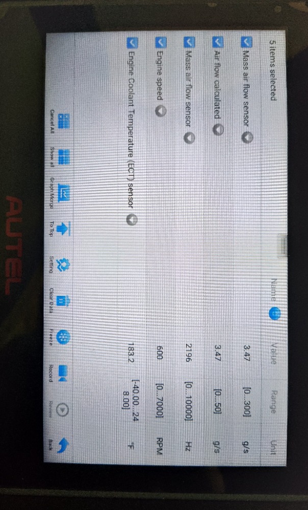

  • Ryan360
  • Ryan360's Avatar Topic Author
8 months 2 weeks ago #92613 by Ryan360
MAF and Airflow Calculated do match to within a few hundredths.
8 months 2 weeks ago #92622 by Tyler
That's... Actually kinda unusual.   Most known good vehicles have at least some kind of difference between actual and calculated. I'm wondering if there's a scan tool concern there, or maybe the calculated value isn't actually using the MAP sensor for a speed density calculation.

8 months 2 weeks ago #92623 by Ryan360
There were a couple of model years, including this one, that do not have a MAP sensor. It does have a few hundredths variance in the MAF to Calculated values most of the time. They just so happened to match up when I snapped the pic.

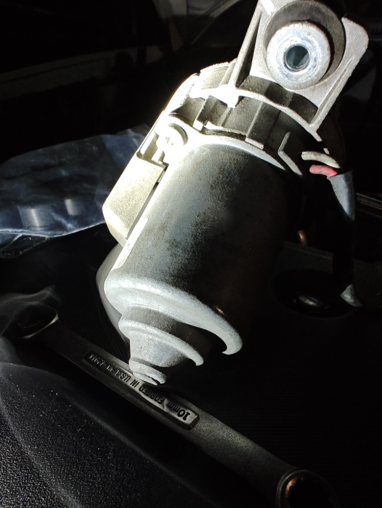

I cleaned the canister of my smoke machine and added fresh mineral oil. I'm not sure if it performs better or not but couldn't have hurt.
I did just find a leak at the vacuum pump for the brake booster. It is leaking on the opposite side as the vacuum line, under a black cover. I took the cover off and see an open port which is leaking. I'll cap it and test tomorrow to see if fuel trims normalize with that leak eliminated.
Ryan
Last edit: 8 months 2 weeks ago by Ryan360.
  • Ryan360
8 months 2 weeks ago #92627 by Ryan360
Well so much for that. I see there is a check valve inline. There is no detectable vacuum at the port in question either. I don't see smoke coming from anywhere anywhere else.
