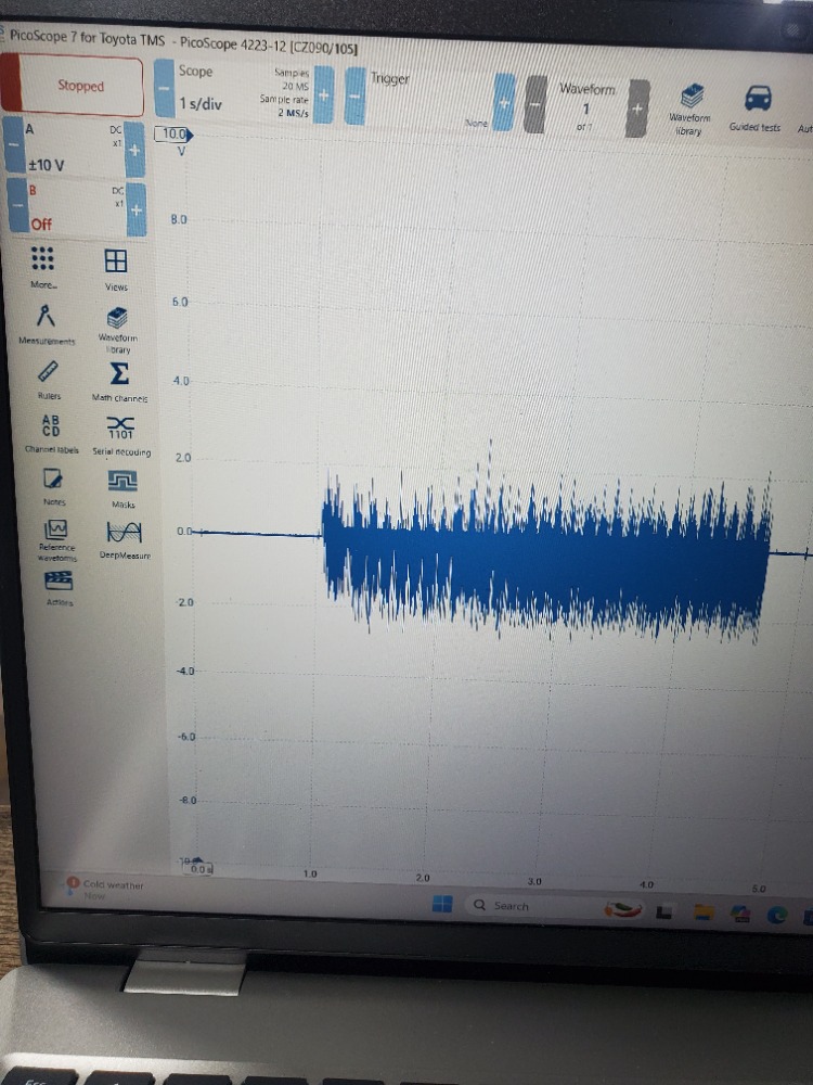

  • VCHESHEV02
  • VCHESHEV02's Avatar Topic Author
6 months 4 weeks ago #92543 by VCHESHEV02
Replied by VCHESHEV02 on topic CAMRY EATING ECU'S.. ECU #5
I UNPLUGGED ALL THE COILS. IGF SIG WIRE AT ECU READS 1.3V SPEC IGN ON SHOULD BE 5V, PLUGGING IN COILS DID NOT CHANGE 1.3 V READING.
I THINK BECAUSE WE FRIED ECU IT WONT CHANGE. DID PICO IGF WIRE, HAVE NOT CHECKED IGT. IGF LOOKS NOTHING LIKE IT SHOULD SQUARE WAVE, JUST BUNCH OF NOISE DURING CRANKING, COILS GROUND DURING CRANKING ABOUT 700mV
  • VCHESHEV02
6 months 3 weeks ago #92547 by VCHESHEV02
IGT SIG DURING CRANKING, CYL 1, ALL CYL IGT LOOK ABOUT THE SAME. THIS WAVEFORM LOOKS SIMILAR WHAT I GOT ON IGF AS WELL
