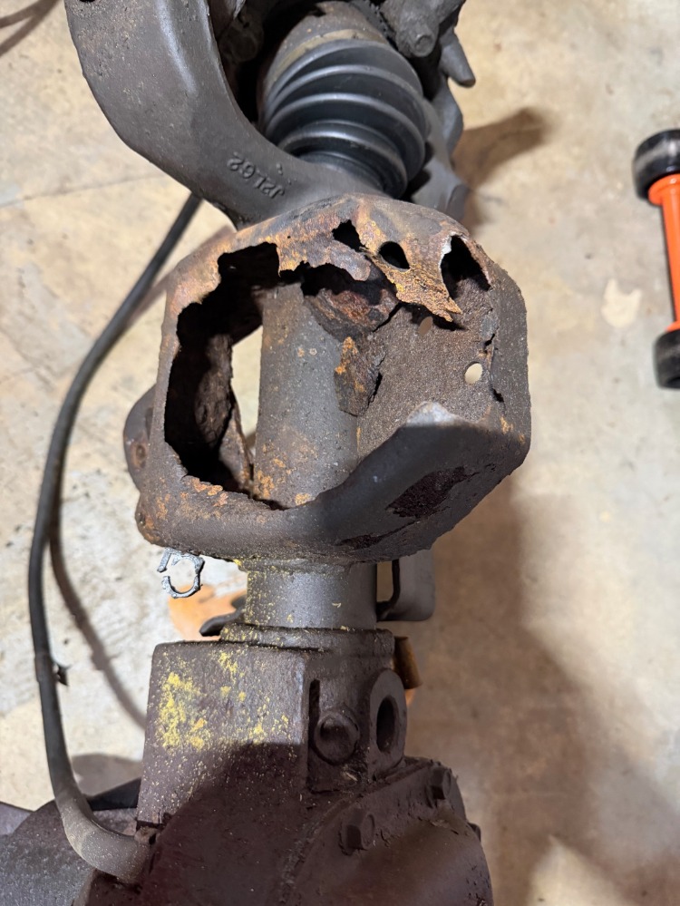

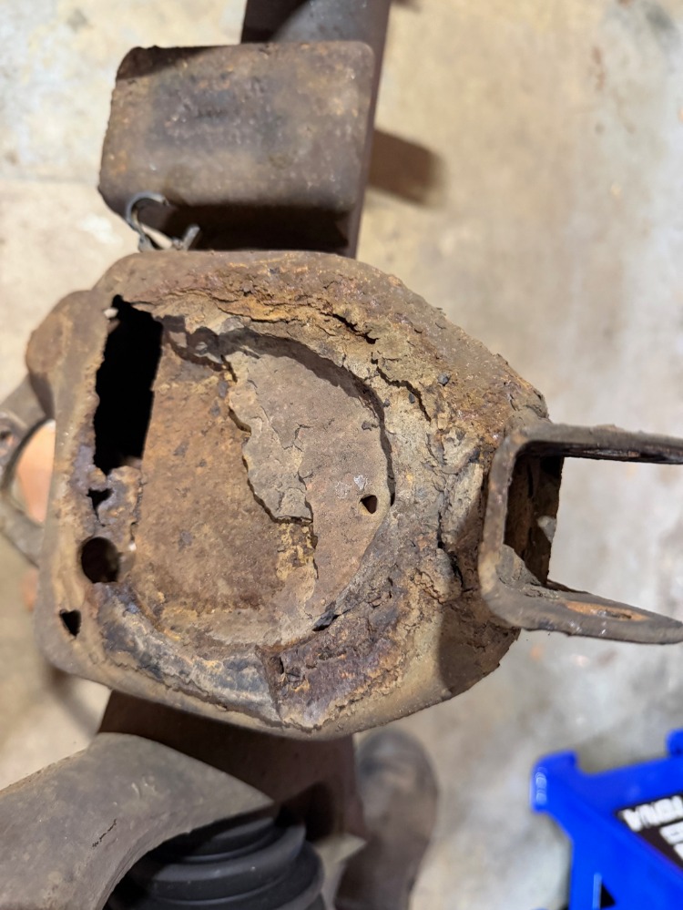

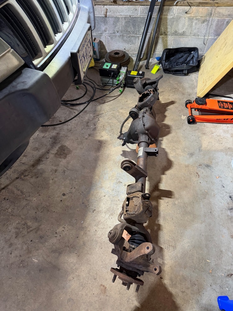

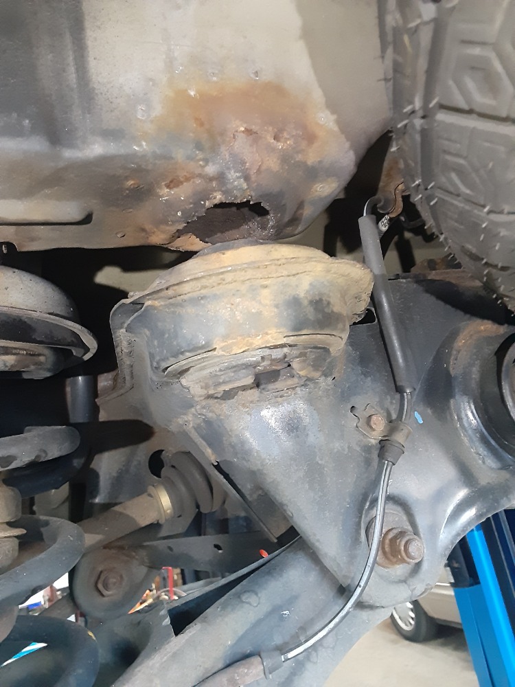

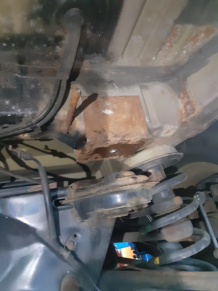

Greetings, guys,
As attached pictures show, drivers side spring perch rust and caved in, and the passenger side also has substantial rust.  Fortunately the axle cylinders themselves are solid. SO I guess mt questions are:
1) Since the welded-on parts of the spring perches are rusted, is it possible for me to hire someone to weld on new perches/brackets (assuming new perches/brackets are even available)? Or would it make more sense for me to get a used replacement axle assembly from somewhere, such as LKQ?

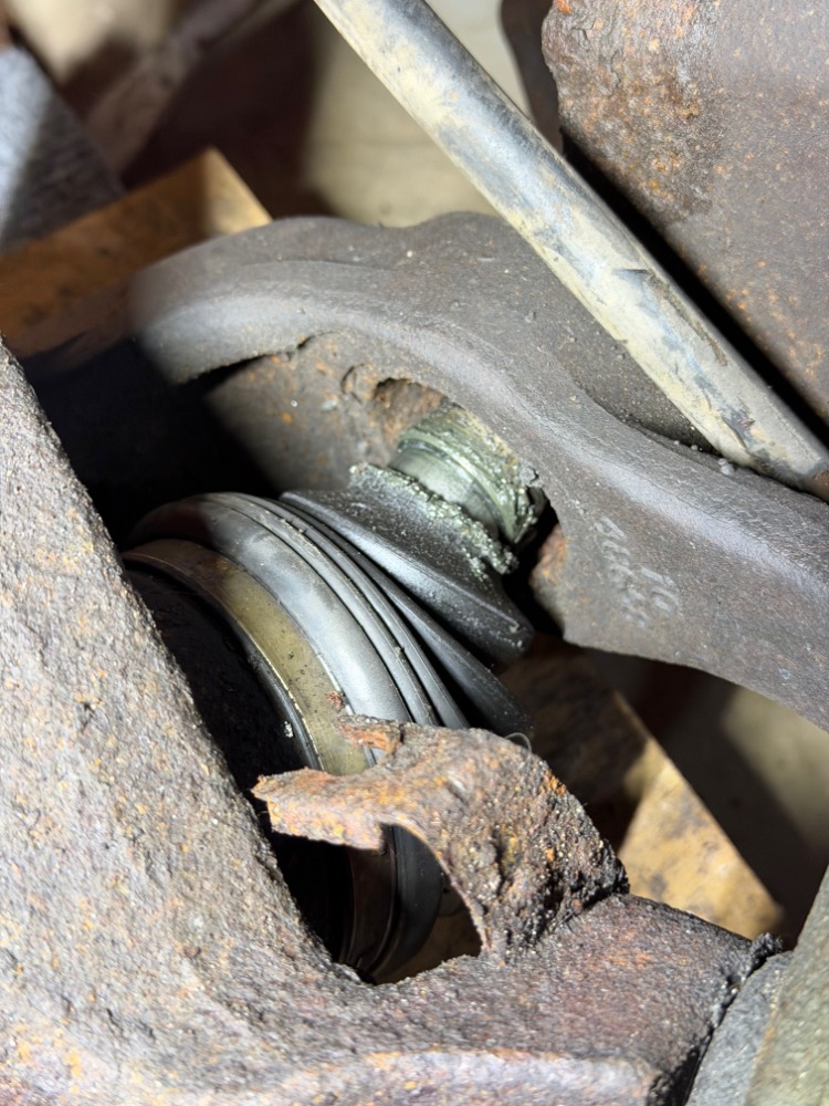

2) Axle shaft boot on drivers side has pulled loose. Apparently clamp let go. I figure it is probably best to go ahead and replace axle shafts and axle seals assuming I reuse this axle assembly.
3) Any other insights, tips, and tricks you guys might have, I'm all ears!
- Pop
11 months 1 week ago - 11 months 1 week ago #92363 by Noah
I remember that being a pretty common failure on those. I wouldn't be surprised if at some point there was new parts available. I would say that if you can find a replacement perch, it shouldn't be very difficult to weld them to the differential. I wouldn't hesitate to make them out of the scrap metal pile if it was my 20+ year old Jeep.
Thats how I fixed my wife's Pilot in 2023, not apples to apples, but don't be scared to get in there start welding stuff.
Last edit: 11 months 1 week ago by Noah.
