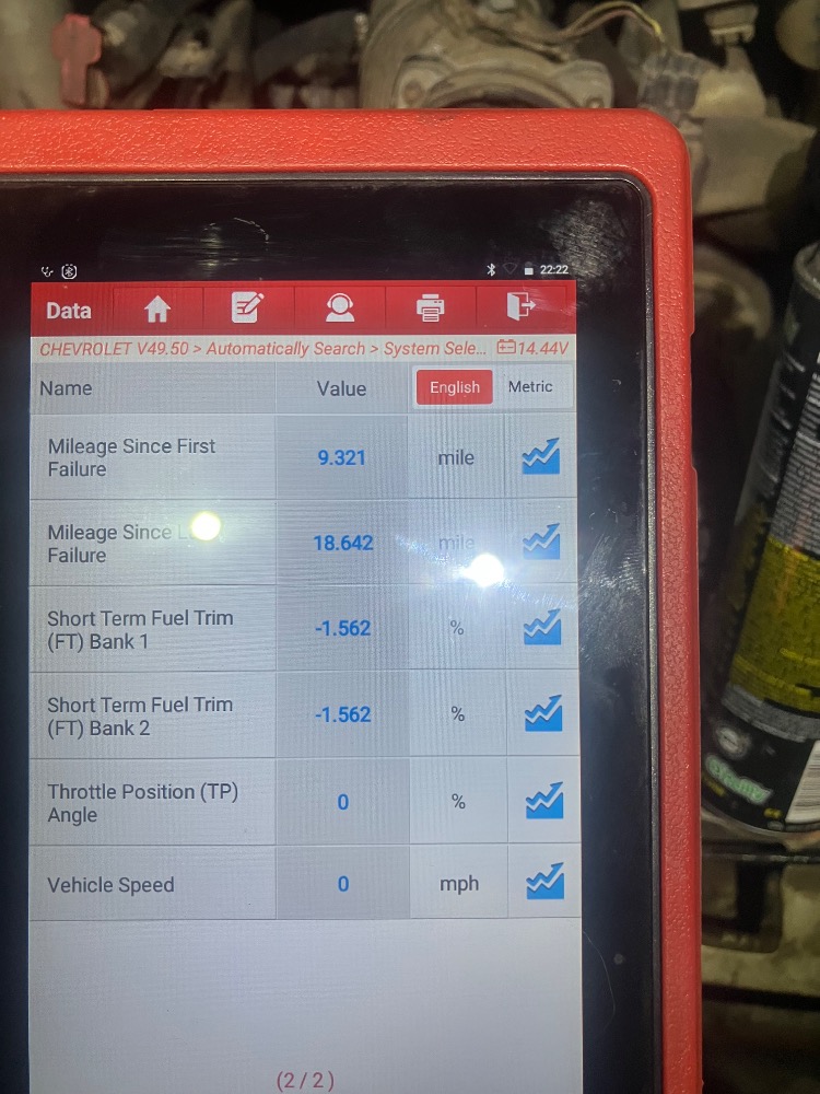

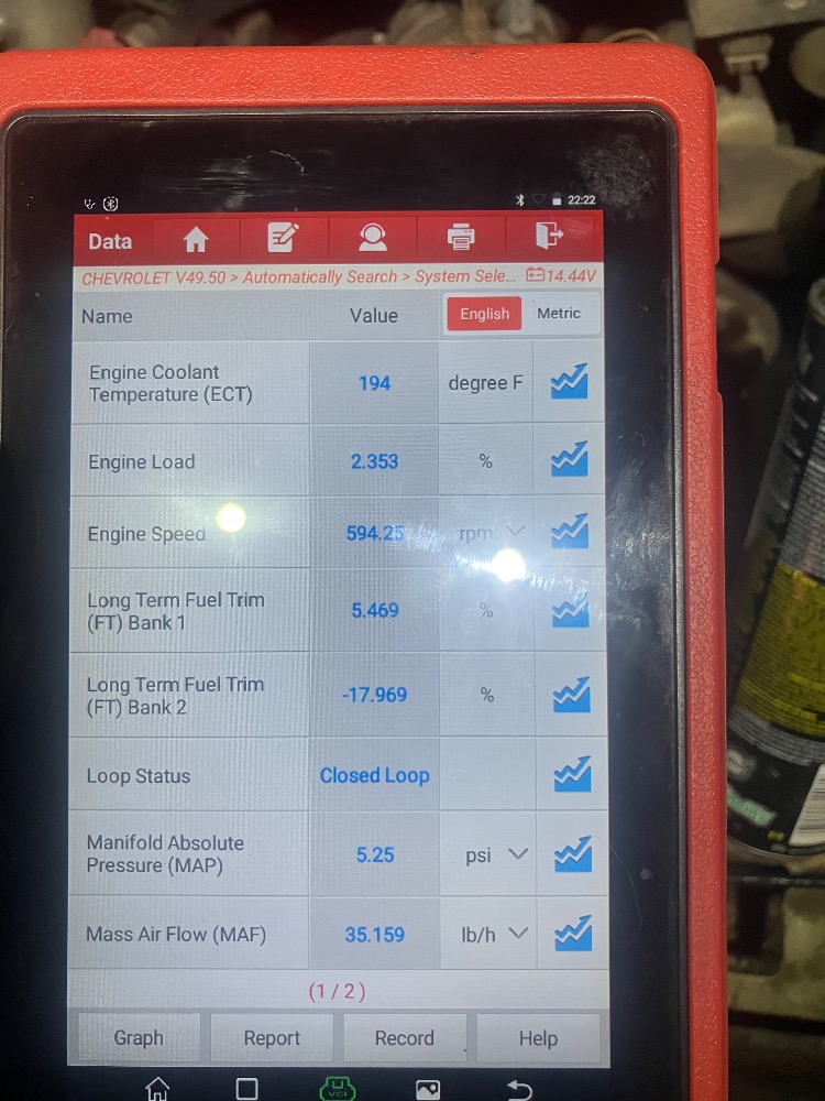

I have a 1999 4.3 p0303 I can’t get rid of. Been a while sense I messed with it but here’s what I’ve checked

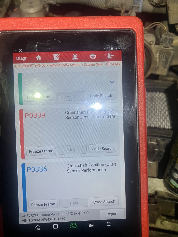

Swapped plugs, checked cap, new distributor (old one had worn gear) compression tested, new crank sensor (for different reason, intermittent no start) fuel pressure and and injector test (all fuel pressure drops identical). Fuel trims are a lil off don’t remember what they were. The misfire counter will count on 3 and move to the next cylinder in the firing order at higher rpm, probably normal. I’ve also swapped around o2 sensors just to see if it would affect the trim numbers, it didn’t. I don’t have a lab scope or id look at some secondary ignition wave forms to try and determine what’s going on. Also, not a dead miss, dropping that cylinder is still plenty noticeable. But you can also feel a slight miss at idle. I’ll attach freeze frame

This looks like the freeze frame data for the crank sensor code. Is that code still returning?
Did you perform the crank sensor variation relearn?
You said fuel trim was " a lil off". -17% on B2 is more than what I would call a lil.
You said you tested fuel pressure and compression, but didn't offer any values.
Checked cap and rotor, how exactly? I'm sure you know these caps are failure prone.
Swapped plugs, what about the condition of the plugs and the wires?
