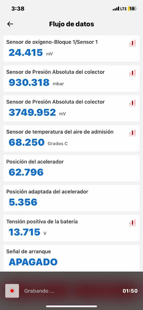

📊 Observed data
• O₂ sensors (upstream and downstream): voltage drops almost to 0 V during the failure (very lean).
• Injector pulse width: rises from ~3 ms to ~18 ms (ECU is trying to enrich).
• Fuel pump voltage: 14 V with proper ground reaches the connector.
• MAP sensor: shows increased manifold pressure.
• Throttle sensor: working correctly (mechanical throttle with sensor).

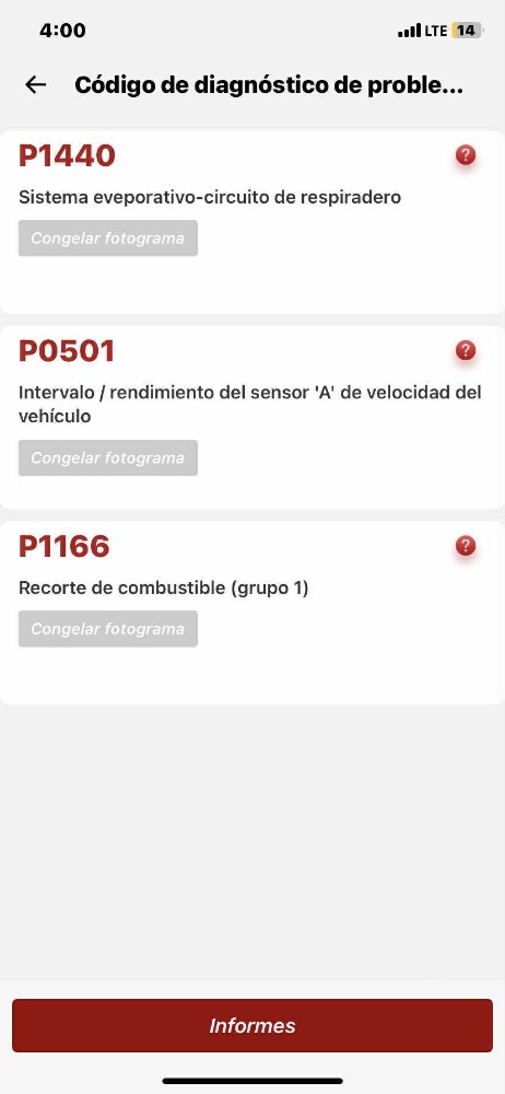

• DTCs: during one occurrence, codes appeared, mainly related to the link.

Thanks again! Yep, I already monitored both O₂ sensors, and they both drop to almost 0 mV during the failure, so that part is clear.
