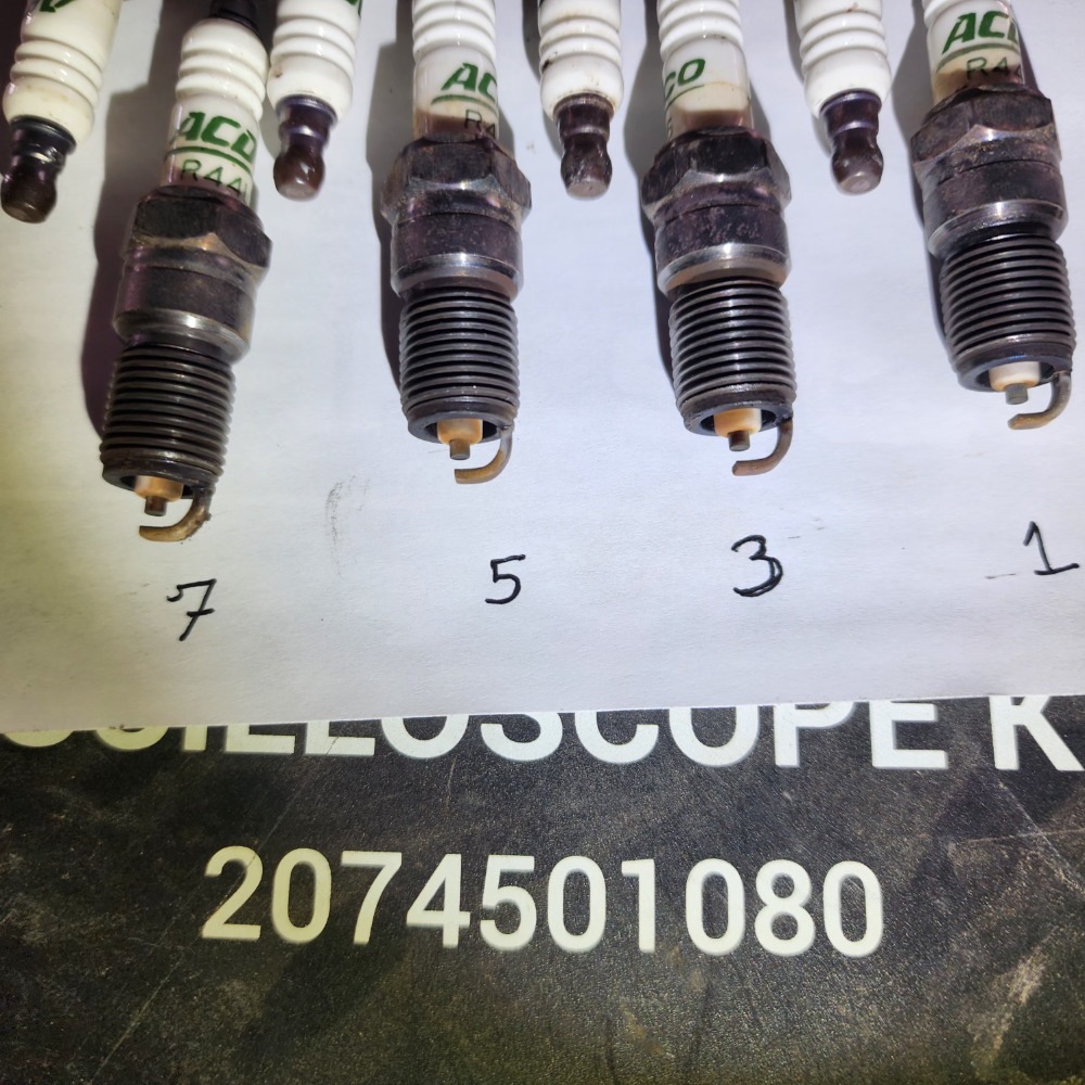

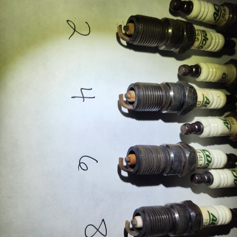

Fast forward to last November 2024 and I blew an oil cooler line early one morning, managed to shut it down and get that repaired but ever since it hasn't seemed right and lately since summer 2025, I began noticing this rough idle etc. Connected scan tool (topdon phoenix nano) and only DTC of note was still the P0430 misfire monitor showed slow active counter on cylinder 4, history showed over 2,000 counts on 4 and around 200 counts on 5. Given my oil out incident I pulled the plug, verified it looked ok, gap was right and pulled compression on that cylinder and had around 145-150psi all 3 times I checked. A couple days later I compared and swapped #4  spark plugs because the burn pattern on #4 just seemed peculiar maybe a little too clean for lack of finding the right words and before I even started the truck, I pulled back up misfire data and noticed no history misfires on #4 now I have the same theme on #5 . Now come this evening and I went back to basics of sorts and pulled a relative compression with a fully charged battery and got what I feel is a peculiar pattern, I've formed a habit of doing REL COMP on every misfire before I get too deep and have seen a variety of patterns but none such as this then again Im not typically pulling them on old small block chevy's.

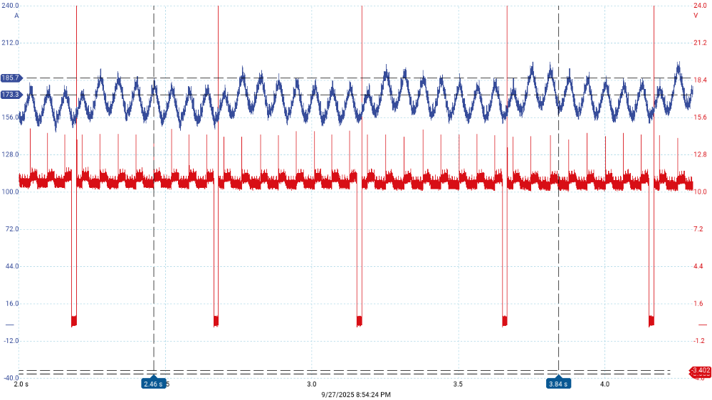

I would love to hear people's analysis of the waveform which I have saved in a few formats as well as what your next step in the diagnostic process would be if this was yours to solve!

I see that kind of "rolling" pattern sometimes. When there is a cylinder with with lower compression, the next peak in the firing order will be higher and the pattern will kind of march down like that.
I don't like to measure compression with a gauge on just a single cylinder, "good" compression is more than a single measurement, compression really needs to be compared across all cylinders to make sure they contribute evenly. I would probably disable fuel delivery, perform a compression test with all the plugs removed, and repeat the test with a squirt of oil in the cylinders that may come up low since you mentioned heavy fuel smell, just to hopefully eliminate fuel wash as a cause of potential low compression.

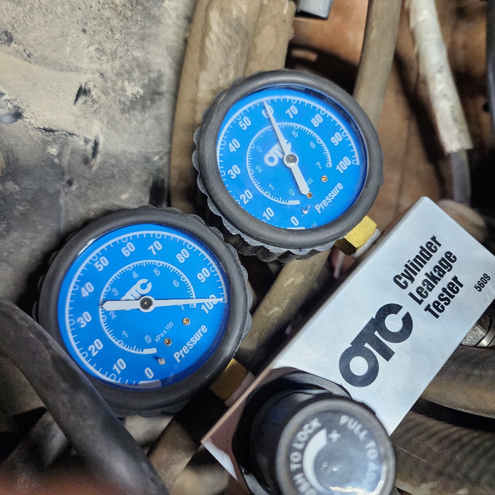

Compression and leak down test results:
1 - 145psi / 1%
2 - 145psi / 0%
3 - 140psi / 7%
4 - 143psi / 11%
5 - 142psi / 2%
6 - 125psi / 40%
7 - 145psi / 0%
8 - 140psi / 0%

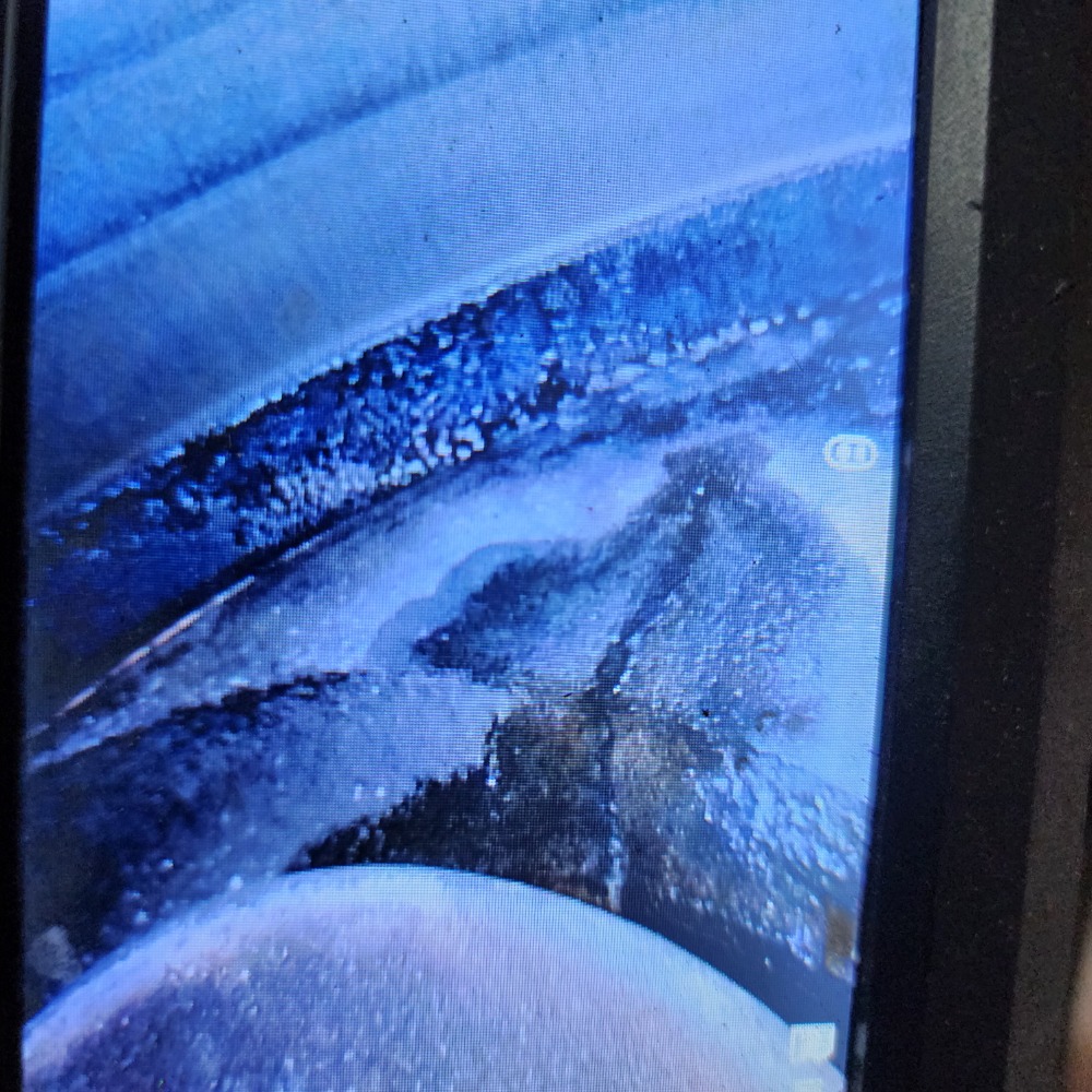

Further inspection I found the cooling system pressurizing and when I removed the radiator cap it was pushing coolant out with small bubbles. I removed the leak down tester and installed a cooling system pressure tester and used a borescope to inspect the cylinder, it appears I have a cracked cylinder head on cylinder #6 and on with pressure applied to the cooling system I was able to see the wetness around the suspected crack grow.

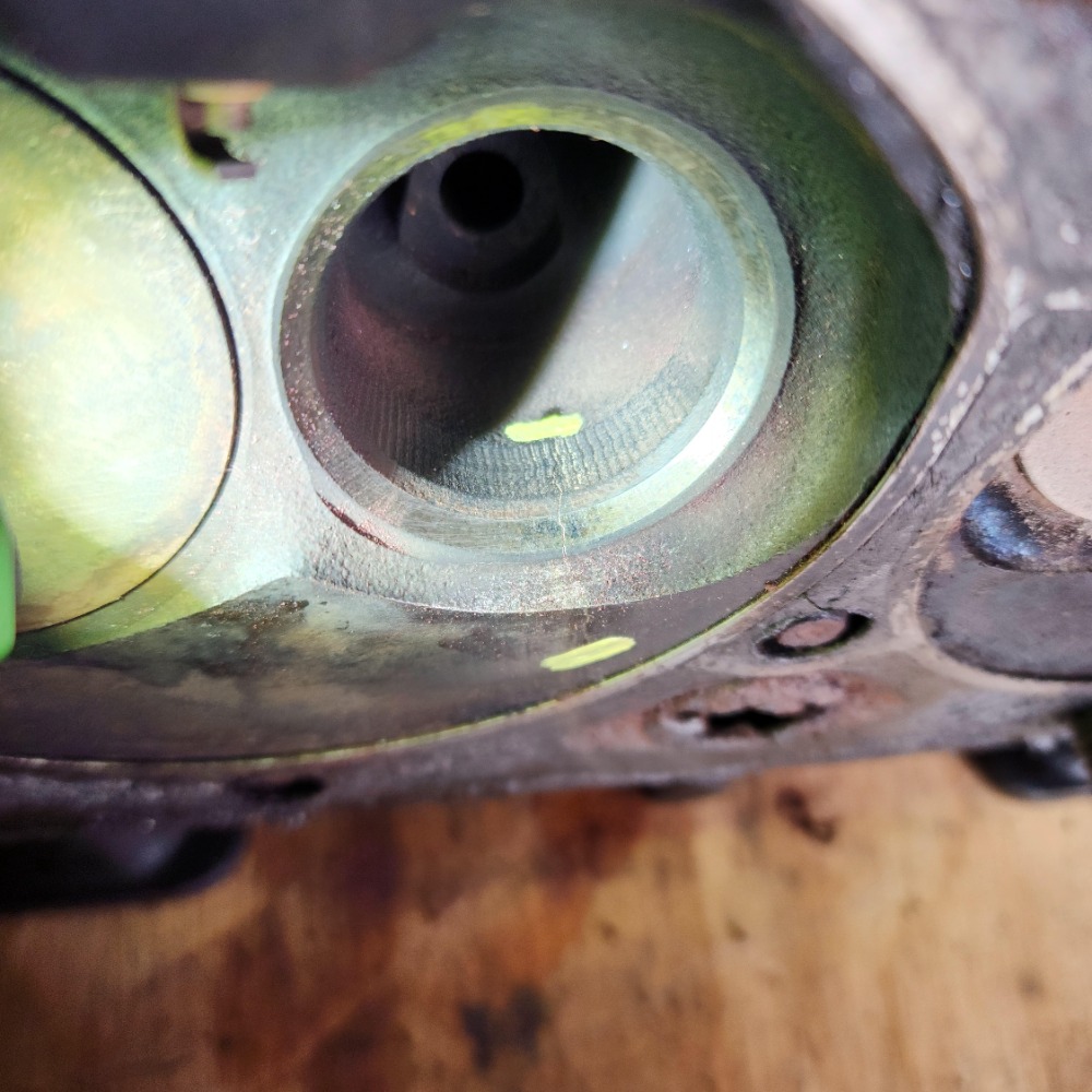

#6 exhaust port

Bad news, at least you know what you're up against. Nice job sticking with it and finding the issue.
