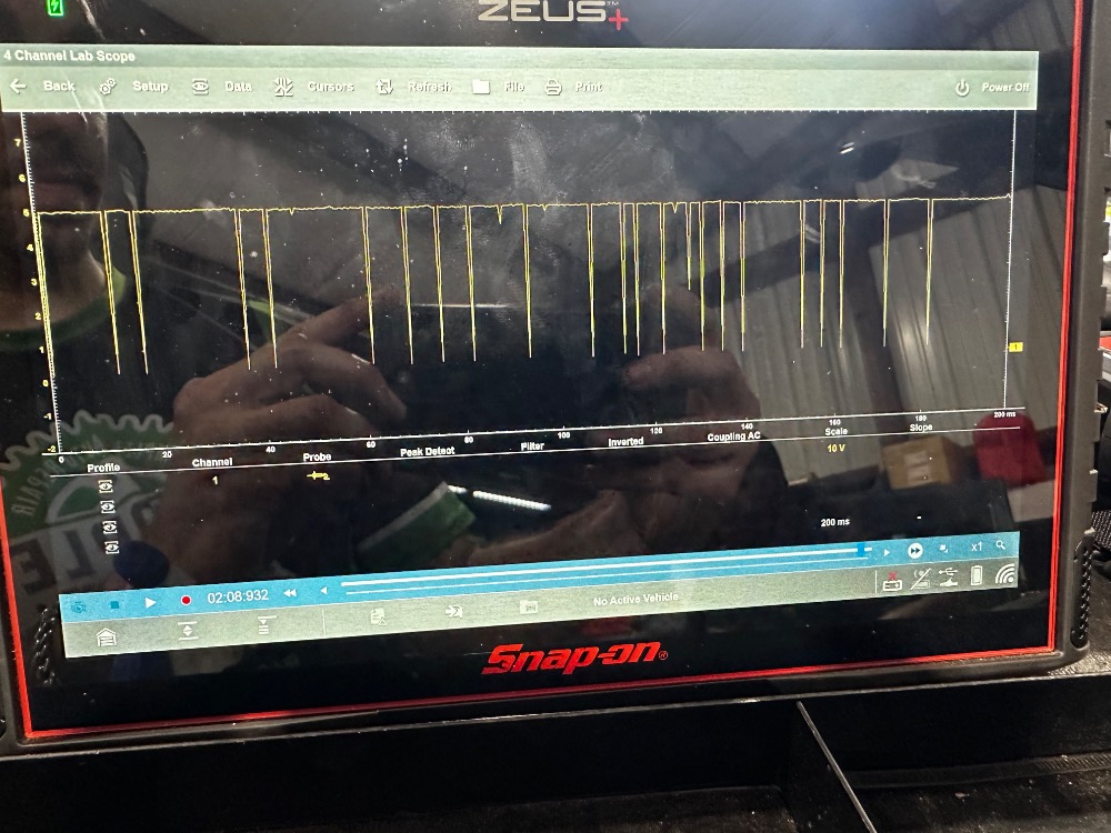

Hello. New to the community and new to the forum (well any forum in fact). Hopefully I'm posting this in the correct place and looking for some guidance! I currently have a 2016 Ram 1500 5.7 in my shop with a crank no start condition. It has no codes and good fuel pressure. Started with a relative compression, results are good across all cylinders. I decided to move to a crank and cam waveform to see if I may be missing something there. What I'm finding is that my crank signal was stuck at 5v and at times would drop to ground while cranking. Not a good waveform at all. So I checked my ground and reference from PCM and they were good. Made sure I also wasn't loosing it while cranking. Viewed my reluctor wheel with a bore scope while turning the engine by hand and found no issues there. At that point I made the call on a crank sensor. Replaced the crank sensor and cleaned the block very well where the sensor mates. No change in results, still no codes. Used a Mopar sensor. Began looking at the circuit a little more in depth and did some testing at both C2 PCM connector and crank sensor connector. I have no change in this signal throughout the signal wire to PCM. Viewed some live data while cranking and I can see after a few seconds of cranking, my crank and cam sync pids are "in sync" and the tach does read a little RPM change, still no codes. Out of clear flood mode cranking, it wants to start, and it tries but will not run and eventually stall. Scan data pids also show crank signal missing is "false" when cranking as if this PCM is seeing good signal but I cant get one to save my life on a scope. Now im fairly new to scoping, so I have checked my connections and ground several times, even swapped around my leads and probes. I don't believe its in my set up. So I look into my ASD relay and can see I have no power from it on coils or injectors, however I have good circuit and control, and I confirmed that by back probing into my coil and injector power by ASD relay and can toggle it on and off with scan function. In TIPM I have no ground control from PCM to turn on that relay with key on or crank. So I bypass it to see if my starting condition changes. still nothing. Now im going down to the crank sensor because I try not to ignore the data, signal is bad. There is no logic in service data of pull-up or pull-down hall effect on this sensor, just generic hall effect signal generation. That's when I came across Danner's videos and look to do some more testing when I'm back on Monday. However, I do know I have 5v on my signal wire with sensor disconnected, that would indicate I have a pull down sensor correct? If so, the last thing I can think of is checking that signal wire for short to battery or another 5v in that harness? Been caught up in this thing for a few hours end of day Friday so I used the weekend to take a break from this and see if I can seek some help or guidance here. I guess my main question would be; Where would some of you guys start with this data so far in this situation? Scratching my head a little bit here. Thanks.

Sorry, I didn't see this post yesterday. It sounds like you've done a good job checking the crank sensor circuit. You can try a bypass like Scanner Danner does in some of his videos by disconnecting the crank sensor connector and rapidly touch the signal wire to ground and watch for RPM on the scan tool. You have cranking RPM in the data, so it sounds unnecessary as of right now.
It's hard to see, but it looks like you have the scope set up at 1sec? That may be too much time to catch the crank signal, you may want to try setting it up @ 500ms and see if there's an appreciable difference. Based on what you're seeing in the data, it sounds like the PCM is seeing the CKP signal.

Yes the 1sec on the time base was easier for me to see while cranking from in the cabin. I have a same crappy signal at 200ms.

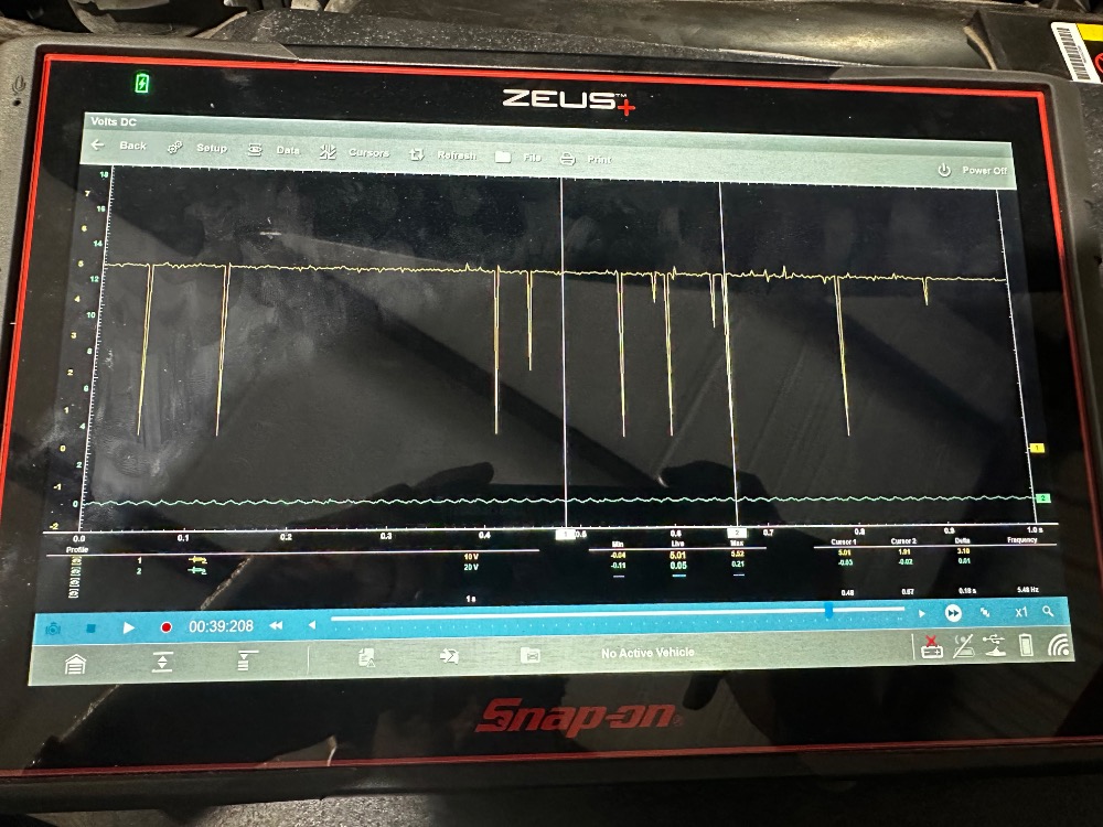

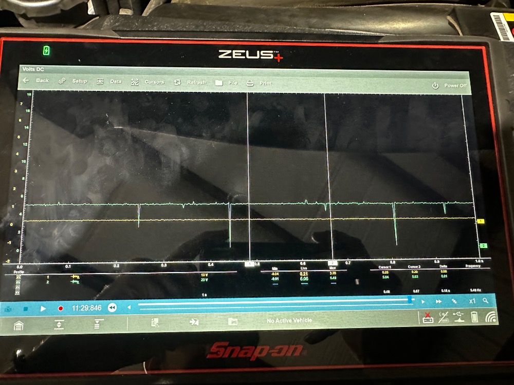

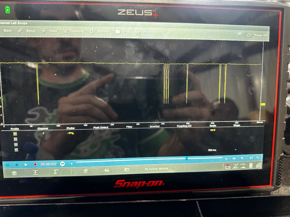

I think you need to "zoom in" further still. Try 20ms. Since you have a running truck, set up on that one and play with the time base untill you get the crank capture you are expecting, then keep those settings for the no start CKP.

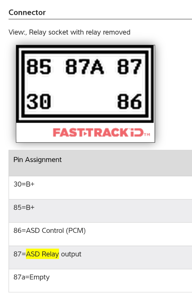

Do you have power on pin 30 and pin 85 of the ASD relay?
It's weird that the scan data points to the crank sensor being present. I think there is a data pid that indicates the control status for the ASD relay. I know you can command it on, but it would be nice to see the command status while cranking to get an idea of if the computer says it is trying to activate the relay while there is no control.

That's a good idea, and I was telling myself to do that on the good known while in the shop lol. it's a 2019 5.7 Cricut is the same, with some differences like PCM, mounting location and pinouts. However, that 2019 did run with the crank sensor installed that is giving bad signal in my 2016.
I also tried 20ms, same result, just erratic and at times a drop to ground. This is at the sensor and at the PCM signal. I usually start with the 20/20 rule if I'm in the 4-channel scope. I also tried the presetting in guided component test with the Zeus when selecting CKP sensor.
Yes, while cranking, I had my scan tool on ASD state and also had more scope leads in an injector and a coil ASD power. I get power all the way there.
With a test light, I did confirm power on both 85 and 30. Even used a relay bypass while cranking to see if I can get it to start, no luck.

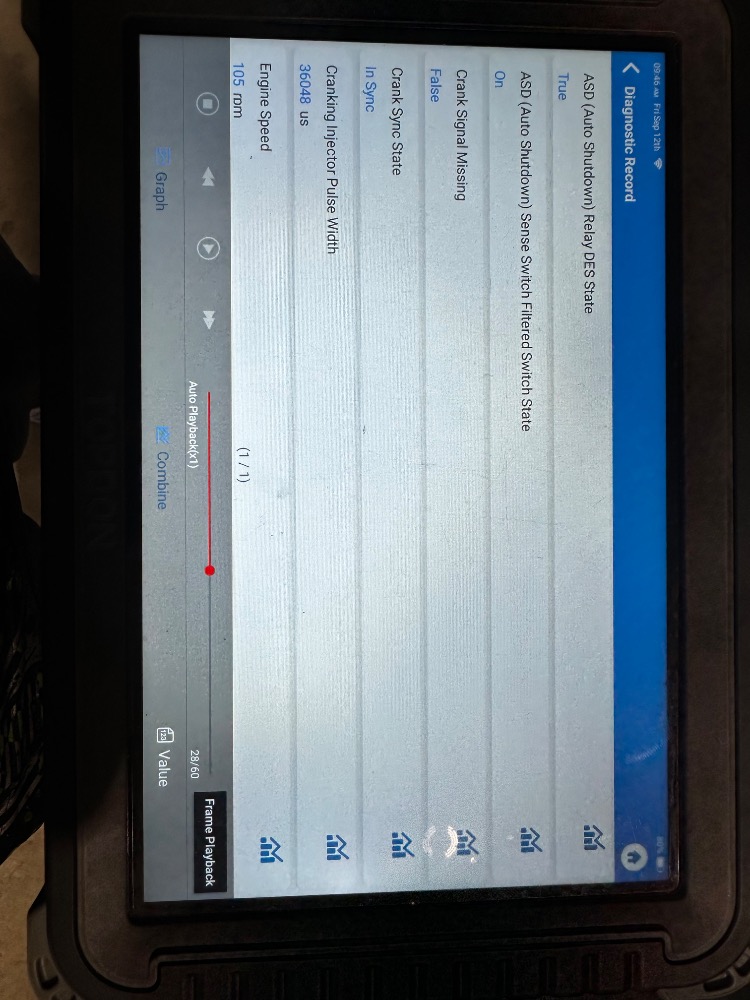

So no luck on good known crack signal from the truck I had on lot, it sold.
I do have power in 30 and 85 of ASD relay.
Here is a screenshot of scan data while cranking.

Replied by jcampisi1202 on topic 2016 ram 1500 5.7 crank no start, bad crank signal.
Cranking scan data.
