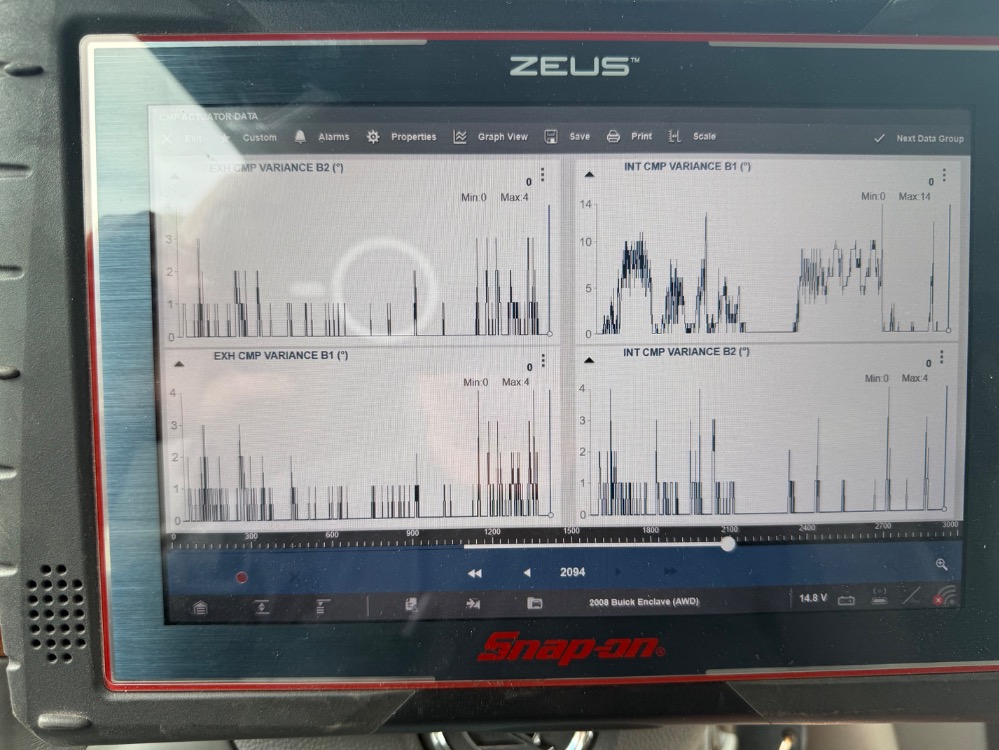

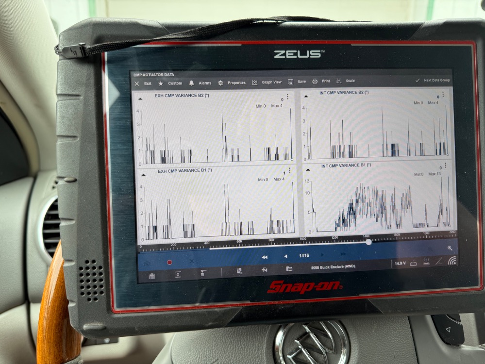

I put new cloyes timing chains on this 3.6 engine I had a p0019 and p0011 and c0561 before I did the job the variance was all over before I did job now only on the bank 1 intake cam as pictures show I am still getting the p0011 and the C0561 codes any help would be much appreciated

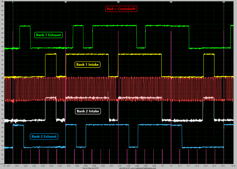

To ensure that the chains were installed correctly, disconnect the VVT solenoids and capture Cam/Crank correlation. Compare it to this known good.

The cam does advance it actually advances 3 degrees higher then the intake cam on bank 2 I did the bank 2 intake cam to compare the 2
