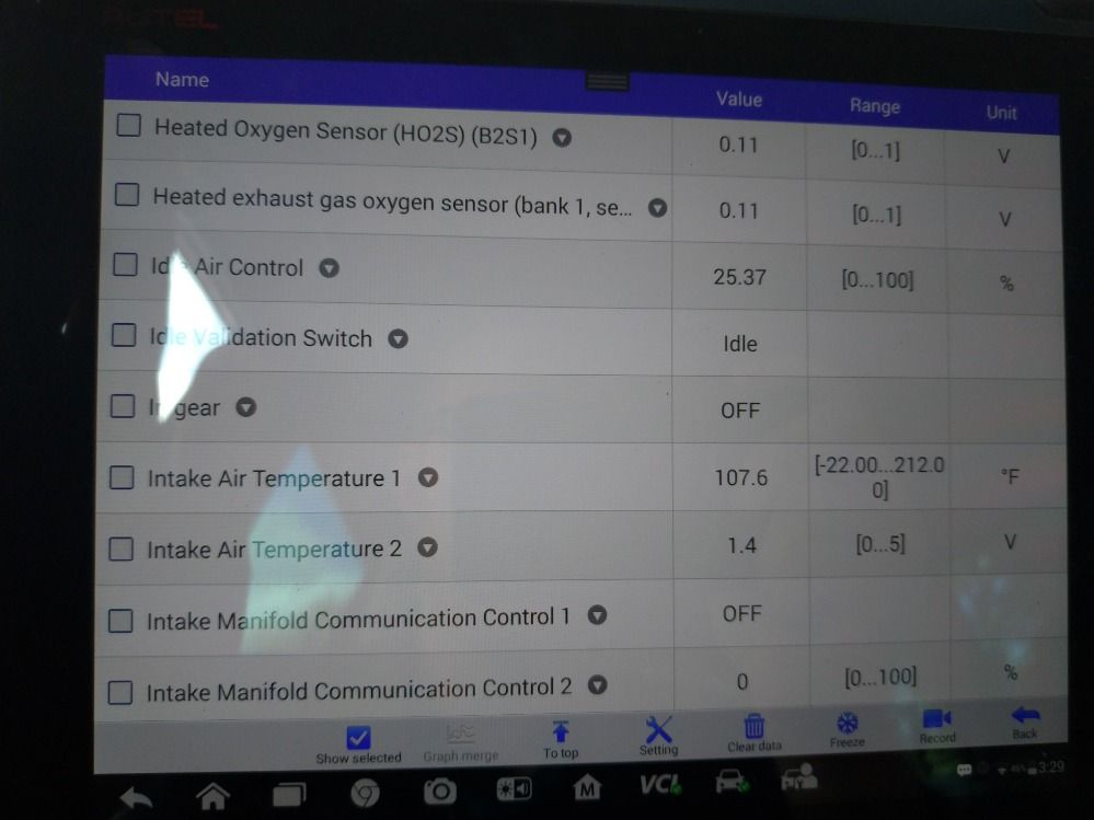

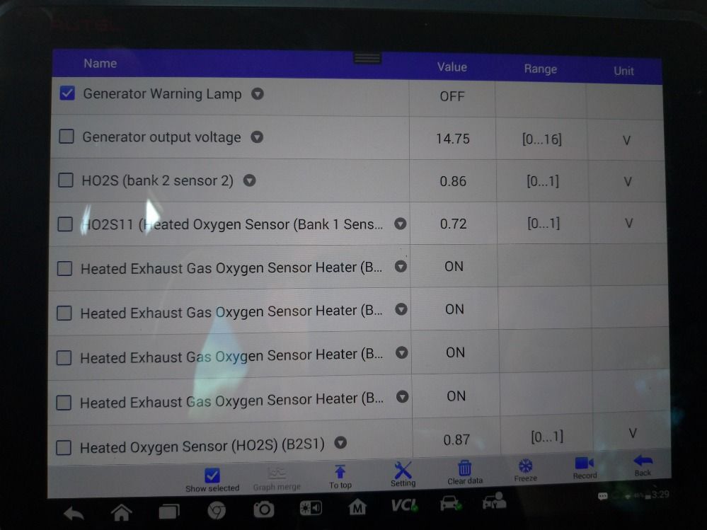

Here the info I pulled today after the van was warm and running badly.
Throttle pos. V 1.03
Tps % 20.78
Relative TP .39%
Stft 1 -0.78%
Stft B1S1 -0.78%
Stft B2S1 0.78%
Stft B2S2 99.21%
Stft 2 0.78%
Spark Advance 6.5
Ltft 1 -10.93%
Ltft 2 - 7.03%
Mass airflow 1 0.01 lbs
Mass airflow 2 0.72 v
Idle air control 25.37%
IAT 107.6 F
IAT 1.4 v
Engine RPM 714.25
ECT 192.2 F
ECT 0.62 V
