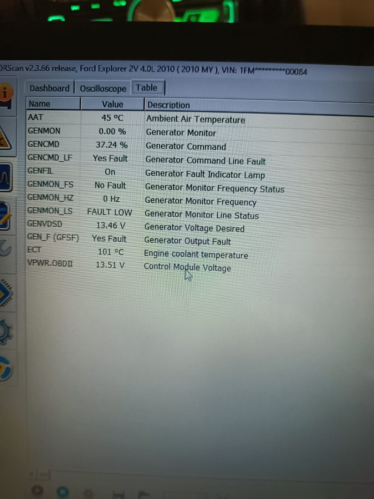

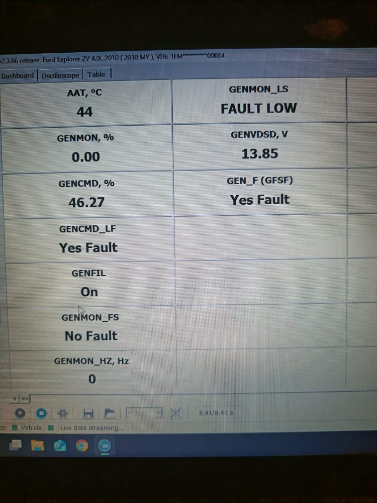

I would like your help in pinpointing exact issue for the charging system for my ford explorer 2010 4.0l with new battery,
the battery light comes on every 10 mins and sets off P0620 code.
attached is the PID for all alternator related PIDs.
New PCM, New Battery
Could this be a bad alternator regulator? or the wiring ?
Kindly help in this matter.
below codes retrived from FORScan while Engine running.

From your captures, it looks like GENMON is low all the time. That could be wiring, or an alternator. You'll need to do some pinpoint checks to tell.

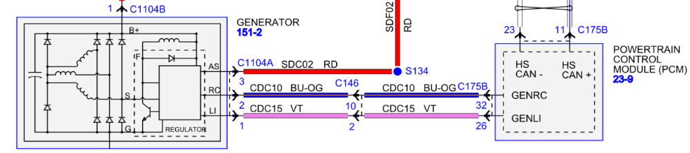

Perfect, thank you! I agree, I think the blue/orange (GENCOM) is shorted to voltage somewhere.
I'm also concerned about the violet (GENMON) for a different reason. GENMON isn't shorted to voltage, but also isn't getting pulsed to ground by the alternator. We can circle back around to that.

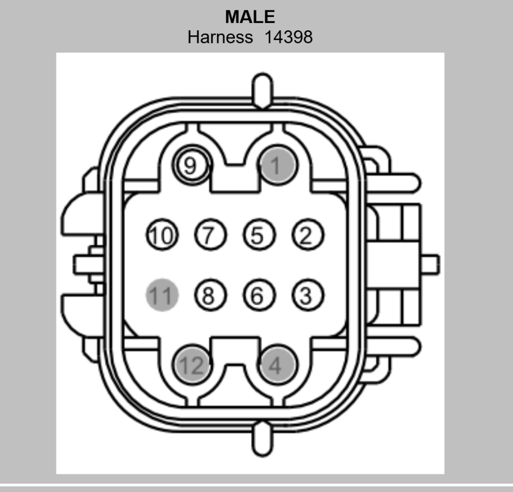

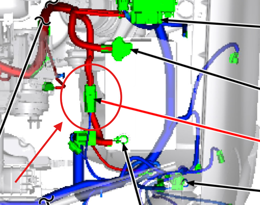

According to the diagram, there's one connector in between the PCM and the alternator. C146.
It's right in front of the battery on the drivers side:
Disconnect it and recheck voltages at the alternator connector. If blue/orange is now zero, the problem is on the PCM side of C146. If there's still B+, the problem is on the alternator side of C146.

To be clear, you still have voltage on the blue/orange wire at the alternator with the key on and C146 disconnected?
If so, you're looking at a short to power in the engine harness. Now you're down to finding it. Was C146 clean of fluids/corrosion? Same for the alternator connector. Any obvious harness damage?
Reconnect C146, key on, connect your multimeter to the blue/orange and watch the voltage while you gently wiggle the engine harness all the way to C146. When you see the voltage change, you're in the right area. Try to narrow it down to a few inches of harness that produces the most voltage change before cutting anything open.

I think I'm thinking of that right? Blue/orange should have less than 1.0V on both sides of C146, key on. This connector, pin #10, right?

I found the issue. It was the blu/orange wire that is taking voltage somewhere between the alternator and the connector next to the battery. I made a direct connection for this wire with new wire from alternator connector to the female side of connector near to battery. Now there is no more light
