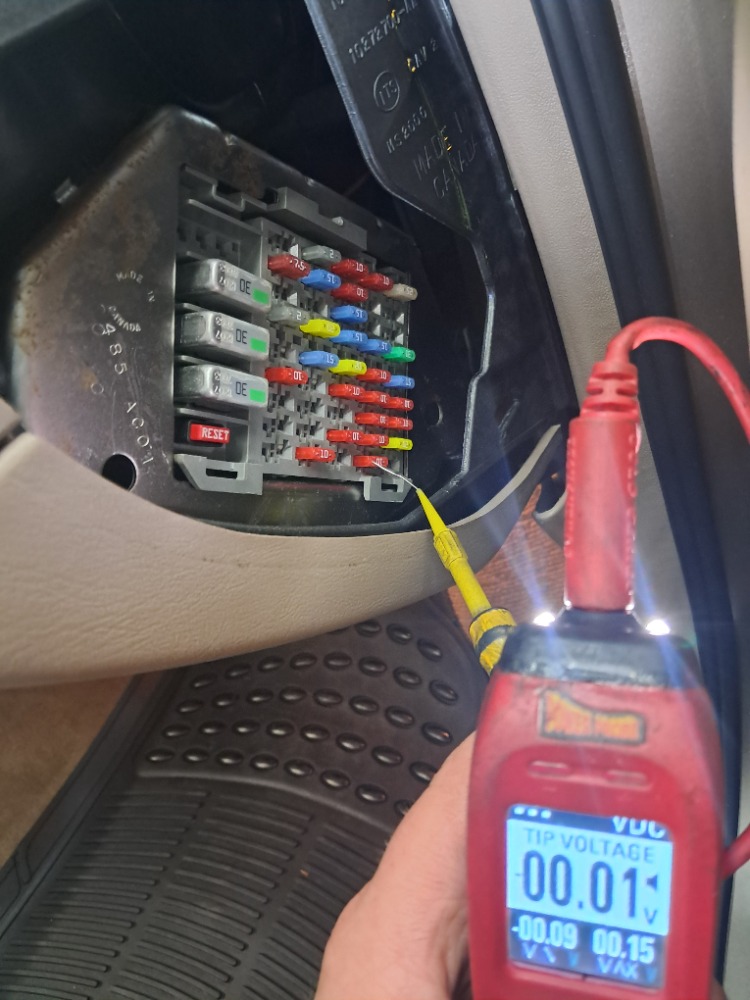

Here's what I have for today..
Bottom line no power to IP panel A3&4 ( or 5&6)
And H works in Start but no voltage at Run.
Still have the  P1626 in the PCM and B1477 in the BCM..

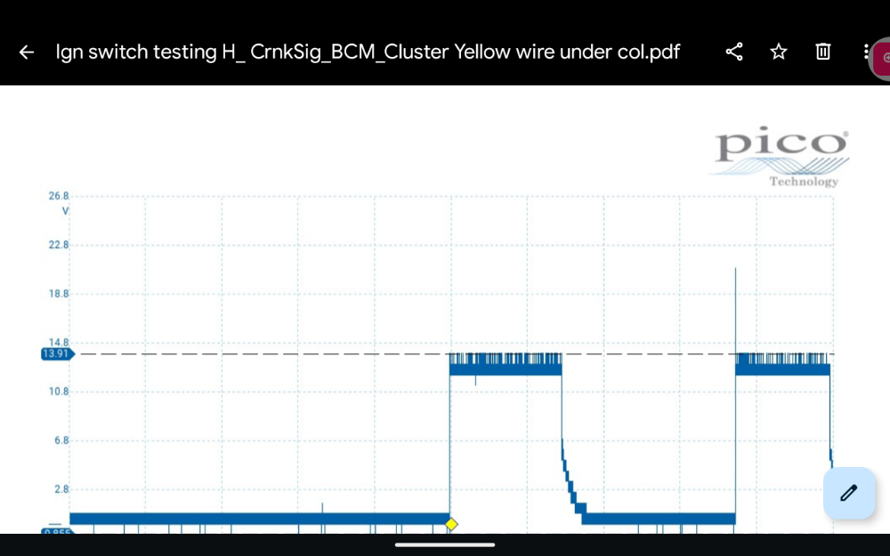

1 year 1 day ago - 1 year 1 day ago #92126 by Noah
If you are back probing this yellow wire directly at the ignition switch connector and only have power while cranking but not in the Run position, then there is a problem with the ignition switch.

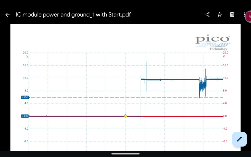

11 months 3 weeks ago #92147 by StepSide88
New switch was installed and no difference. Still have 0.0v at Run and 12v at Start.
I have a new key lock cylinder in hand as well but my scan tool is reading all the Key associated pids from Security and Class 2 from the OG key just fine.
It shows the key in Run when it is.. which is part of this question I have.. is the key lock cylinder acting as an actual switch (electrically speaking completing a circuit) ? If the modules are communicating with it with no complaints what's interrupting it in Run position?
the Switch (part 8945 under the column) is comprised of a sealed switch box , wire harness and connector and has continuity underload of a 3A test light to the IP panel A3 fuse terminal so it will hold the voltage when there.
Any suggestions?
Anyone?
11 months 3 weeks ago #92149 by Noah
The lock cylinder does not carry any current. It is essentialy a finger pushing a button, your finger doesn't carry any current when you push the window switch to make the window go down, if that makes sense.
You could turn the switch in the box with a screwdriver and should still have voltage on the yellow wire in start or run.
Are you back probing at the connector on the yellow wire with the switch plugged in, or are you still measuring at the fuse panel?

11 months 3 weeks ago #92158 by StepSide88
Back pinned the new switch and same results on the yellow wire.
0.0v @ Run
12v @ Start

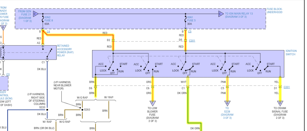

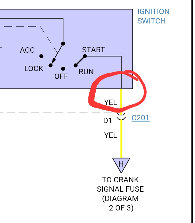

11 months 2 weeks ago - 11 months 2 weeks ago #92161 by Noah
It defies logic that both switches would fail in the exact same manner, but like I mentioned before, we have to trust that you are performing the tests correctly.
According to the diagram I have attached earlier, the yellow wire labeled D1 on ignition switch connector c201 should be hot in run or start.
Assuming the diagram I have attached is correct, which I believe it to be, and assuming source voltage from the fuse is good (which it must be to have power in Start) with the ignition switch in Start (being engine cranking) or with the ignition switch in Run (being the position the switch defaults to after releasing the key from Start) there should be power on the yellow wire labeled D1 while back probing the ignition switch side (not the body side of the harness so as to rule out a terminal issue in the connector) of connector c201. It is a straightforward switch circuit, the only fault can only be the switch itself. There are no more trouble shooting steps for no power on D1 in Run and Start.

11 months 2 weeks ago #92167 by Noah
So maybe we're not exactly on the same page, I have the Buick in the shop right now for front end work and decided to poke some fuses.
If this is the fuse you are saying has no power in run, then that appears to benormal. The car is running right now.
  • StepSide88
  • StepSide88's Avatar Topic Author
11 months 2 weeks ago #92168 by StepSide88
That is the fuse. I guess I can check the BCM for it's power at B9 .. as that's where the codes are seemingly being generated.
