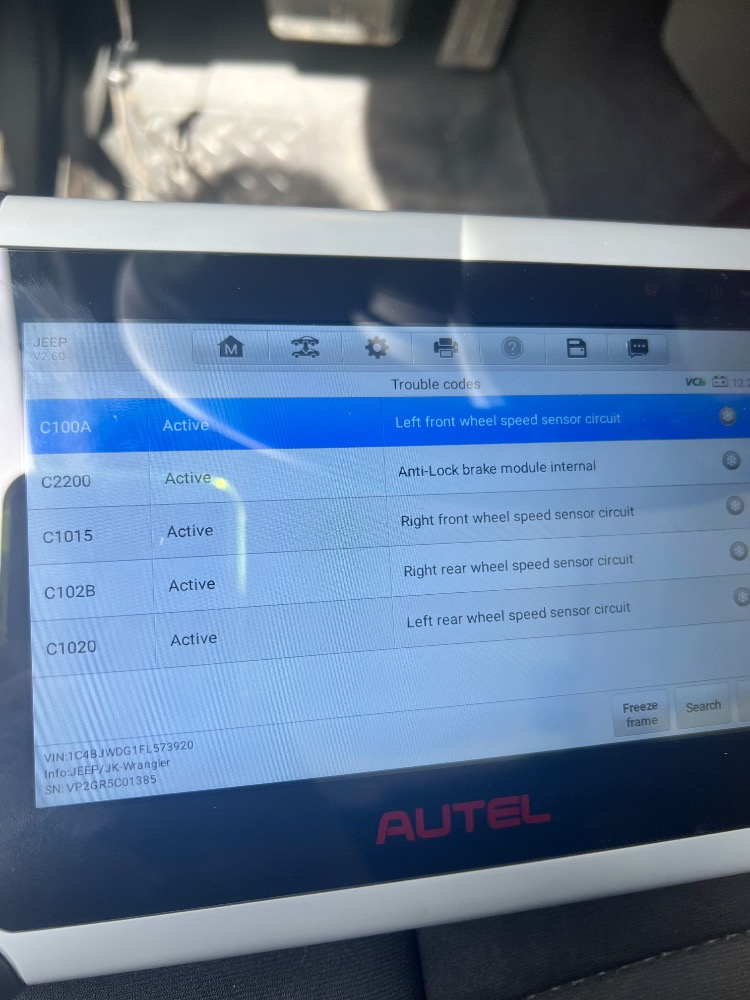

I got a 2015 Jeep Wrangler. I’m about to call an abs module on this but with the part being very expensive I’d want to check if I have missed something.
got codes are in the pic.
shop replaced all 4 wheel speed sensors in hopes to fix it but it was not fixed.
I got 0 activity from all for WSS when driving. I unplugged all 4 sensors and compared voltages and weird thing is I only got 6 volts to all the sensors. Service data says it’s a MR sensor and has a 12v feed. Pluggin them in voltage drops to 0 I’m assuming that’s the abs module shutting down the circuit. Powers and ground to the module tested good. Codes don’t clear they instantly come up after clearing them.
Any suggestions would be appreciated thanks

Have you solved this problem, yet?
I'm sorry that you have not received any replies to this post. Sometime, a post slips threw the cracks and does not get noticed.
As I'm sure that you already know, C2200 is an internal fault. Beyond verifying powers and grounds, there is not much that you can do, except repair/replace the module.
