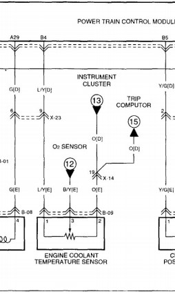

I would like some help to determine the root cause of engine temperature gauge showing high temperature with no other obvious symptoms of overheating.
I believe it is a bad ECT sensor but not 100%
I normally would DIY - but no longer have access to all my tools required. (Divorce sucks btw) (I am learning to "embrace the suck").
I would like to verify or refute my guess for the requirement to replace the Engine Coolant Temperature Sensor 2003 Kia Sedona VIN: KNDUP131436428078

Upon reading my old mitchell diagrams on this ECT it was drawn as a potentiometer, so i followed the wiper thinking that was the signal wire but it goes to ground. So now i'm thinking this picture is wrong. I'm flipping through the years and I'm up to 2006 kia sedona and the picture makes more sense. There's TWO variable resistors !!
I think this explains why your engine computer reads temp as normal and the gauge one is out of wack.
Try a bypass test. With KOEO, what voltage is on the orange wire? With it disconnected? Short it to ground and see what the gauge does in the cluster.
imgur.com/a/sjFx8O6
imgur.com/a/sjFx8O6

I'm with BobbyM - if your coolant temp sensor has three wires, then there's absolutely two sensors in there. One for the gauge, one for the PCM. I also agree with a bypass test to establish if the circuit and gauge are good. If this gauge plays by the usual rules, then it's pretty darn straightforward.
KOEO, with the gauge reading 50%-ish, disconnect the sensor. The gauge should go all the way hot or all the way cold. Some gauges move slowly, so give it a minute. Now find the wire for the gauge. Orange, if BobbyM's diagram is correct. I'd look on BBB Industries, but they're updating their database right now.
Disconnected, it'll likely read around 10-12 volts. Short it to ground and see if the gauge moves the other way.
If it does, you're done! Sensor time. The wiring integrity and gauge are good.
