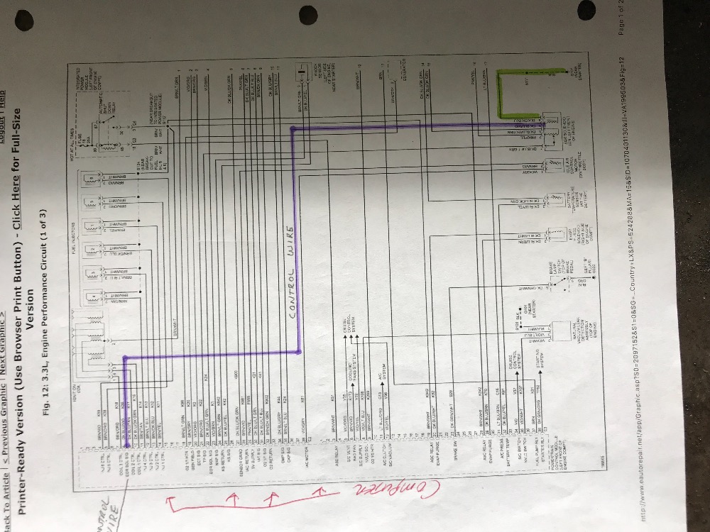

So herein is a follow up to this following issue with this vehicle:
I proceeded to test the computer driver and the control circuit integrity.
The control wire is dark blue/violet
ground = black/dark blue
But before this test, i tested the egr with test light connected to 12v touching on the control wire and i could faintly here something click.
I proceeded to use a jumper wire instead and I head an audible clicking from the egr to the throttle body of the vehicle. I don't know why that
was. So I think that tells me that my egr is working right?
Next, when I proceeded to test the integrity of the driver and control, unplugged, test light to ground, the test light did not light. I turned the
car on, and proceeded to rev it to see if I could duplicate the conditions, and negative. nothing. no light lighting.
What have I done wrong? Because I did the test just like the book suggested with no results. What's burned? The driver or control?
thanks fellows techs.

7 years 9 months ago #25744 by Mechanic 350
Herein is the diagram I’m working with:

7 years 9 months ago #25747 by Mechanic 350
The circuit that I'm working on is power side switched.
I just did the test you suggested, and indeed the pcm is showing control.
unplugged, test light to B+ = test light lights. I heard clicking sounds.
unplugged, test light to ground = test light NOT on.

7 years 9 months ago #25754 by Mechanic 350
I connected my light to ground and T-pinned the control wire, dark blue/violet, and
the light should have lit, indicating driver control and control circuit integrity. I have neither. I've hit a brick wall. don't know what to do next. taking a mental break. thanks Monde.

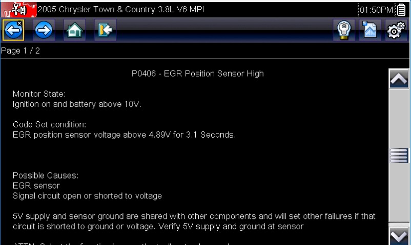

7 years 9 months ago #25816 by Tyler
Not trying to butt in here, but are we sure we wanna be chasing a solenoid control issue? :huh: I had a look at the Snappy Troubleshooter for this code, and this is what it had to say:
Above 4.89V for three seconds represents an open potentiometer ground, an open signal wire, or an open potentiometer. Since you've already figured out how to run a bypass test on the solenoid, I'd be curious to know if you can make the code happen by cycling the solenoid wide open while watching the potentiometer signal voltage.
