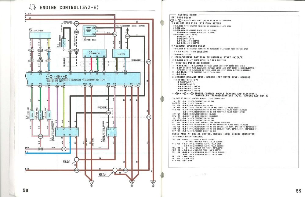

I found this excellent wiring diagram. Now I am trying to relate the numbers on the ECM to the actual pin locations, and in what bundle.

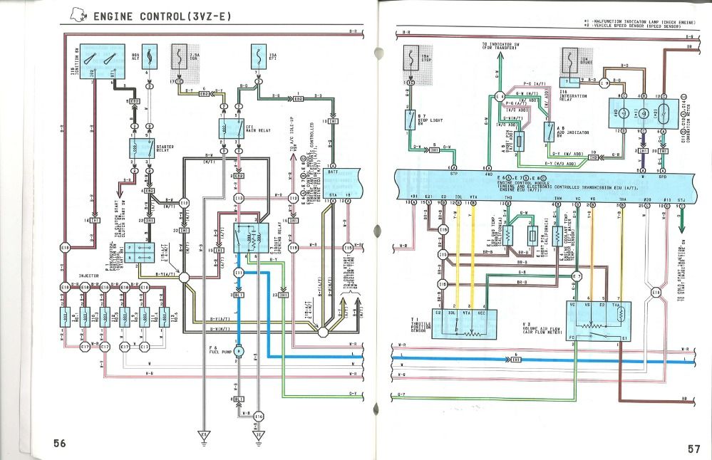

I took a connector harness off an injector, turned the key to on, and checked both wires in the connector. I get 12v on BOTH.
I next checked the 4 wires out of (or maybe into, I don't know which) the distributor. Key on, no volts on any wire.
Checked the resistance of the injector. 14 ohms.
I am plenty baffled. I am attaching what I believe to be the correct wiring diagram for this engine. All of the wire colors and number of wires in connectors (that I could see) are in agreement with this diagram.

Unplug all the injectors before checking both wires at the plug, just to be sure you're not getting feedback from the others.(just looked at that wiring diagram, they share a common positive but 3 joined together at a time for triggering so there will be feedback of 12v on the trigger wire
of the one you unplugged)
Also: You state that there is no check engine light since the problem started - does it not even come on for a second when ignition is
turned on? This could be one of those rare cases where the ecu has failed. You need to check all your ecu feeds to make sure.

I think the lack of voltage to the distributor is interesting --- I will have look over the wiring diagram
But to clear up the 12v on both pins at the fuel injectors
Engines produced before the mid 1990s usually bank fired the injectors in groups, so when only one injector is disconnected 12v on both pins on a injector plug is normal key on engine off. You need to crank the engine with the test light connected to a test light and watch for the test light blinking.
My preference in this case would be to back pin test light.
Bank firing fuel injectors was a hangover from early electronic gasoline injection systems and goes back even earlier to 1950s 1960s mechanical fuel injection. In bank firing depending on the number of cylinders 2, 3 or 4 injectors are fired at the same time. The fuel hanging as a cloud in the inlet manifold runner until the inlet valve opens. It is a bit like a wasted spark iginion system but for fuel injectors.
