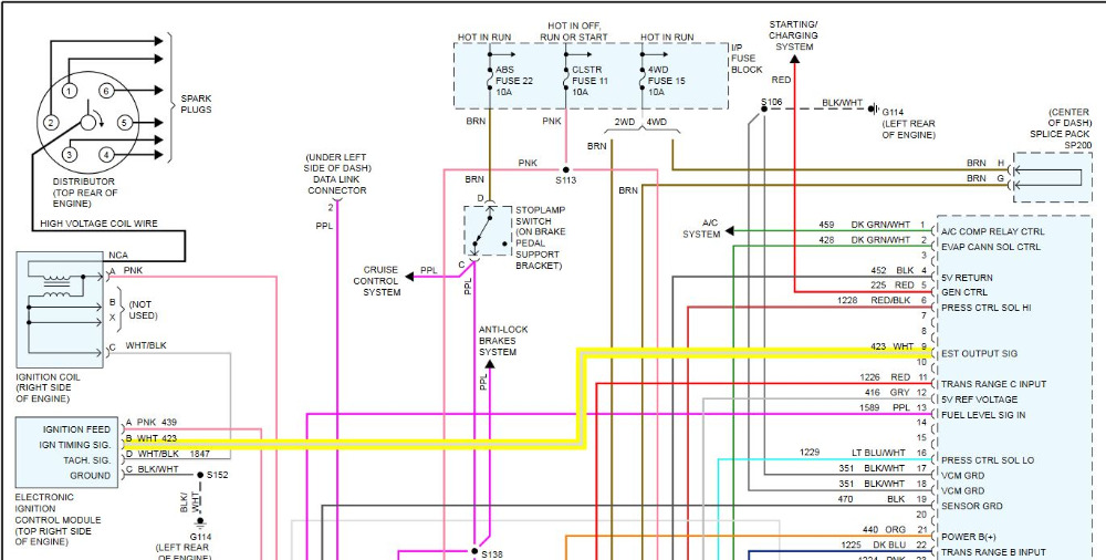

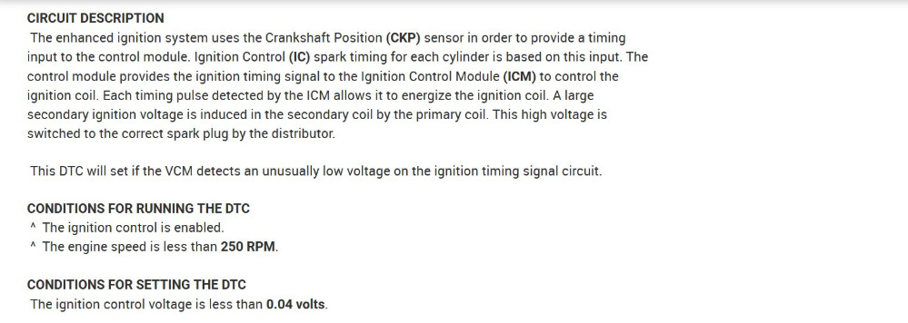

The pass-lock system will disable the injectors after 1 to 2 seconds. It will start, then stall. It does not disable spark. Do you have spark? Do you get the "Start, Stall"?
I ask because security codes for pass-lock are B codes.
P1361 Is an ignition code.
