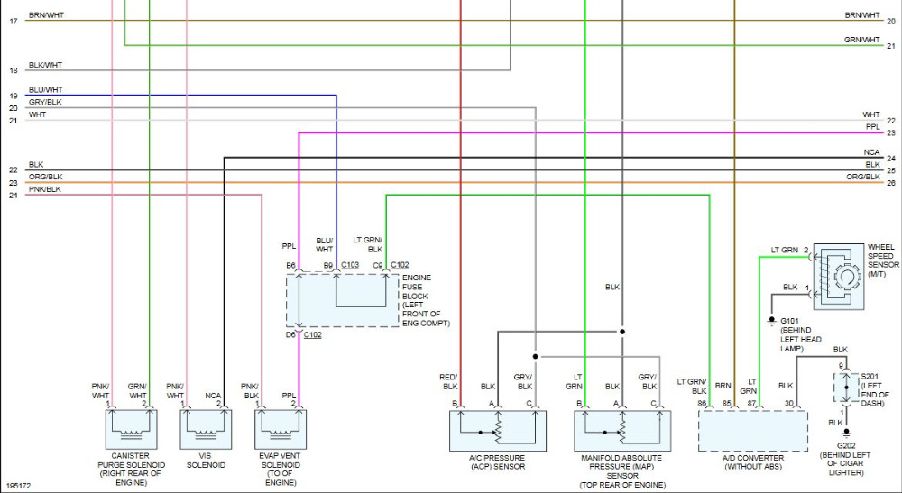

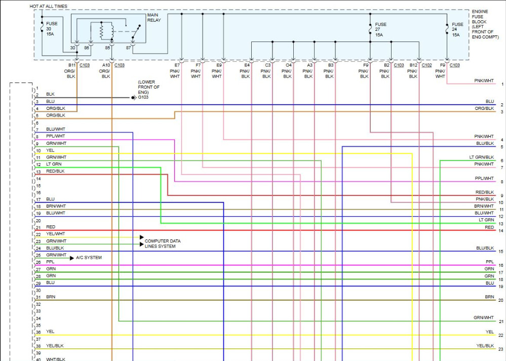

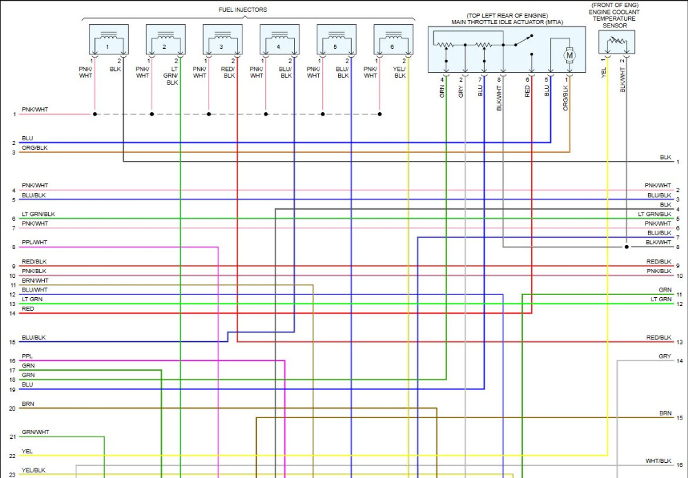

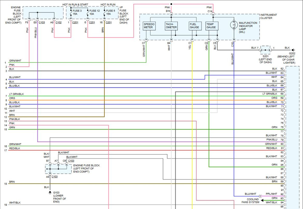

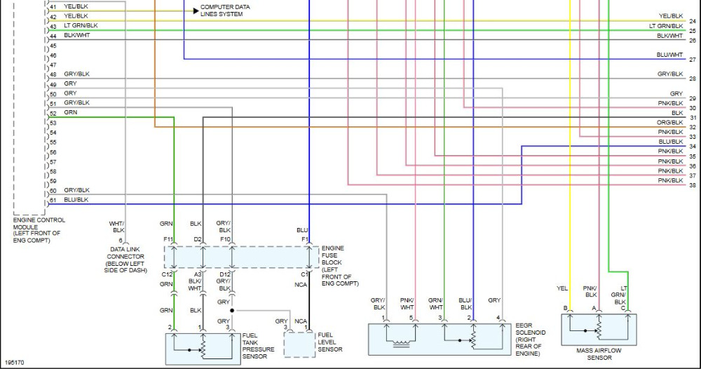

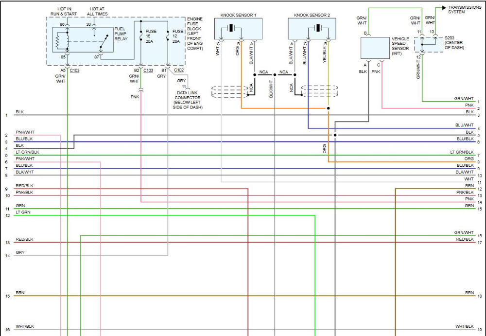

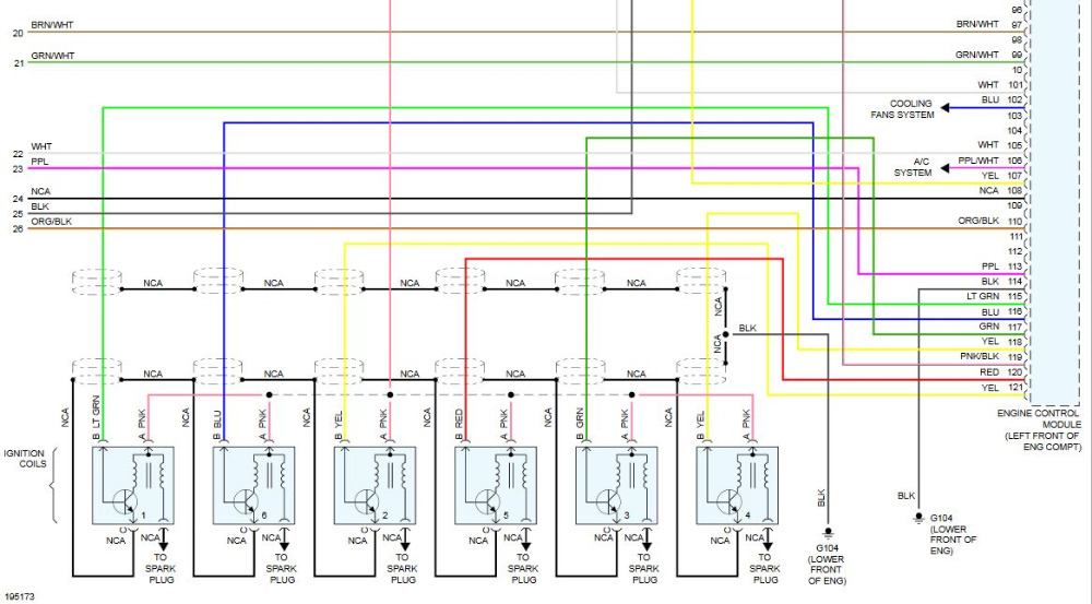

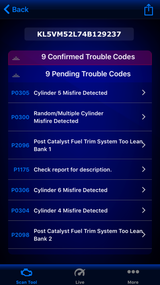

I have a 2004 Suzuki Verona 2.5 with a no start issue. I did discover that the 12v and ground in the coil pack wires are shown to be common. If unplugged from the main wiring harness they are not. So I know the problem is from the computer to that point of the harness. I can’t find any wiring diagram for that car specifically tied to the coil pack/fuel injector wiring harness. I will attach all stored codes that I was able to pull up also.

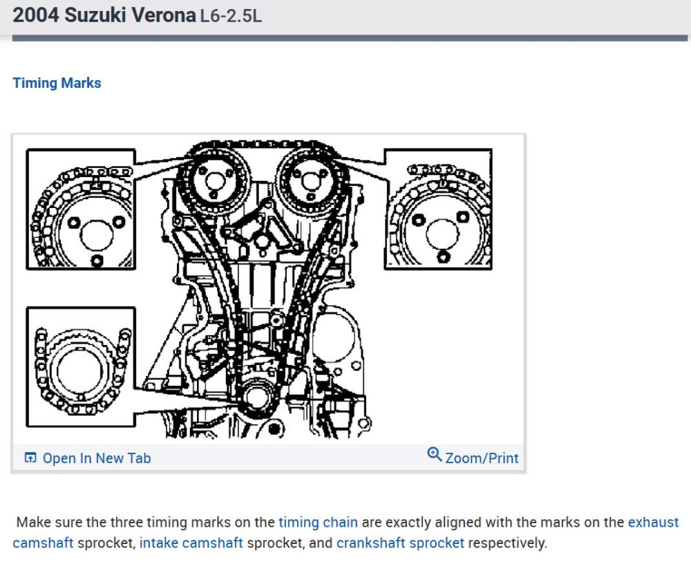

Anyway I can get a diagram of the timing mark placement? I have two diagrams one showing different from the other?? One diagram shows the cam marks to be at 10&2 and the crank and 6. The other says both cams need to be at 12 and the crank at 6. Either way, the car at #1 TDC the timing marks aren’t either. So the car is out of time and need to confirm which timing is correct. Tyvm
Tim
Tim
