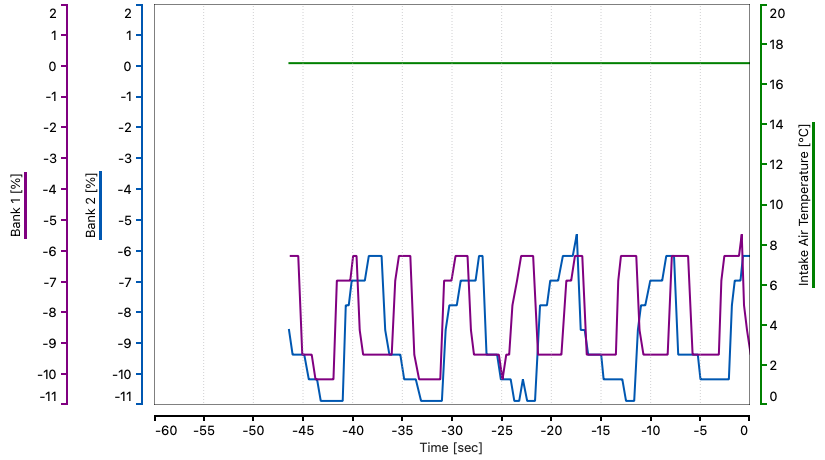

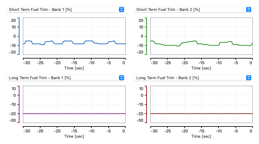

Thank you Noah for the answer.
The signature shows a deep understanding of automotive life)))
Regarding oil saturation with fuel and EVAP reservoir, it is logical.
Of course, the MAF sensor and the adjacent parts are installed accordingly.
With the original old MAF sensor, spark plugs, injectors and catalytic converter, the engine's behavior was basically the same, only less fresh, so to speak.
However, as I described, the van accelerates and drives perfectly, with reasonable fuel consumption. While driving, the STFT and LTFT parameters are constantly monitored using the Forscan mobile application.
And here's what's interesting. If the engine is running under load while driving, constant or increasing, the parameters are normal, i.e. each of them is less than 10 percent. But as soon as the engine goes into idle mode or load reduction, the negative numbers begin to grow.
And another interesting point. If you forcibly engage only the first gear and accelerate the engine while driving to 2-2.5 thousand revolutions, and then suddenly release the accelerator, the van drives for some time without releasing the accelerator, about a second and a half, while the STFT correction numbers approach 0. Together with reaching zero, the efficient operation of the engine abruptly stops.
The graphs of several throttle position readings strictly follow the actual accelerator pedal position. And only the graphs of the EVAP valves match the engine behavior.
From this we can conclude that there is indeed an excess of fuel in the transient mode. What I described in the original post - when dropping high revs while not moving, there is a pop in the muffler.
Also, every time the engine starts, even when hot, it runs at high revs, about 1000 about 5 seconds. And the drop in speed coincides with the start of the STFT readings. Perhaps it is just a row, but not together. To be honest, I don't remember whether this was the case with my previous exactly the same vans or not.
Before proceeding to further steps of electronic diagnostics, I will replace the injectors with BOSCH, fortunately, Rockauto offers them now at a reasonable price. And at the same time, I will measure the engine compression.
Updates will follow.
P.S. At the moment, there is no check engine light. It went out today, but the ECU still contains the code P0172C and in another section P0172 and P0175.
Let me thank you Noah again for your help.

I am attaching a freeze frame and asking for help.
I have an extended version of Forscan, the correct cable for it, OBD WIZ Windows app, OBD Autodoctor Mac, OBDLinkMX+
Thank you in advance for those interested and those who respond.
Freeze frame
Confirmed Diagnostic Trouble Codes
-P0172: System Too Rich Bank 1 (Powertrain, Generic)
-P0175: System Too Rich Bank 2 (Powertrain, Generic)
Pending Diagnostic Trouble Codes
Permanent Diagnostic Trouble Codes
Freeze Frame #0
-Fuel system status / Fuel system A: Closed loop (1)
-Fuel system status / Fuel system B: NA
-Calculated engine load: 26.3 %
-Engine Coolant Temperature: 72 °C =161.6 °F
-Short Term Fuel Trim - Bank 1: -18.0 %
-Long Term Fuel Trim - Bank 1: -20.3 %
-Short Term Fuel Trim - Bank 2: -17.2 %
-Long Term Fuel Trim - Bank 2: -20.3 %
-Engine RPM: 652 RPM
-Vehicle Speed Sensor: 27 km/h=16.8 miles/hour
-Ignition Timing Advance for #1 Cylinder: 16.5
-Intake Air Temperature: 6 °C =42.8 °F
-Air Flow Rate from Mass Flow Sensor: 7.23 g/s
-Absolute Throttle Position: 14.9 %
-Bank 1 - Sensor 2 (O2S) / Oxygen Sensor Output Voltage: 0.740 V
-Bank 1 - Sensor 2 (O2S) / Short Term Fuel Trim: --
-Bank 2 - Sensor 2 (O2S) / Oxygen Sensor Output Voltage: 0.740 V
-Bank 2 - Sensor 2 (O2S) / Short Term Fuel Trim: --
-Auxiliary Input Status: Power Take Off: Not active
-Time Since Engine Start: 4 min 21 s
-Commanded Evaporative Purge: 0.0 %
-Fuel Level Input: 62.0 %
-Number of warm-ups since DTCs cleared: 1
-Distance traveled since DTCs cleared: 130 km = 81 miles
-Evap System Vapor Pressure: 111.3 Pa
-Barometric Pressure: 97 kPa
-Bank 1 - Sensor 1 (wide range O2S) / Equivalence Ratio (lambda): 1.051
-Bank 1 - Sensor 1 (wide range O2S) / Oxygen Sensor Current: 0.08 mA
-Bank 2 - Sensor 1 (wide range O2S) / Equivalence Ratio (lambda): 1.047
-Bank 2 - Sensor 1 (wide range O2S) / Oxygen Sensor Current: 0.06 mA
-Catalyst Temperature Bank 1, Sensor 1: 607 °C=1,124.6 °F
-Catalyst Temperature Bank 2, Sensor 1: 607 °C=1,124.6 °F
-Control module voltage: 13.79 V
-Absolute Load Value: 18.4 %
-Fuel/Air Commanded Equivalence Ratio: 1.000
-Relative Throttle Position: 2.0 %
-Ambient Air Temperature: 5 °C=41 °F
-Absolute Throttle Position B: 18.0 %
-Accelerator Pedal Position15.3 %
-Accelerator Pedal Position E: 7.8 %
-Commanded Throttle Actuator Control: 3.5 %
-Alcohol Fuel Percentage: 5.1 %
Diagnostic information provided by OBD Auto Doctor
Get the engine to reach about 190 degrees and see if the MAF grams per sec drops to 5.4 or close to it. I wonder why the equivalent ratio for both wide band sensors show 1.051 and 1.047 when the commanded ratio is 1.000. Both front sensors report a lean mixture while the rear o2s report a rich condition Have you checked the accuracy of the front sensors by driving them lean and rich? Let us make sure that the sensors are reading accurately before going further.
