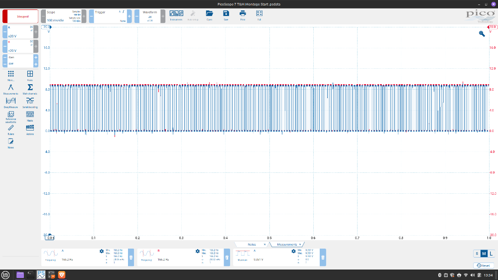

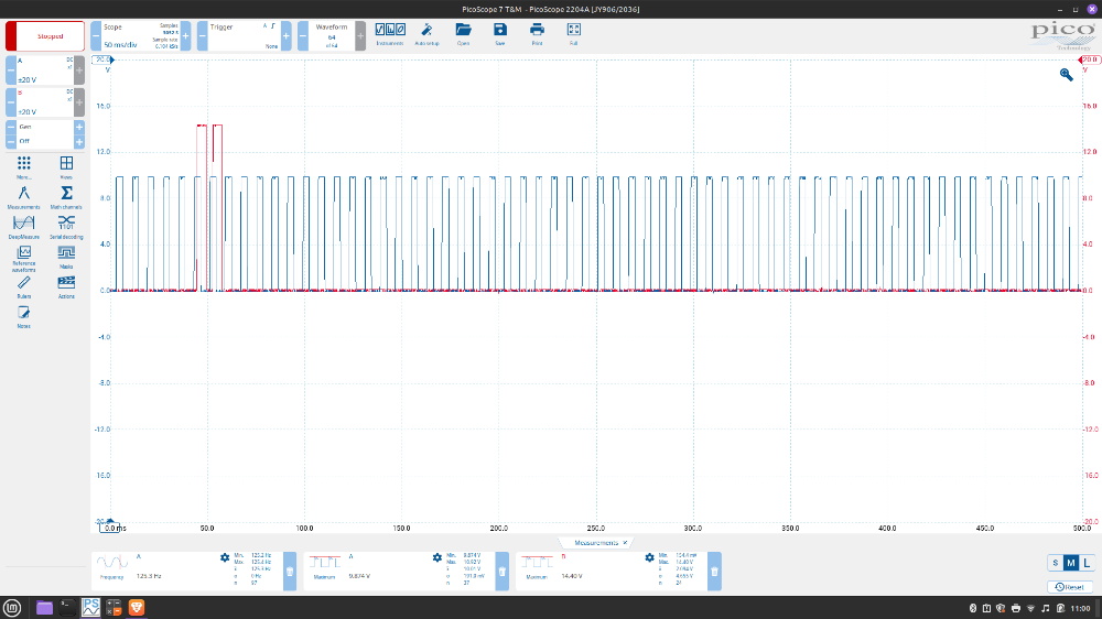

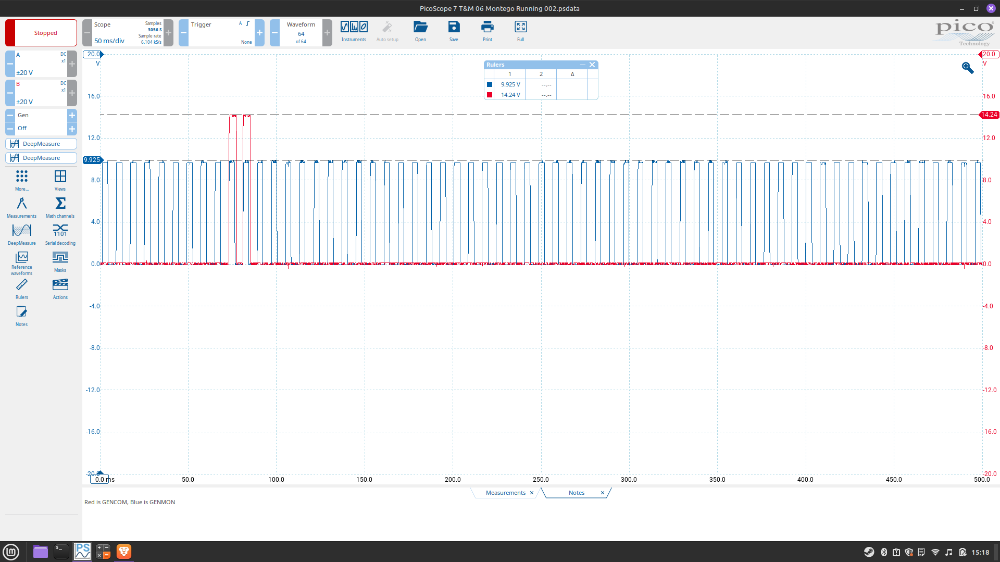

Here is a poorly captured screen shot from my basic PICO. The BLUE trace is the GENMON, RED is GENCON.
This seems capture to be pretty normal to my untrained eye.
2 things I note, when I add a bunch of electronic loads it appears the alternator cannot quite keep up, its desired voltage is say 14.2 but im only getting 12.3-12.6 ish.  Also I note the GENMON line is only around 9.5 volts on the peaks, and I see the other captures in one of those threads listed above as well as the SMA video seem to show the GENMON is a pulsed battery voltage or close to it.

I assume GENMON is a pulsed PWM from the voltage regulator, is this correct?
Correct! The PCM provides voltage on the GENMON line, and the alternator pulses it to ground as a load indicator.
is it safe to assume this GENMON PWM should be at or near battery voltage on the high end of the trace?

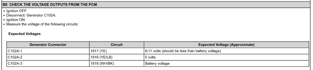

Probably? I tend to think the (nearly) 10V you saw on your GENMON is enough amplitude to create a satisfactory signal for the PCM. Plus, your resistance check on GENMON passed. This part of Pinpoint B from service info seems to think 8-11V is OK:
I think the answer would be to monitor the GENMON PID in scan data. If you're seeing a pulse width signal with the Pico, but the GENMON PID either says 0% or 100%, then there's a problem. If the GENMON PID agrees with the signal you're seeing, don't sweat the amplitude and move on.
I did start going through that pinpoint B testing procedure, I assumed that 8-11 volts was the bias on that wire, as with the alternator connector unplugged the GENMON reads 8.75 and will not light a test light.

Frequency of the PWM is 125 hz
All this was done under load and at idle.  I believe the fusible links and wire integrity is good at this point.
I also shorted the GENMON and GENCON wires together with a 10a fused jumper and they mirrored each other as they should.  The only thing I noticed again is when tied together both are maxing out around that 9 volts.  Where as when it is running the GENCON is 12 v and the GEN MON is 9 ish volts.  I dont know if that means anything, probably not.
(PIcs get degraded for some reason, this was mirroring itself at 166 htz)

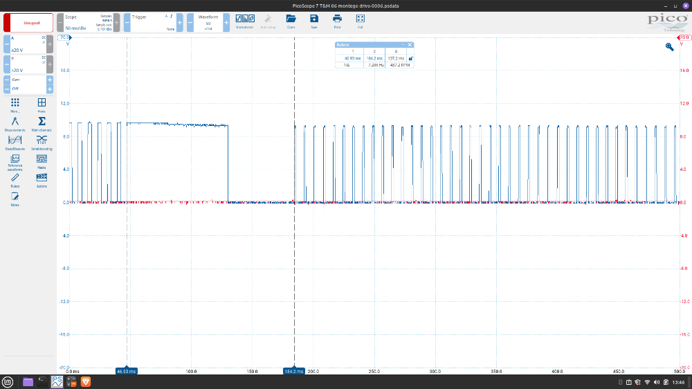

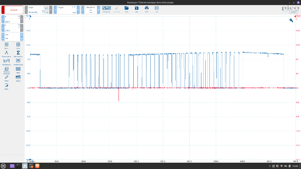

Upon actually test driving the car, I noted a significant misfire/poor running only when going up an incline, lugging the engine around 1500 RPM in a high gear.  This was very similar to PHAD Ivan's video listed above. However, the alternator would not quite stop charging for me. In fact the alternator was communicating perfectly at all other times, except when this significant misfire would occur.
We can see that the voltage regulator on the GENMON (blue) trace, actually stops communicating/pulling the PCM voltage to ground during the misfire event. This was very consistent and repeatable.
I believe that at times when the miss became a bit worse (due to driving habits, fuel quality, or some other engine dynamic varible) the regulator would shut down all together and thus stop charging the vehicle.
Customer states she had no idea if or when spark plugs were changed so I pulled one from the front bank, and they were the worse plugs I personally have seen. Spec gap is 0.054" and these were worn nubbins that measured .090-.095".   I replaced the spark plugs and test drove it for over 100 miles in varied loads and conditions and the alternator/regulator never missed a beat!
