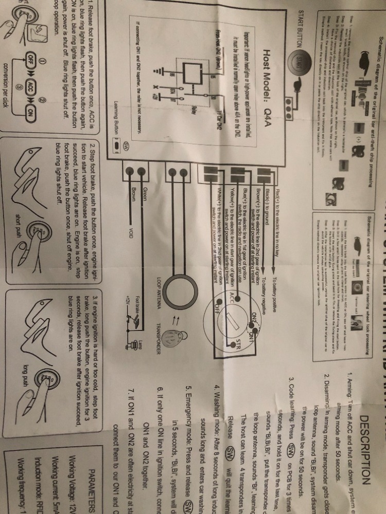

96 Honda Civic DX 5 Speed all manual won't start or crank. was created by Infinity
I have a Civic with all manual windows, locks, power steering and etc. There is close to no extra wiring. The problem I have is that it wouldn't start one day. It will prime fuel pump and lights all come on normal but as soon as I go to start the car; all power cuts off. Doesn't crank or even try to. Battery was bad; replaced it. Starter was bad; replaced it. Checked the pads on brake and clutch and nothing changed. Have checked main fuses controlling ignition and none of them are blown. Even replaced key cylinder as well hoping it may have been a short. Honestly at this point I'm running out of ideas. Would love some hints on what to check next and locations on where like the main relay if that is also a possibility. I did check volts but I'm today im going through it all again since I have replaced so much already. Any tips at all will be greatly appreciated in the meantime!

I have attached a diagram of the starting system for your car.
I think the easiest first step would be to check power at fuse 31 and 49 in the under hood fuse box if you haven't all ready
Replied by Noah on topic 96 Honda Civic DX 5 Speed all manual won't start or crank.

Replied by Infinity on topic 96 Honda Civic DX 5 Speed all manual won't start or crank.
Thank you for doing that! So after going through everything I had discovered that the battery test I had done at autozone was a false positive. Now I can get the car to turn over with the keyless entry. However now it doesn't want to start. I'm getting a new kit just in case it just isn't working/broke. However my concern is whether or not the keyless entry method will work for the car. It needs to prime the fuel pumps in ACC mode but when it tries to start the car after going into ACC mode it just turns off. When i try to start the car immediately without going into ACC (pushing brake and pushing ignition starts instead of going into ACC) it turns over but doesn't start. I'm wondering if its because the fuel pump isn't priming because it's bypassing the ACC mode. Any advise would be greatly appreciated and thank you for your earlier comment!
I'm sorry, I don't understand what you mean when you say you can turn over the engine with "keyless entry".
I'm not sure what that is, or what kit you are going to buy.
Forgive my ignorance.
I'm glad you figured out the battery the bad was bad though and got a new one. Hard to troubleshoot anything with a bad battery

Yea i'm trying to convert a keyed ignition to a keyless. I bought a new unit which they are just aftermarket keyless entry units now a days. They come with a basic wiring diagram which i can post later if it helps. The only thing I haven't done that you suggested was checking the relay to hear a click. However; I would imagine that it wouldn't crank at all when trying to start from cold right? That's the problem is that the car will crank just fine but won't start. The entire thing started because the original key failed and the car wouldn't do anything when attempting to turn the key forward (hence the keyless swap). I'm starting to wonder if maybe the keyless unit draws too much power from the battery to prevent a clean start up the normal way by going to ACC and etc which might be why it does nothing when it attempts to start that way. I'd ask how to start it with the wires but that's basically asking to hotwire and would be an absolute last resort due to chance at damage. Mind you; the car is all manual (manual windows, door locks, etc) and has no security feature. It's a 96 so it's before the radio security feature. Maybe a better alternative for now is build in a kill switch and a start switch with three phases like a key? See if the power pull is too much? Also what's a good way to check these beauties spark and fuel pressure? Just to rule out the possibility of faulty fuel and spark.

1 year 5 months ago #88612
by Infinity
Included the photos of Keyless diagram and Diagram of Honda.
- Infinity
- Posts: 6
1 year 5 months ago #88635
by Infinity
Went ahead and tried hotwiring. Car turns over but doesn't want to ignite. Gonna check spark plugs and etc next. There has to be another problem somewhere I am assuming. For now i am going to do diagnostics until I find something. However in the meantime; what would be the proper wiring for a 3 switch ignition with a hidden kill switch? I'm assuming battery to all three. ACC on first; IGN 1 and 2 on second and Starter on start?
- Infinity
- Posts: 6
1 year 5 months ago #88697
by Infinity
Ended up checking all spark plugs. All spark fine and are getting power. Tested using inline spark tester. Now i'm down to checking fuel delivery. I'm starting with the pressure first but as far as vacuum goes wouldn't it just hold a stable pressure and not drop if it is a good vacuum? Still haven't checked stuff like the timing belt in hopes it's not something that drastic.
