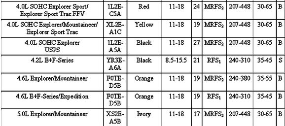

- Posts: 2219
8 years 1 week ago - 8 years 1 week ago #24017
Replied by Chad on topic 2001 Ford explorer lean codes
Last edit: 8 years 1 week ago by Chad.
