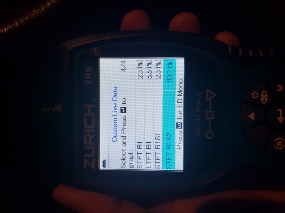

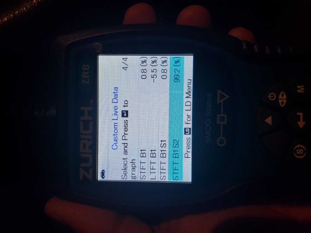

i pulled the fuel rail and checked the operation of the injectors and they seem to be firing fine--no drunken piss type of discharge--i did get a zurich code reader that can do live data here are some screen shots as i couldn't do video and upload it. i am not real familiar with fuel trim, yet, so any further advice is appreciated.

i have seen people use brake cleaner or propane to check for leaks. is there a safer way to test for these? I have a zurich code reader that indicates the maf and map sensors are working. I am getting stft bank1 anywhere from -2.3 to 4.0 and ltft fairly steady around -14.7. I have checked my air filter for any clogs. the o2 senors volts is about 0.795 down to 0.15.

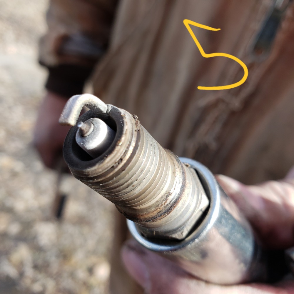

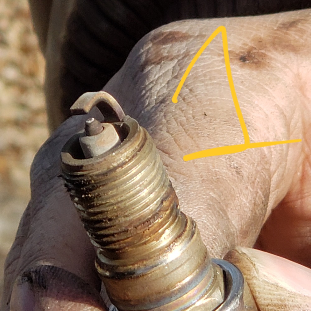

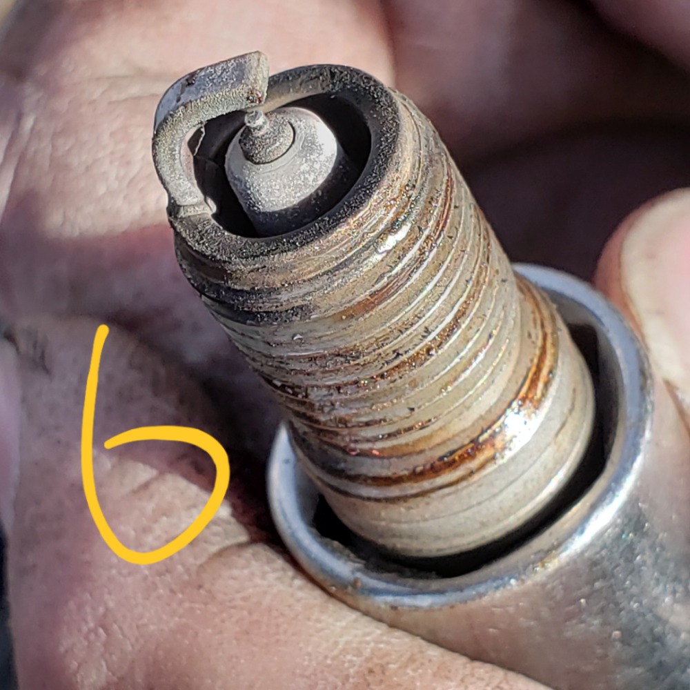

so today i pulled the plugs to see what they looked like and have attached some photos. The 5 &6 look alike and the 3&1 look similar. none of the 2&4 but they looked more like the 3&1. I don't know if these indicate bad injectors but definitely something going on. possibly related to the p172 but not sure. i also looked at the map sensor to be sure gaskets were in there etc. after i got everything back together and ran the engine my assistant shut off the vehicle and i heard a sucking sound coming from the map sensor. i had them restart and shut down again while touching the map sensor and could feel it.when it is running there is no vacuum leak here so not sure what is going on. the pcv did have it's gasket and there was some oil in there but i don't know if that is normal or not.
thanks for the help and suggestons.
