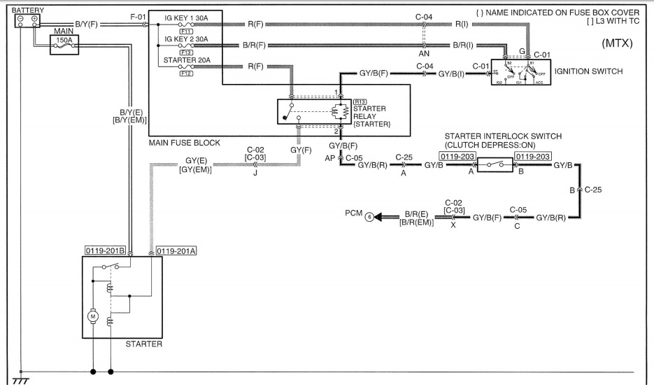

7 years 3 months ago #23698 by Tyler
Two problematic Mazda 3's around here at the same time? We should get the 2005 guy in here, see if we can help each other! :lol: :silly:
For reference, this is the 2007 starting system diagram, manual trans:
I also looked up the 2008 diagram for comparison, it's identical. The jumper wire across the load side was a good move, so we can concentrate on the control side.
Do you recall which pin you saw 6V on? Or, would you mind retaking your readings? A test light would work for our purposes, too. Connected to B-, pin one should be bright. Connected to B+, pin two should be bright in crank only.

7 years 3 months ago #23745 by Tyler
jonkirkross wrote: We tested the battery - to pin 1 when key is in crank and the light illuminated.
When testing the battery + to pin 2 the light did not illuminate at all.
Gotcha, thanks for the clarification! The ignition switch is working. Now we're going towards the shift interlock or the PCM.
Find the clutch switch under the dash and probe both wires with the test light connected to B+, pedal depressed and key in crank. If the switch is good, both wires will illuminate. If it isn't, only one will illuminate. If the PCM isn't proving a ground, neither will illuminate.

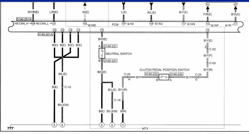

Sweet, way ahead of me. B) It doesn't tell us the PCM is 100% good, but it's at least powered up and talking. Do you have a scanner or code reader, to check communication? While we're on the subject, do you see any kind of anti-theft light on the dash with the key on? Does it come on and go off, or stay lit?
I did some more digging in the wiring diagrams, and found this on the 2008 MY:
This shows two more switches associated with the manual trans option. Neither is the clutch interlock switch we tested earlier - that one is further up on the same diagram. If the anti-theft light come on and goes out, then I'd be tempted to pursue these switches.

7 years 3 months ago #23774 by Tyler
Is the PCM still accessible? I'm tempted to suggest going there next.
Rather than digging around for the Neutral Switch and the Clutch Pedal Position Switch, I figure it's easier to find the signal wires at the PCM connector and check their operation that way. :cheer:
Unfortunately, the OE diagrams don't point out pin locations, or have all the PCM pins in numerical order so we could figure out color sequencing. You're looking for a black/orange wire for the Neutral Switch, and a black/yelllow wire for the Clutch Pedal Position Switch. I know, that doesn't narrow it down much. :silly: I can definitely say they're in the same PCM connector (of the two).
They're both going to be pull down switches, so we're looking for 5V or 12V with the switches open, and 0V with them closed. You may have to work the shifter to make the Neutral Switch work. If both change states while working the clutch or shifter, then I'm gonna figure they're working correctly.

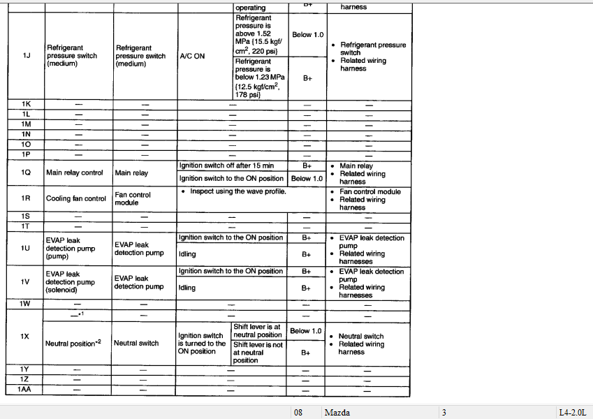

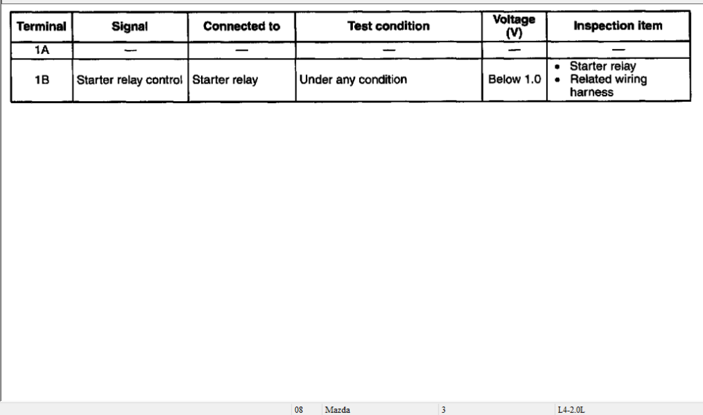

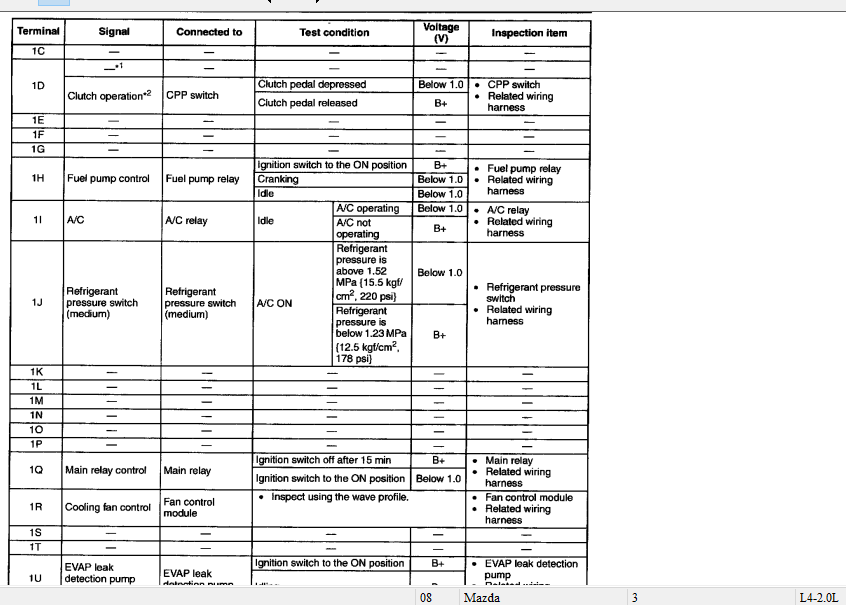

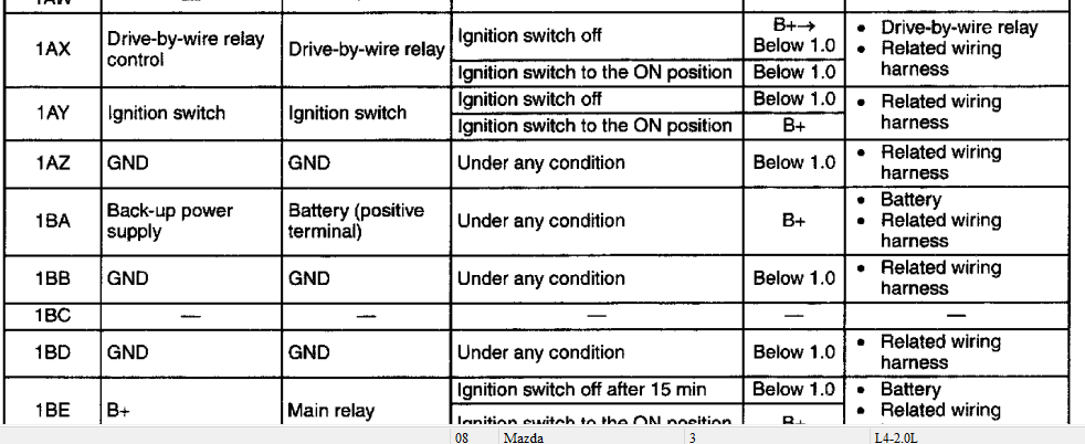

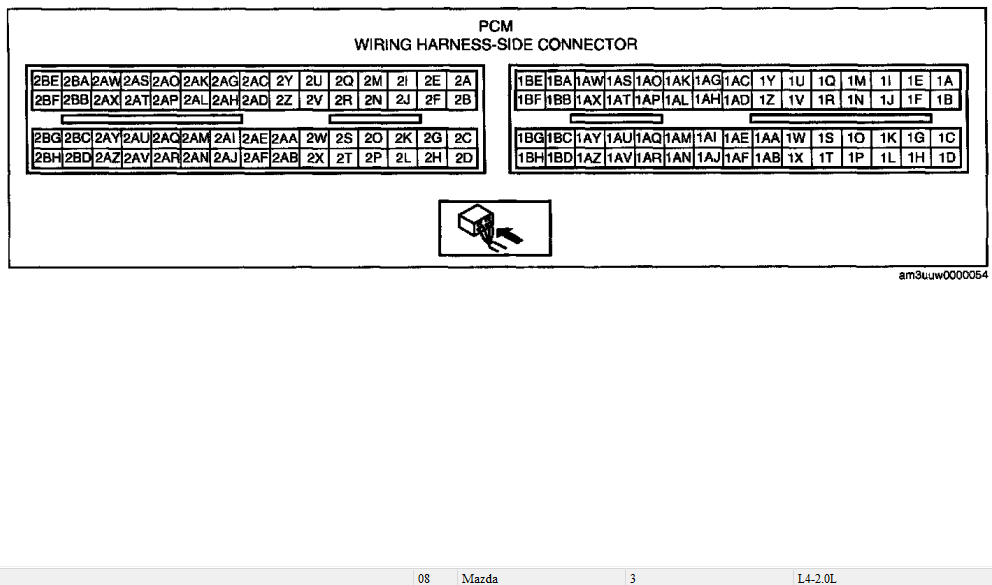

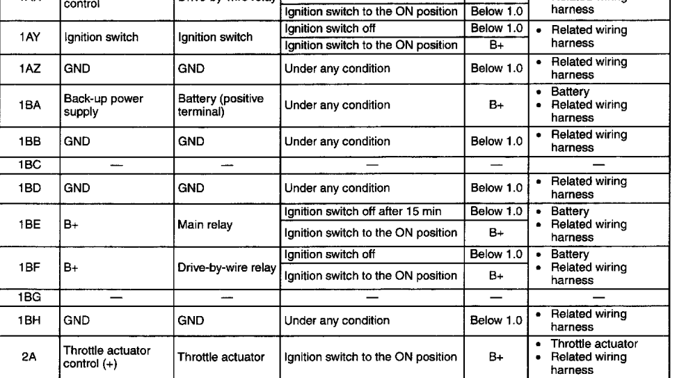

7 years 3 months ago - 7 years 3 months ago #23779 by Paul P.
Am I ever glad the immobilizer is out of the picture, Hope these pics help.
Never stop Learning.
Last edit: 7 years 3 months ago by Paul P.. Reason: Added another photo
7 years 3 months ago #23782 by Tyler
THANK YOU. :woohoo: I was giving myself a headache trying to decypher Mazda's goofy pin numbering system.
Noah was also nice enough to hook me up with an alternative diagram. I'll post it up when I get a chance.
7 years 3 months ago #23783 by Paul P.
Im trying to dig up the inputs Jon needs to start this thing lol!
