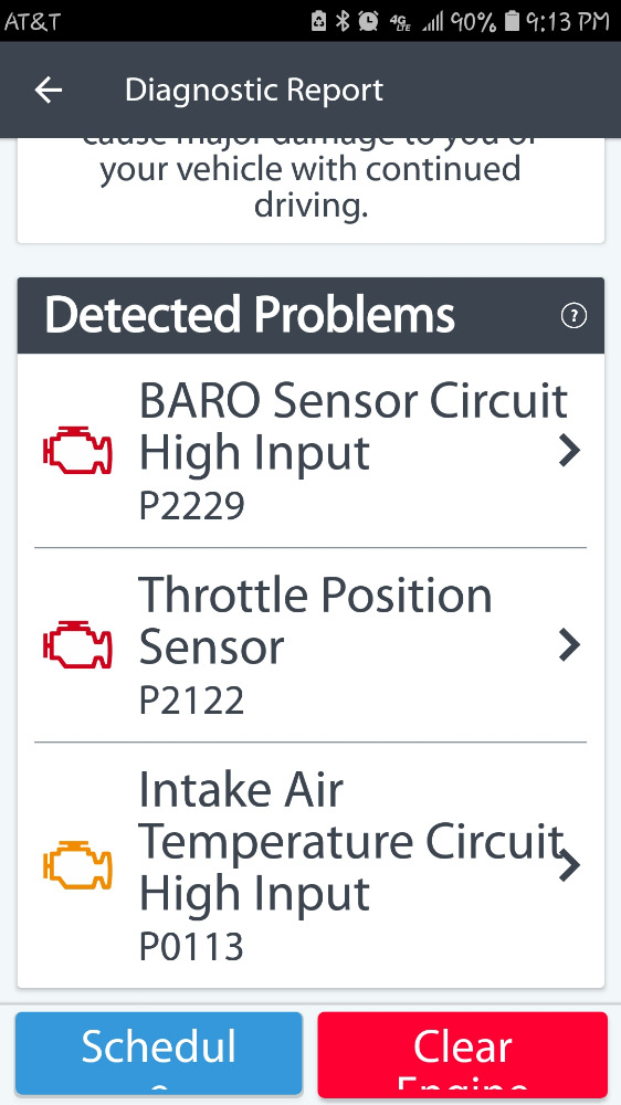

The same code didn't come back(P2138), but other codes showed. Here's the shot of those codes, sorry for not specifying that yesterday.
8 years 2 weeks ago #23797 by Tyler
danield wrote: The same code didn't come back(P2138), but other codes showed. Here's the shot of those codes, sorry for not specifying that yesterday.
Ohhhhh OK! Gotcha. I dunno if I should be disappointed or excited? :silly:
I'd like to leave the jumper in and test for voltage at the MAF/IAT or the BARO sensor, if that's OK with you. Either one, doesn't matter. Check all wires and let me know what you find. :cheer:
I feel like we're still circling around a broken sensor ground wire. :angry:

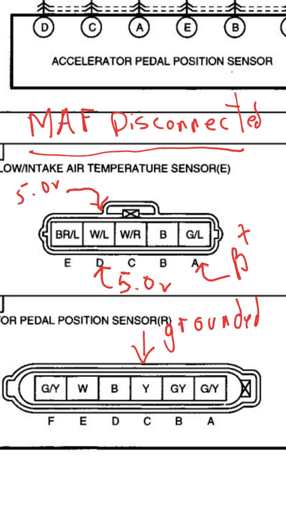

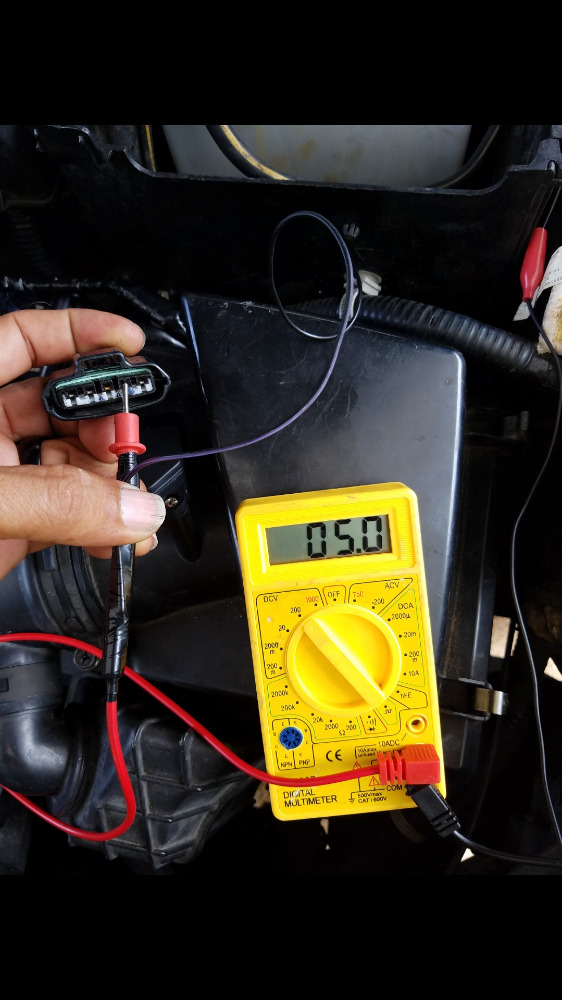

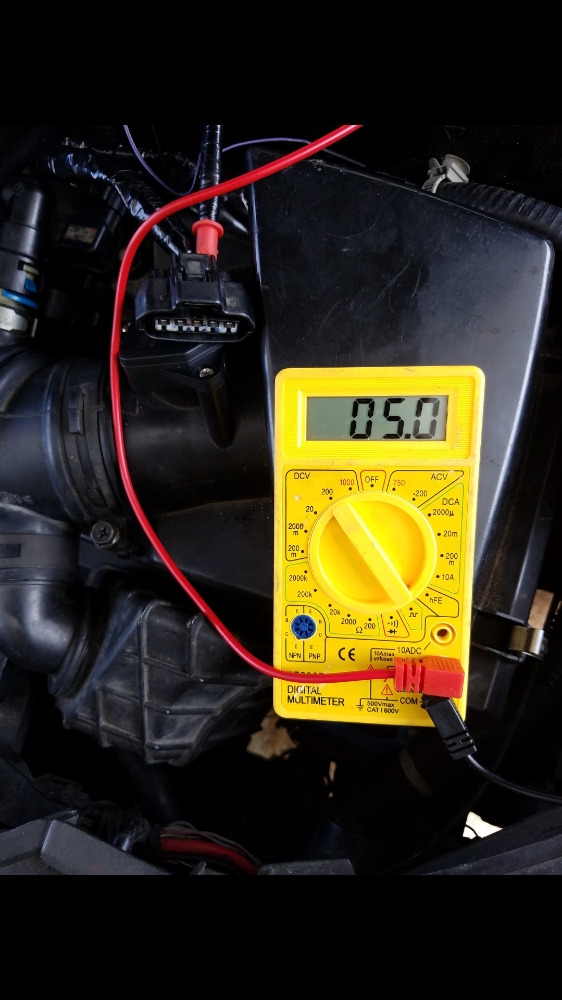

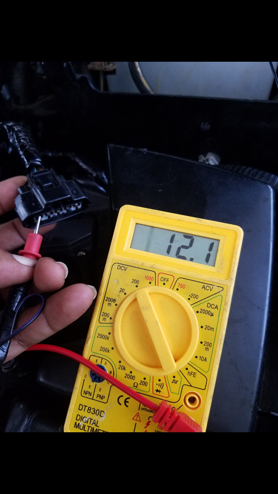

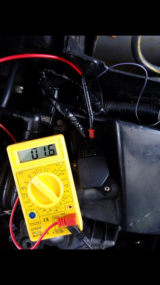

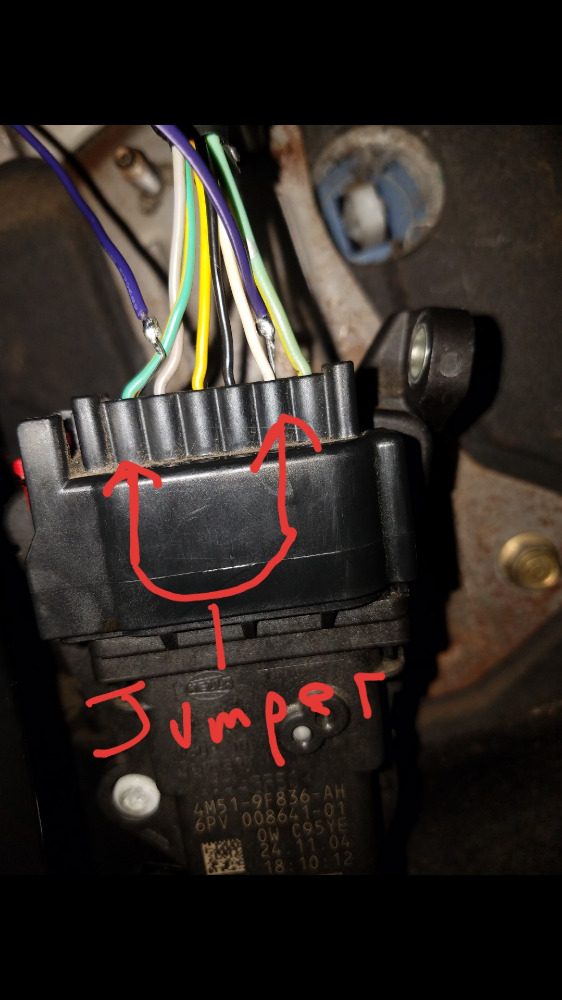

I don't think my harness has the same color wires as the diagram your using. Please tell me if I'm jumping this right. This were the reads at the MAF/IAT with the jumper at the APP.
  • danield
  • danield's Avatar Topic Author
8 years 2 weeks ago #23807 by danield
If they're wrong, please tell me where to put them.

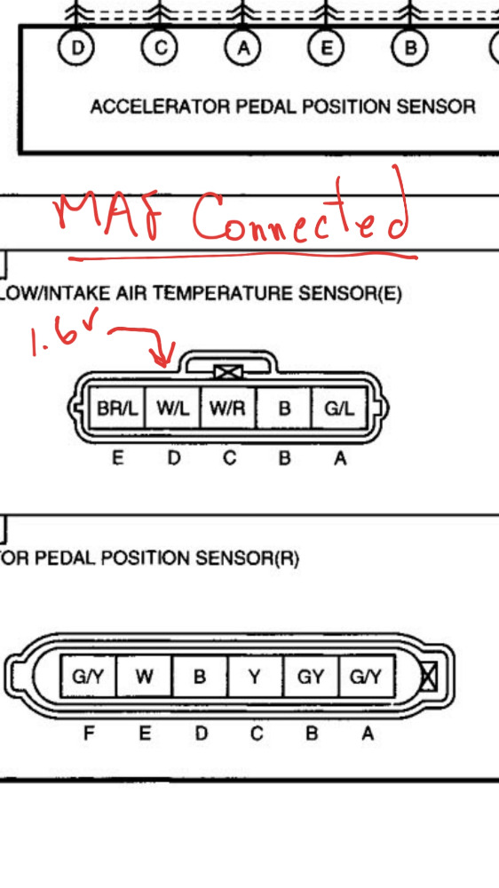

8 years 2 weeks ago #23813 by Tyler
The harness doesn't match? :huh: I'm pretty sure it's the same... Here's the OE diagram with pin colors and positions in the connector:
The colors and positions seem OK to me?
It looks like you've got the white jumped to the green/yellow? Remove that and instead jump the solid yellow wire to ground. The battery negative post would be best, but that'll likely involve several jumper wires. :lol: A body ground would likely work, if going to the battery isn't possible. One of the brake booster studs, or the door latch striker are usually good candidates.

8 years 2 weeks ago #23814 by danield
This jump was the only one different, the first reads were from the right black to yellow jump. I'll put them back and try again.

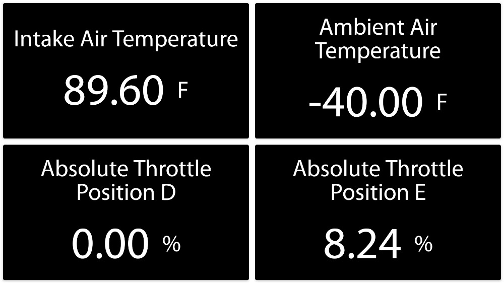

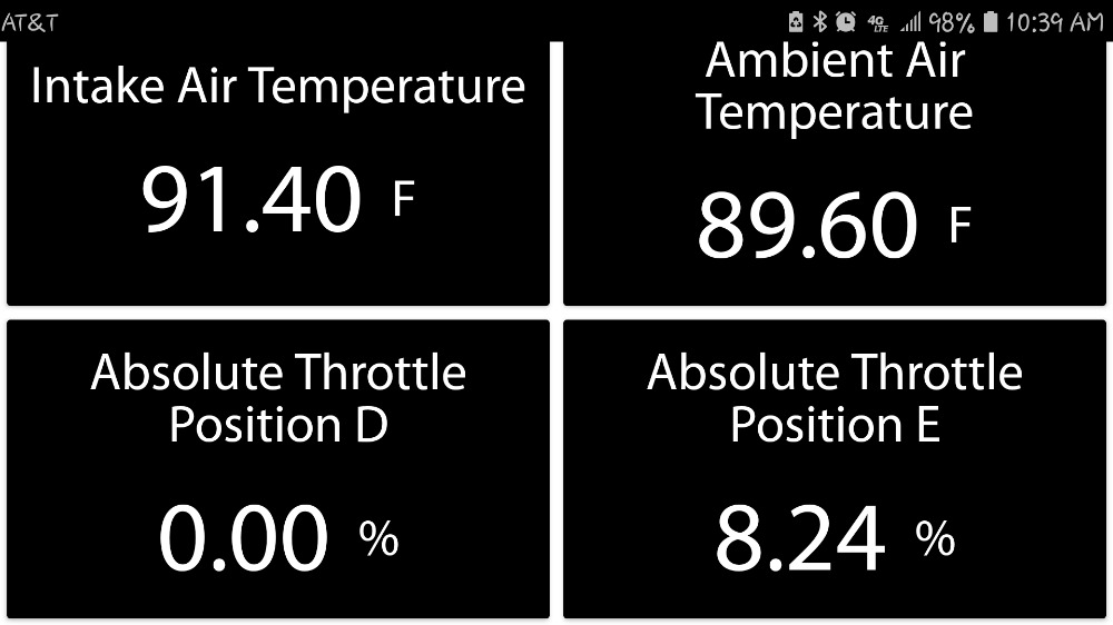

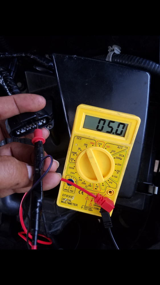

8 years 1 week ago #23833 by danield
Ok, here we go again. The live data is with KOEO and KOER, look at how that temperature changes to freezing -40°when the car is on. Now, the yellow wire is grounded to the battery negative. Here are the screenshots of the voltage reads with KOEO.

Tyler-correct me if I'm wrong, but the IAT sensor -40F is this bias voltage or "limp home mode"?
