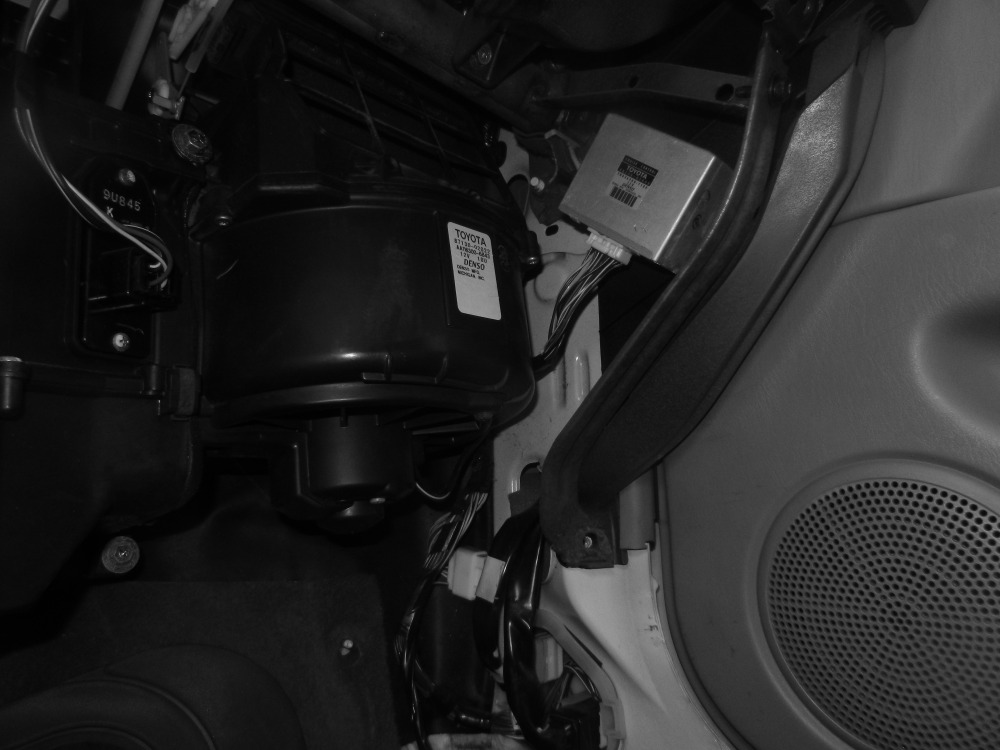

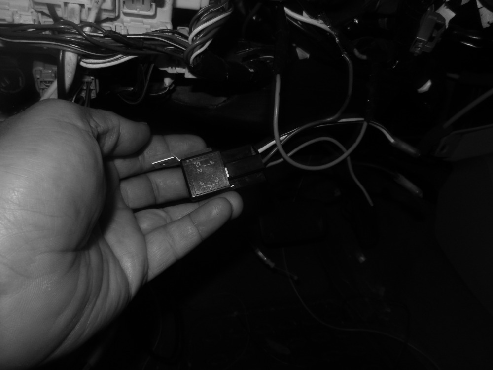

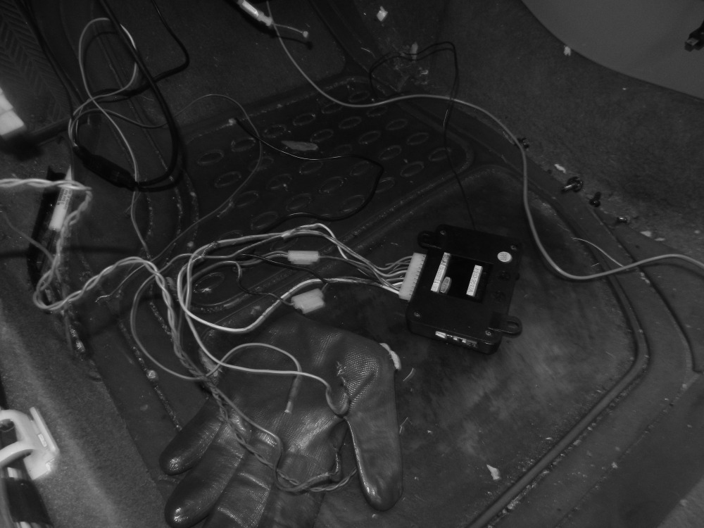

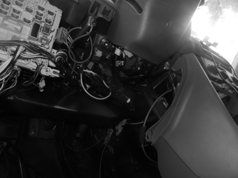

What shut down the car's computer was not the fuel pump it was reading 50 lbs while cranking.
It was an after market alarm and remote system I never new existed. My foot hit a toggle switch on the foot panel and some how it was activated even though its wires where found cut off however the power pak and my foot trips the modules logic circuits.
All relays ohm and tested under load.

[attachment=after market relay spliced was removed not certain if it belonged/attachment] [attachment=aftermarket alarm removed/attachment] [attachment=computer home[/attachment] [attachment=passenger side modul.JPG[/ dash yelow wire spliced between 2 red wires where a relay was found it was removed[/attachment]

It was an after market alarm and remote system, I never new existed. My foot hit a toggle switch on the foot panel and some how it was activated, even though found 2 wires cut off; however the power pak and my foot trips the after market module's logic circuits into anti-theft mode shutting the cars fuel pump; no spark and no injectors.

Removed after market devise and re-spliced original wires and sealed open insulation. New symptom no power to crank n cam sensor; crank does read 2 ref volts; cam reads 000 on signal n power wires with reverse polarity indicator on meter?
