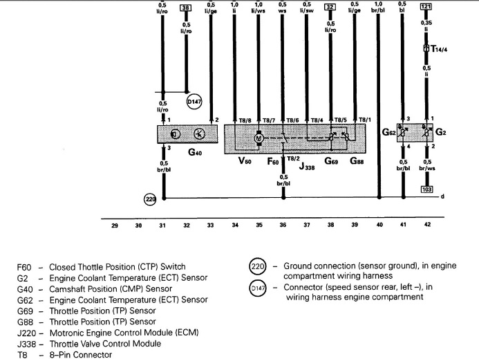

Hey guys I am back with another head scratcher. I have a 01 VW Beetle with a 2.0 with a AVH engine code. This started about a month ago when when the car went into limp mode and I scoped the TPS and it was very erratic so he (customer) changed it about a moth ago and now it has a 17950 or a P1542 code. g187 not a plausable signal. Here is where I am having trouble when I scope both sensors in the throttle body I have nice clean symmetrical signals with no drop outs or glitches, when I turn on peak detect the signals have alot of hash but seem to coincide with each other. Peak detect on I have voltages spikes up to 8 volts like I said before with no peak detect its steady and smooth. The other concern is the throttle body motor has a high pitch whine sorta like a hair dryer I am not sure if this is normal but I never heard that on any other DBW system.

Yep, you guessed it, wiring diagram:
The plausible signal code kinda makes me wonder about F60, the closed throttle position switch. It makes sense to me that if your throttle potentiometers were sweeping normally (which is sounds like they are), but the CTP was saying the throttle is closed, then the computer would set a rationality code like this P1542.
Also wondering about the motor noise you described... Can you make the throttle plate sweep closed to open with the gas pedal? It honestly sounds like the motor is jammed up or binding, maybe disconnect the throttle body and try moving the plate manually, see if it swings freely.

Thats weird I did not see a CTP on the diagram I have from Mitchel or Snap On Guided component tests. I will defiantly look tomorrow. The throttle blade moves nice with no binding or anything with the gas pedal.

That is weird. I pulled up the component test info on my Verus and it shows a 6 pin connector. No mention of a closed throttle position sense circuit.

Did you every verify the presence of a CTP pin on the connector? Just curious, doesn't really matter at this point.
