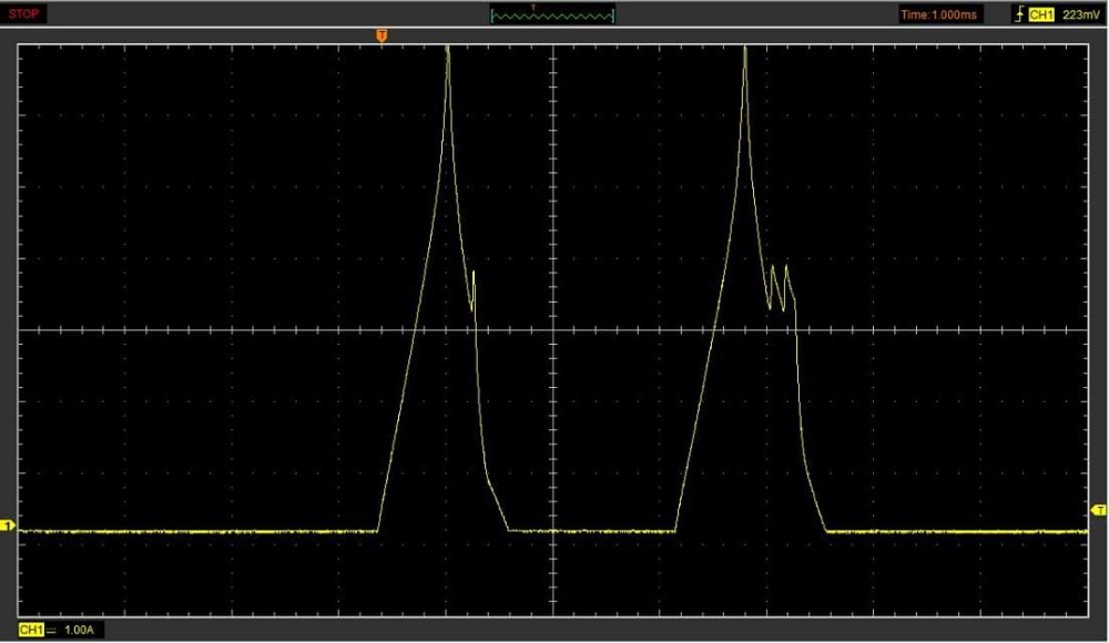

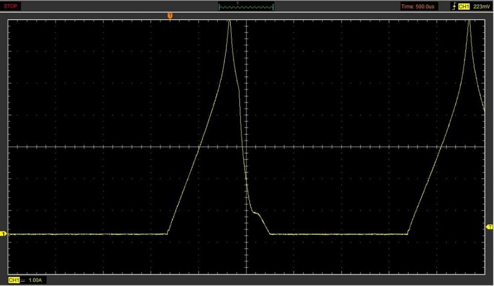

8 years 1 month ago #22930 by tzviyehuda
Pd ijector was created by tzviyehuda
I would be happy to help with this pd injector one of which looks improper? High rpm
  • Landroverman1958
  • Landroverman1958's Avatar
8 years 1 month ago #22932 by Landroverman1958
Replied by Landroverman1958 on topic Pd ijector
what is your concern with the injector/wave pattern?

  • tzviyehuda
  • tzviyehuda's Avatar Topic Author
8 years 1 month ago #22938 by tzviyehuda
Replied by tzviyehuda on topic Pd ijector
One of which is malfunctioning and causing a little misfire at a certain rpm.

8 years 1 month ago #22939 by Landroverman1958
The one waveform looks somewhat normal,what vehicle/engine is it from?usually the wiring loom is the problem,wiring goes hard n brittle inside the head,the fix is to replace the in side injector harness,

  • tzviyehuda
8 years 1 month ago #22958 by tzviyehuda
Dpender td5. The wires were replaced.

  • tzviyehuda
8 years 1 month ago #22994 by tzviyehuda
Yes I took it in ECU. It happens around 2500 RPM I hope that today I will do more tests and bring it up here

  • Landroverman1958
8 years 1 month ago #22996 by Landroverman1958
You will have to find if its an electrical misfire or a hydraulic misfire,the ecu,s do suffer with oil intrusion by the engine oil running down the engine harness into the ecu connectors/ecu they fill up with oil causing the ecu to short internally,its a very common issue.
