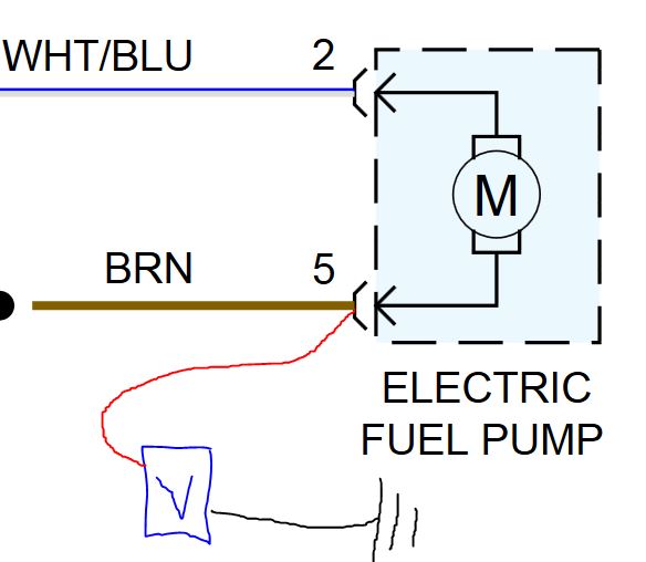

Pole71 I backed pin the white/blue and brown wires at the fuel pump connector.
8 years 2 months ago #22524 by Chad
Replied by Chad on topic 09 Mini Cooper S No start with crank
To make sure I understand....
1. The pump does NOT get power, and does NOT run for a couple seconds of prime when the key is turned to the "ON" position.
2. If you give power to the WHT/BLU wire with a power probe, the pump runs.
3. Cranking the engine, you have power on the WHT/BLU wire, and a good ground on the BRN wire but, the pump does not run.
Is this correct?
  • Bchez71
  • Bchez71's Avatar Topic Author
8 years 2 months ago #22525 by Bchez71
Replied by Bchez71 on topic 09 Mini Cooper S No start with crank
Pole71...Yes this is all correct.
8 years 2 months ago #22526 by Chad
When you crank the engine and have power on the WHT/BLU wire, is this measured with the connector connected?
I am curious of the voltage on BOTH wires.
With the connector connected, engine cranking,...What voltage do you read on the WHT/BLU wire? What voltage do you read on the BRN wire, while cranking?

Pole71... I got 127.5 milivolts while cranking engine. Not sure if I did that right??? I had my ohm meter attached to the ground side of the plug and grounded to the body. Then I disconnected the negative terminal from the battery and hooked it straight up to the plug in line with ohm meter and I was getting 5.7 - 16. Does this sound right? I’m thinking I have a messed up ground somewhere
8 years 2 months ago - 8 years 2 months ago #22536 by Chad
Leave the battery connected. Set your meter to Volts DC. Connect the negative test-lead to a GOOD ground.
Then, back-probe the power side of the fuel pump connector (WHT/BLU) with the positive lead of the meter. CRANK the engine and read the voltage.
Now, move the Back-Probe/positive test-lead to the GROUND side (BRN) of the fuel pump connector, leaving the negative test-lead connected to a good ground. CRANK the engine and read the voltage.
Last edit: 8 years 2 months ago by Chad.
8 years 2 months ago #22537 by Chad
Just to be clear, make sure you are doing this test with the fuel pump connector CONNECTED to the fuel pump.
  • Bchez71
8 years 2 months ago #22542 by Bchez71

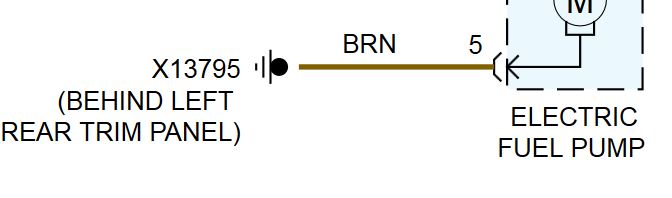

Hello Pole71. Ok I got 10.9 volts on the positive side and 3.0 on the negative. Thanks for explaining to me how to properly check it. I was using the ground on the actual pump connector. Dee da dee
8 years 2 months ago - 8 years 2 months ago #22543 by Chad
3 volts on a ground wire is not good. You have a bad ground. Check the BRN wire and connections for corrosion, rust, cuts, etc.
You can use a jumper wire (or PowerProbe) to provide a temporary GOOD ground for testing purposes to confirm.
