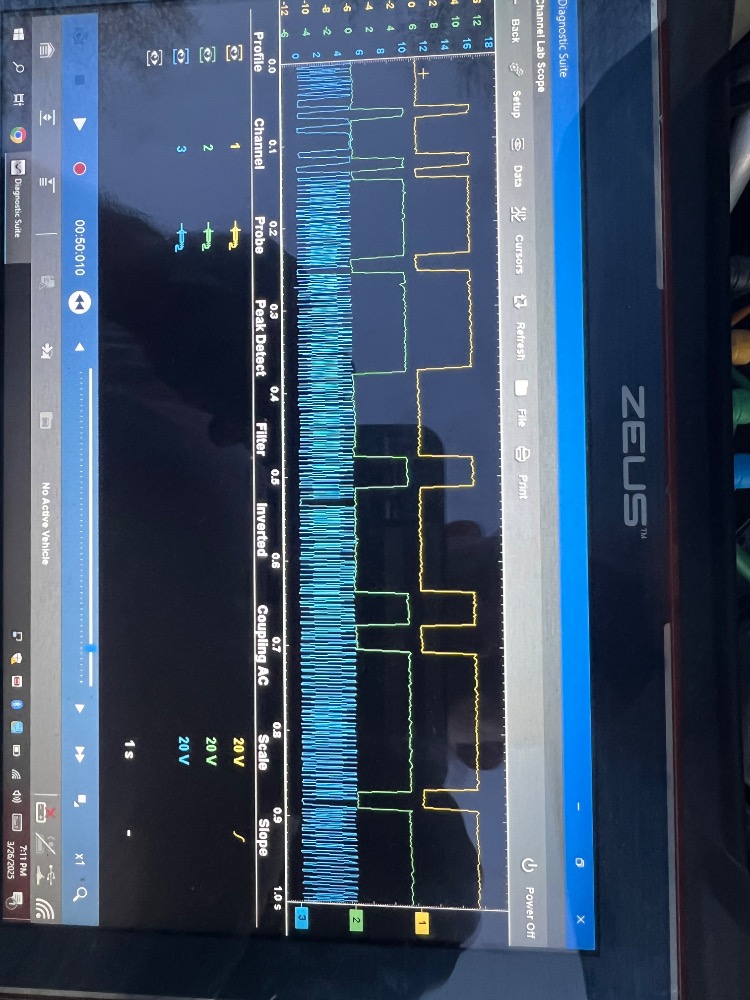

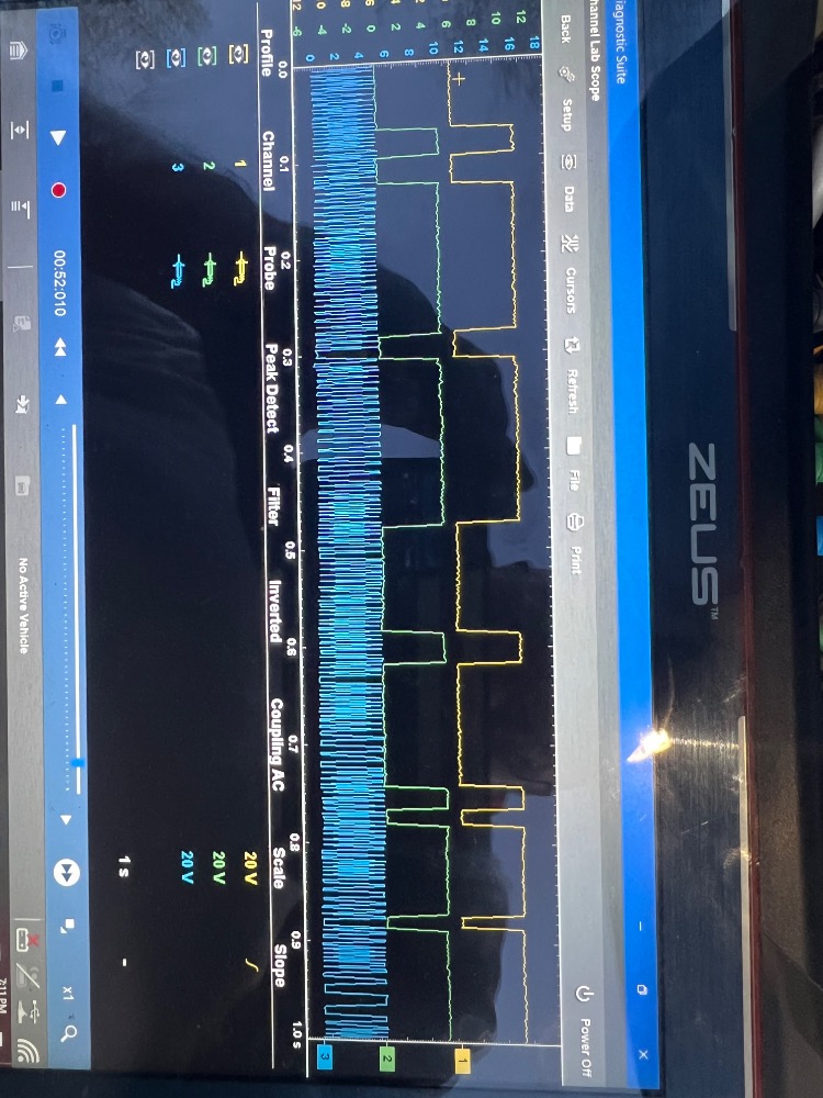

2012 Acadia in my bay now. Worked on by owner and Seen other techs for crank no start and crank stall conditions. I know it has recently got new throttle body, MAF, CKP sensor and HPFP. Not sure what else has been done recently. Initially had crank no start and I found low pressure fuel sensor dropped from 72 psi to 52 psi when key on within 5 seconds. Fuel sending unit Waveform terrible only made out 4-5 of the pump magnets with increased amperage drowning out others. Replaced fuel sending unit now cranks stalls within seconds at times. Checked cam crank timing. Intake bank 1&2 perfectly aligned. Crank waveform not consistent on scope. Verified continuity from ECM to CKP sensor. I’m new to scopes but leaning towards bad reluctor on crank. Initial CKP was a spike every 10th/second. (During crank no start) Then decent CKP with variable signals resulting in crank stall conditions. Sorry no video but here are some pics of scope.

Setting any codes?
I think the 1 second time base on the scope is too much time to be able to judge the CKP signal.
Will it run with the CKP disconnected?

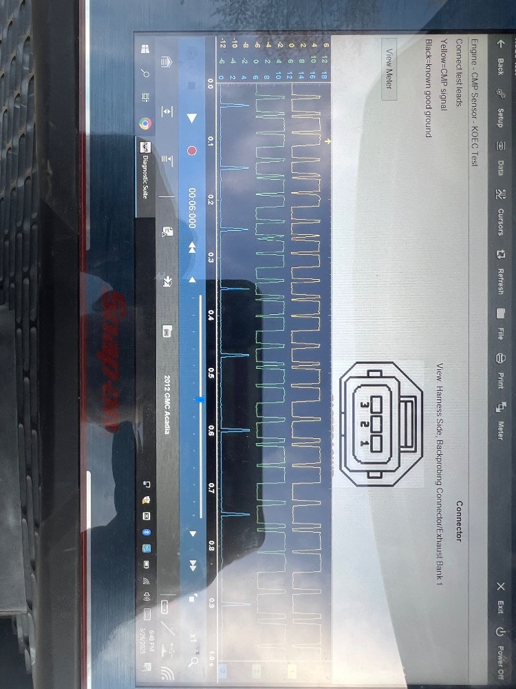

I’m going to have to cut my losses on this one. I’m seriously leaning towards ECM, but not confident enough to make that call. Decided to look at cam crank again with lab scope again since I had an anomaly the first time with crank waveform. Had something really strange happen. At one point crank had no voltage at all even while cranking. Few minutes later cooling fan kicks on randomly. Then notice bank 2 intake signal wire has 5v and key was out of ignition on dash (it doesn’t have push button).
faulty ECM is my only guess at this point. My issue is I have so much difficulty reproducing the problems to convince myself to replace the part. Time to take an L on it.
