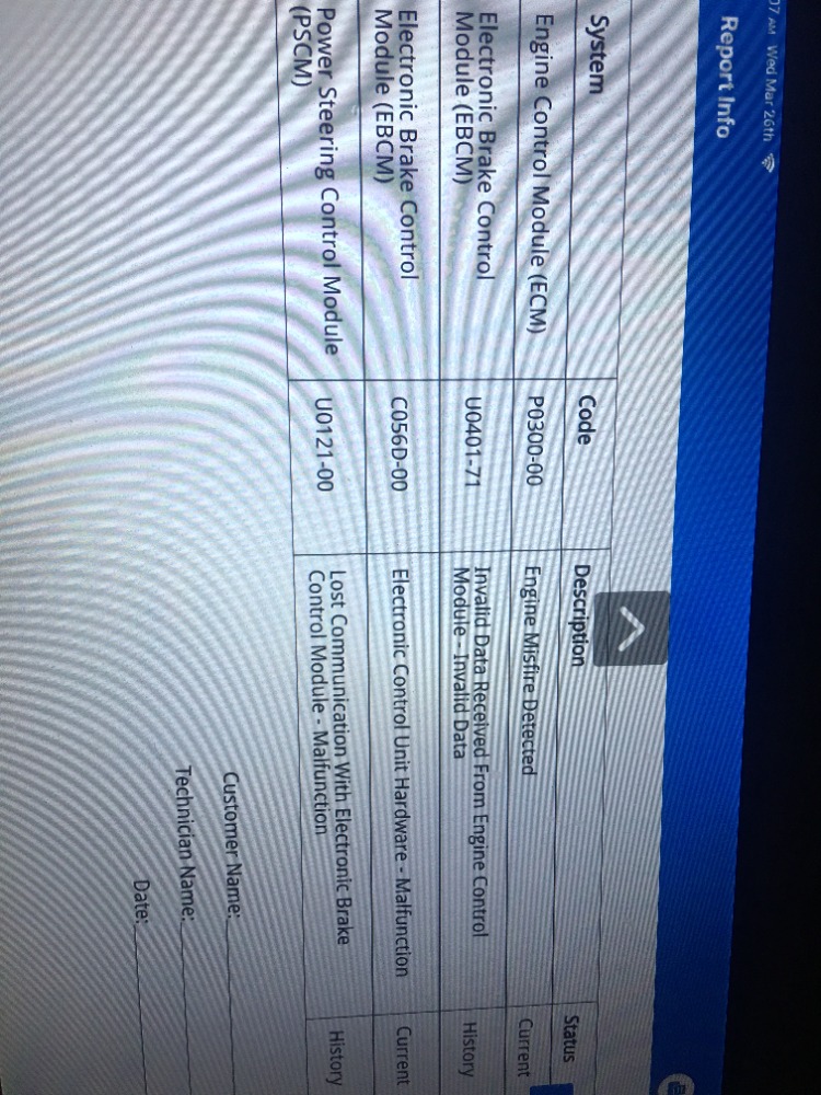

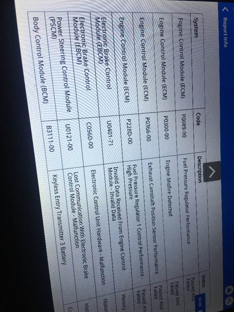

Morning group,
I have read the other post in the forum about a next 12' Equinox with similar issue, I inherited a Equinox that had codes for exhaust camshaft actuator, Fuel pressure regulator proformance and misfire errors.I took the vehicle on a test drive and it would drive resonably well for about ten to fifteen minutes and it would start to surge and stall but if you put it in nueutral or restart it would start up no issue until time pass again. While logging the data stream , the low fuel pressure would be steady at 45 to 58 psi while acting but the HPFP would max at 2000 0r 2100 psi at the time car would stall but as I stated it would be normal after restart.
The previous technician changed timing chain , non OEM cam phazers and also an oil change
I replaced the HPFP , ECU and O2 sensor lower and now the fuel trims are in operational range but the vehicle still stalls . The timing was checked an found to be correct
Pictures attached
Pictures attached
