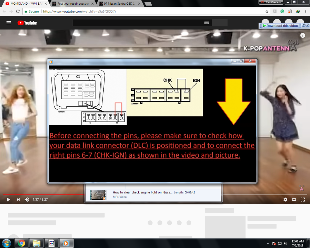

Good day guys, everyone know how to pull a code on the Nissan Sentra ?
Thank you in advane, More Power

It should feature a 14 pin so called DDL connecter for a scan tool right next to the fuse box.

What juergen said. If it's a US model, it'll have a regular 16-pin Data Link Connector, too. You can get Global codes and data out of the DLC, but that generation of Sentra really prefers to talk through the DDL.

Thanks for reply. is this Correct?
i have a photo below

Yes, this is the DDL connecter.

i have a problem, crank no start, have spark, have injector pulse but injetor pulse fire the same, all of injector fire.

Don't worry about the simultaneous pulses, it's just an ecm strategy for starting.
