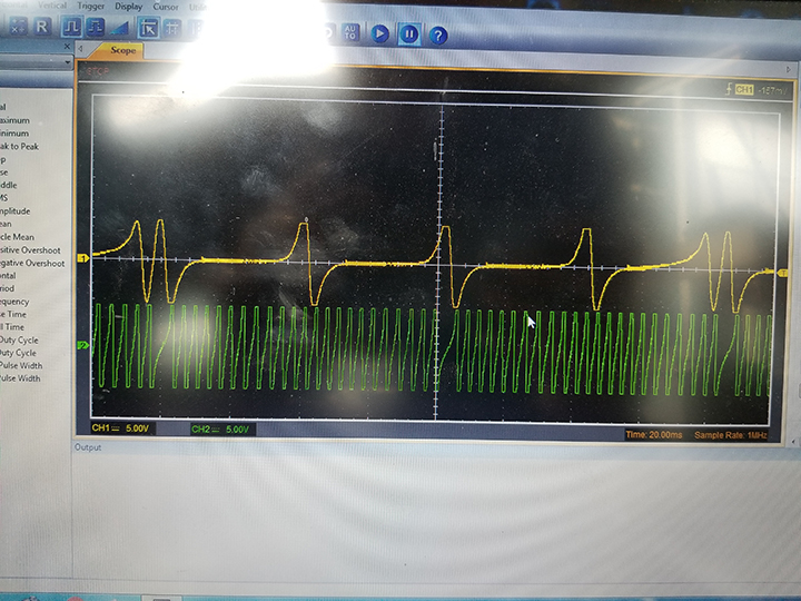

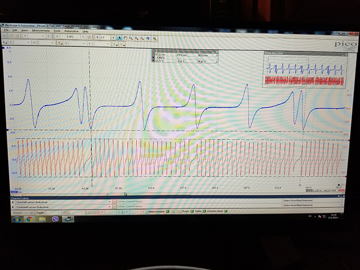

Hello guys !
This is my first post here , so i hope it's not so rude to ask for help directly ...
So the car is Nissan X-trail ( T30 model ) with 2.2 Di 114 hp engine 2002 year . Probably made only for Europe
It has problem with really hard starting , cold , hot , doesn't matter , every time .

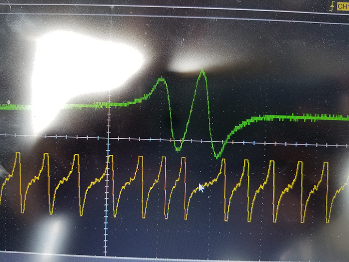

After the start up everything is fine , good amount of power , smooth running engine , no black smoke etc. Ofc there is no fault codes stored in the ECU . I readed the live data while the car is cranking and there is rpm reading and fuel pressure . The owner already has change the timing chains , crank and cam sensor , the high fuel pressure pump valves , the fuel pressure sensor on the rail ( actually not 100% what the hole history of the repairs , several shops worked on this car ) . I checked the wiring to the ecu of the cam and crank sensor and its OK . But i'm starting to think there is something wrong with the timing chains cuz he told me , when they change it some parts left from the kit , cuz there were not for this car , the camshaft sprocket gear were different ... If someone can provide crank cam waveform for this engine ( both sensors are inductive ) , i will be greatly thankful .
And one more question , is it matter on an inductive sensor , 2 wire sensor , if you rotate the wires ? Wire 1 goes to pin 2 , and wire 2 goes to pin 1 .

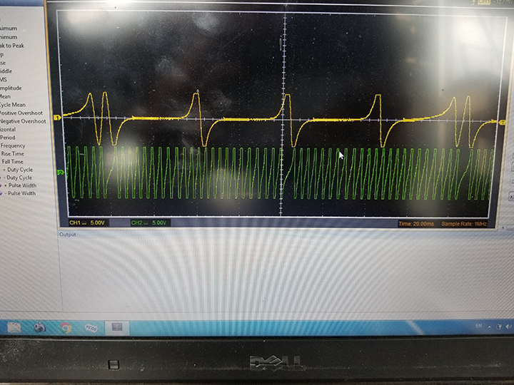

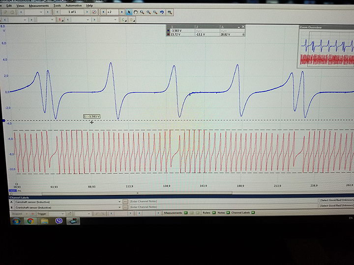

The leak-back fuel on the injectors are under the valve cover , like D4D engines on Toyota . Out of the valve cover goes out one main house which is for the leak-back fuel . So i decided to block it with pliers and ... no effect . Interesting fact is that while the car is cranking there is almost no activity on the rpm tacho . When the tacho start to move the car starts . But it takes some time this to happen .. Thats why i want to check the cam crank waveform .

8 years 3 months ago #21636
by r3s1s74nc3
Replied by r3s1s74nc3 on topic Nissan X-trail 2.2 Di Hard start
