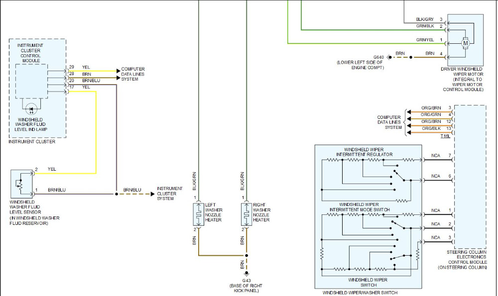

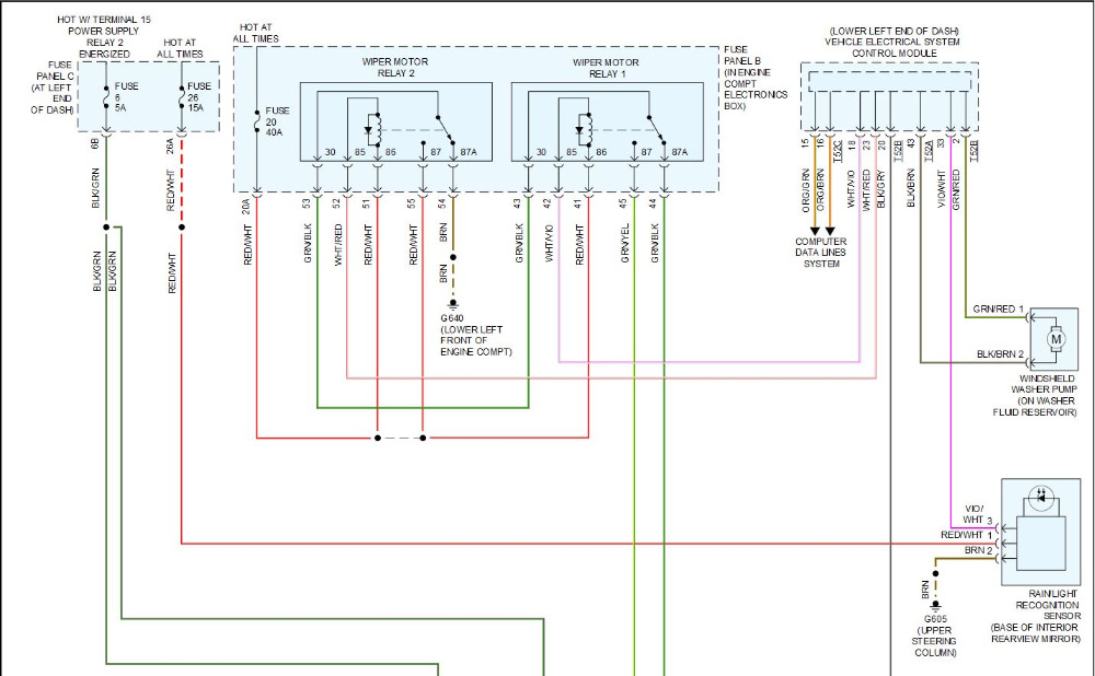

Hey guys I'm looking for some info / maybe a diagram for this car the windshield wipers work fine in all speeds but when you pull the stalk to spray the windshield it does not spray and wipers do not run (leads me to believe it's a faulty stock ) but without any info to verify I don't want to tear the column apart to find out it's not! So if anyone has wiring diagrams for this car please post them! Also if you have a fuse box diagram that would be great too as the owners manual did not include it.....

Hi Ben, If you can post a picture of the PR sticker (whiter sticker in boot or service book) I can get you the factory diagram.

8 years 4 months ago - 8 years 4 months ago #21625 by Chad
Last edit: 8 years 4 months ago by Chad.
  • Ben
  • Ben's Avatar Topic Author
8 years 3 months ago #21708 by Ben
Thanks pole I just logged on through the website and see you posted the diagram the tapatalk app doesn't show me anything .....

Do you also have the fuse box diagrams?

I had tested the washer pump ,the wipers don't run when wash is pulled either .
  • Ben
8 years 2 months ago #22749 by Ben
Well that's not it. I had time to hook up my VAG COM today and the steering wheel module is not seeing a signal to run washers so it looks like it needs a new turn signal/washer switch. Funny though while I was in there I opened and closed hood and got no bonnet open message but checked instrument cluster module and seen the module is receiving hood open and closed signal

I suspect its missing a switch input then into the module,can you do a bypass test from the wiper swich,on the washer circuit,using a test lamp fooling the module,
